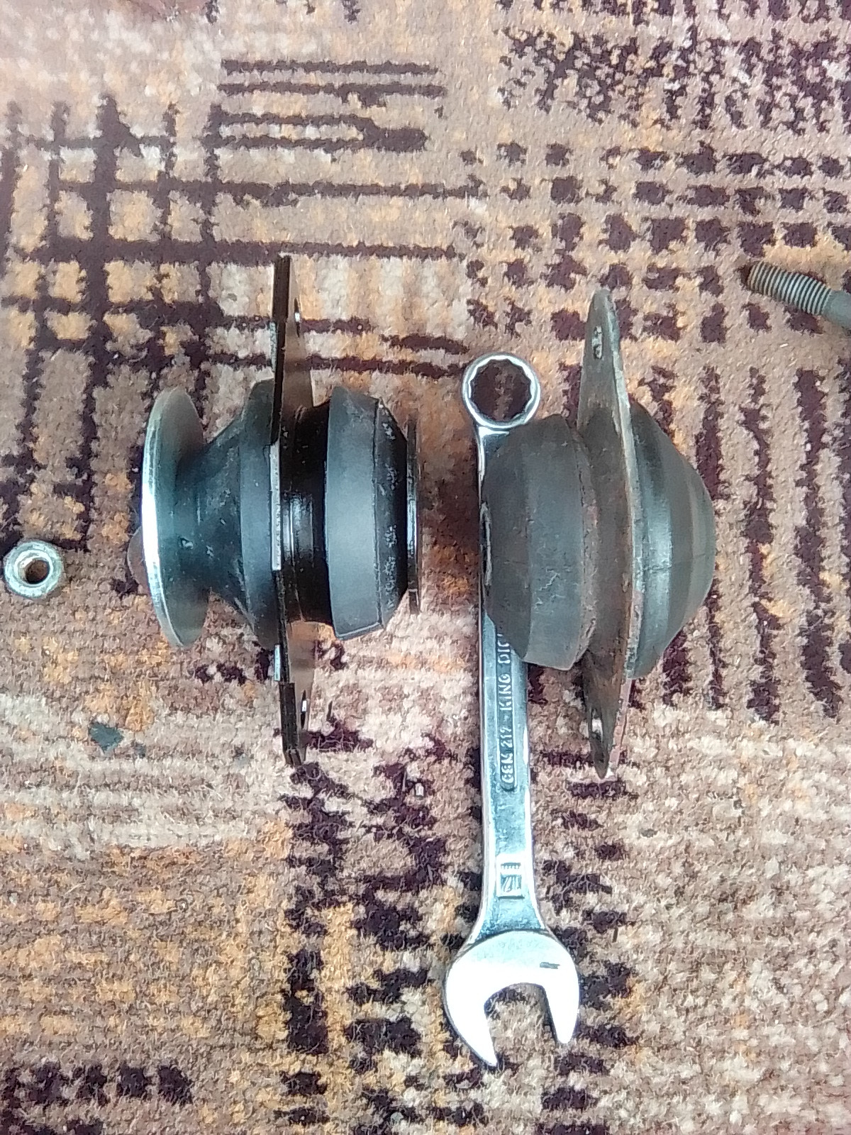

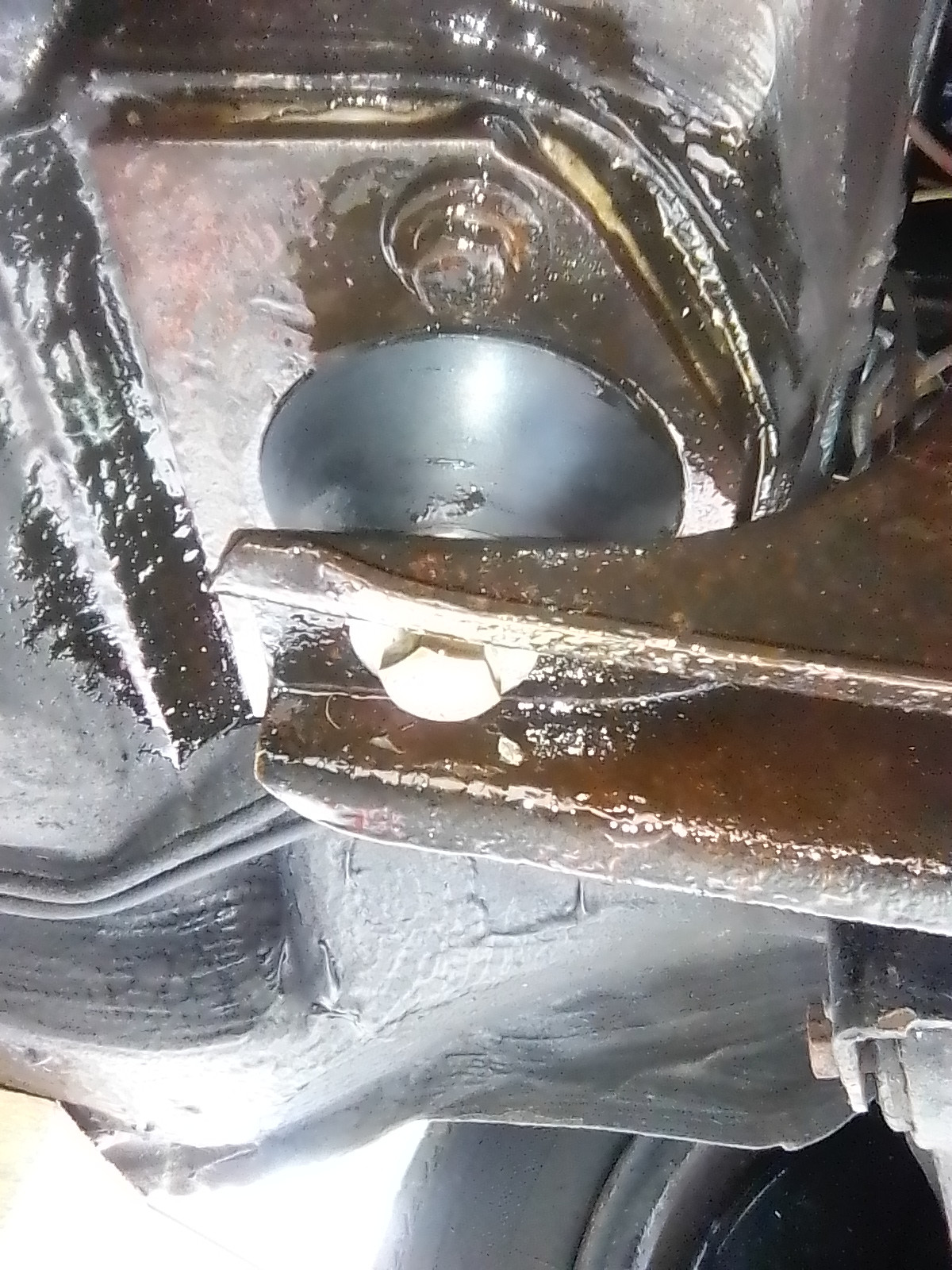

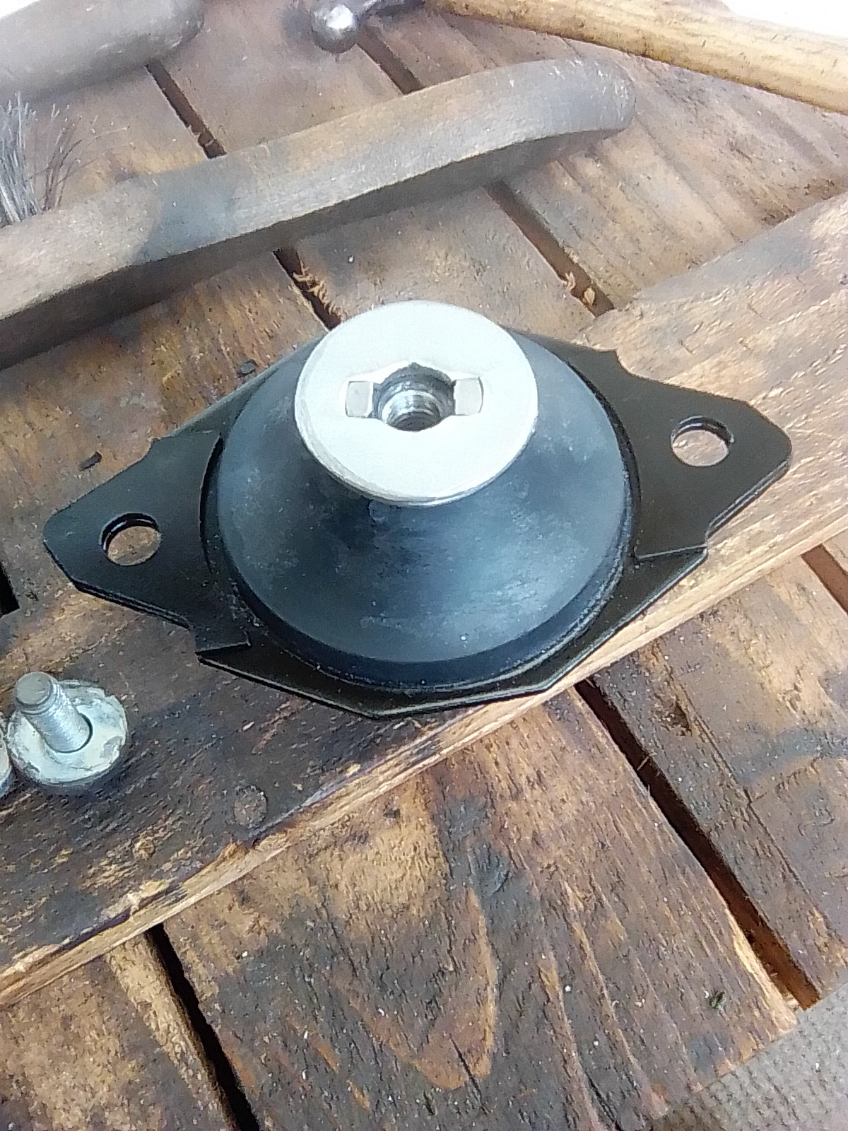

Got around to doing the G60 back engine mount swap today, it's not as straight forward as it looks. The mountings are physically the same size and length, but the big washer has to come off the bracket side. I sawed the tabs off to free it and reduced its diameter by centering a 44mm holesaw in the M10 hole. I could have done away with the tabs completely and fitted a thick penny washer, but i thought the original part may have been designed how it was for a reason, so kept the tab locking feature. Plenty of chassis wax in between all the parts to finish it off. You have to use an M10x30 bolt to secure the mount bracket, i went for A4 and threadlocked it.
See if it stops my rattle problemsIMG_20220806_135043.thumb.jpg.760d9e012c8fa26c56de36d1cdd093b8.jpg
It's a good upgrade, i can tell it's stiffer by the extra vibration through the floorpan. The exhaust still rattles a bit under full gas in first though, that'll be the cheap pattern system.
