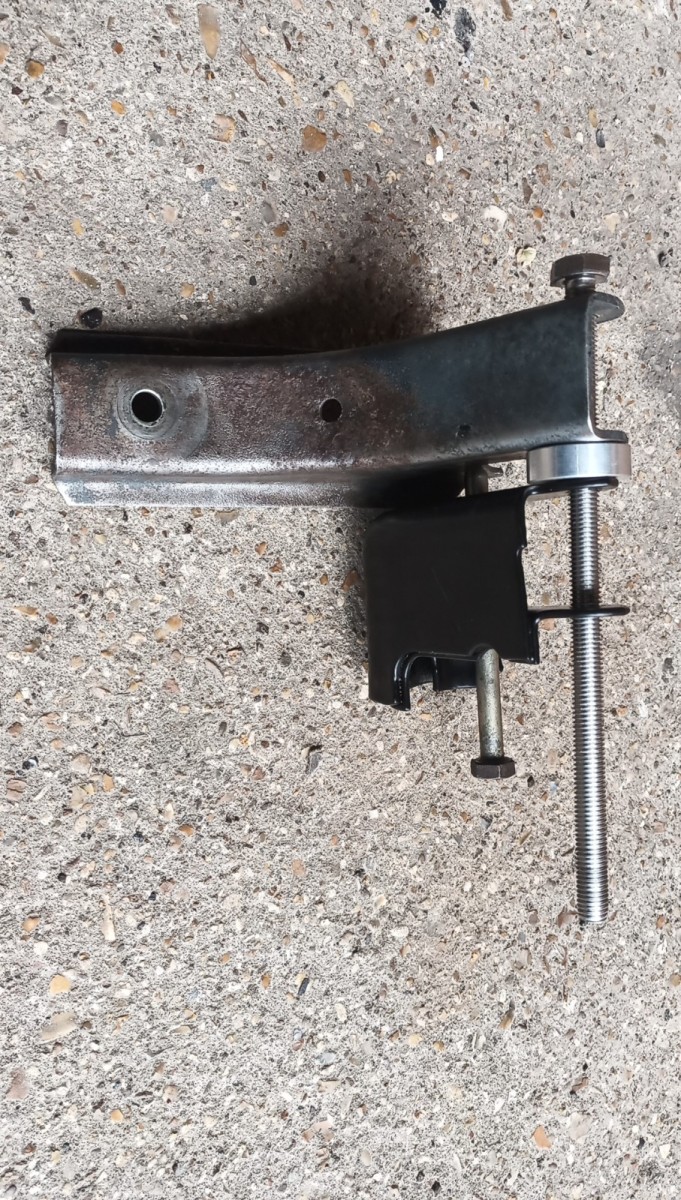

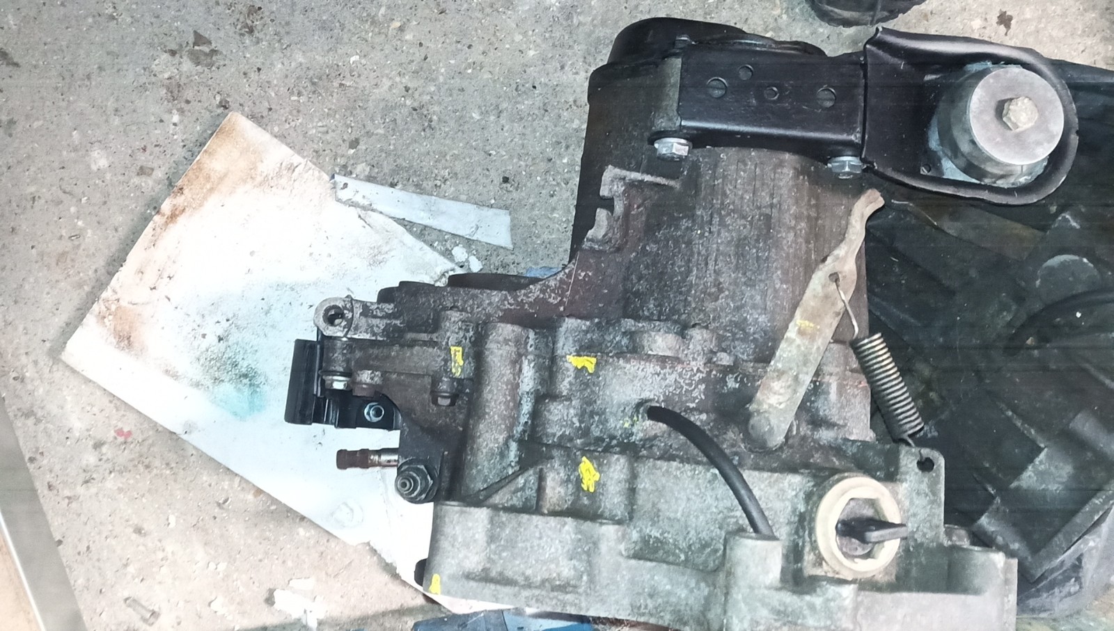

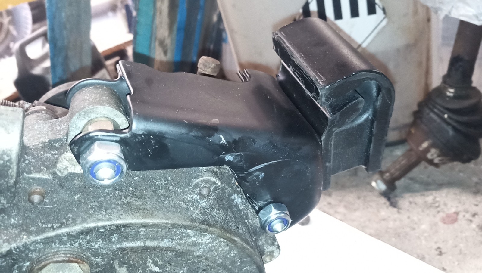

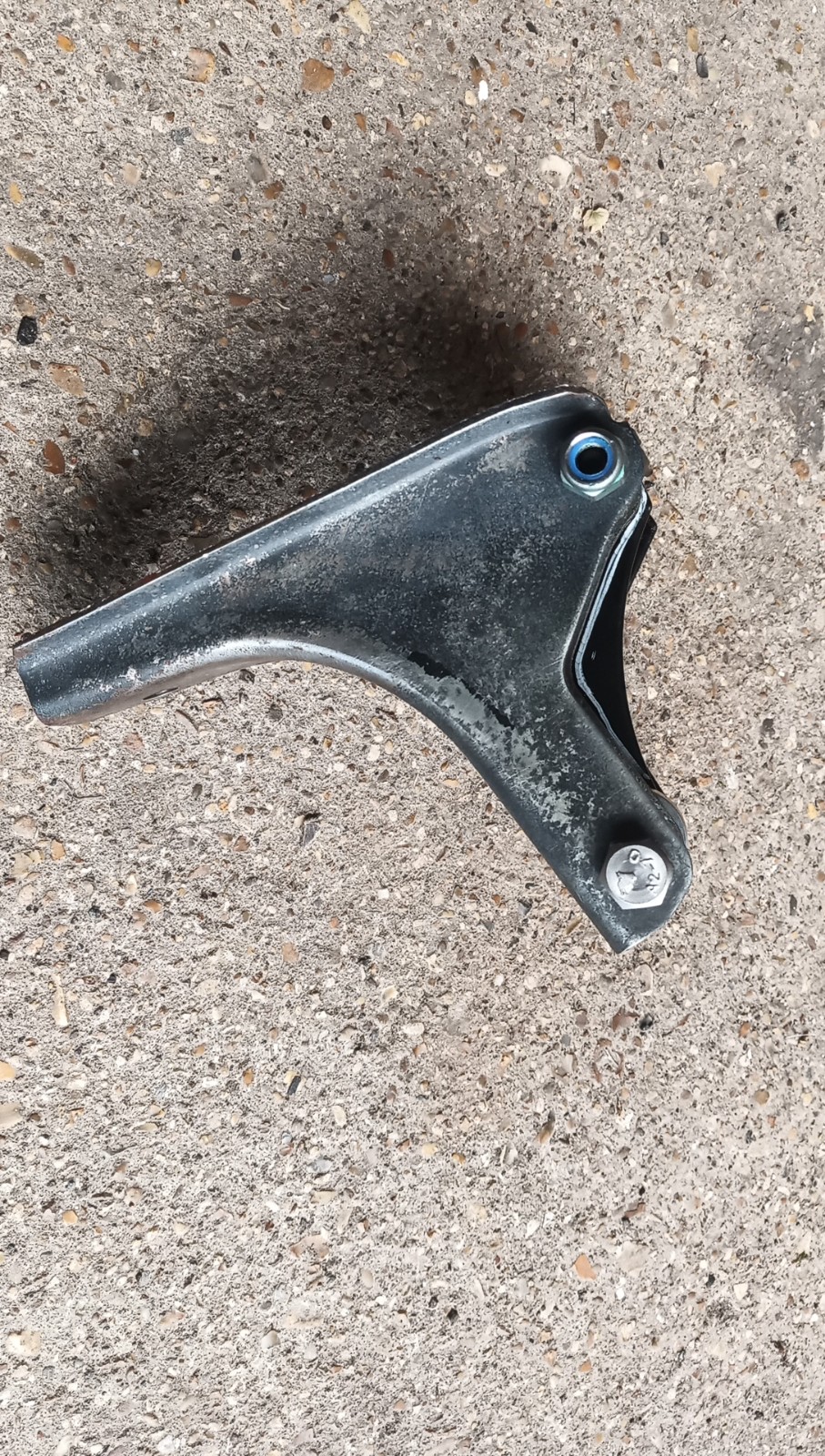

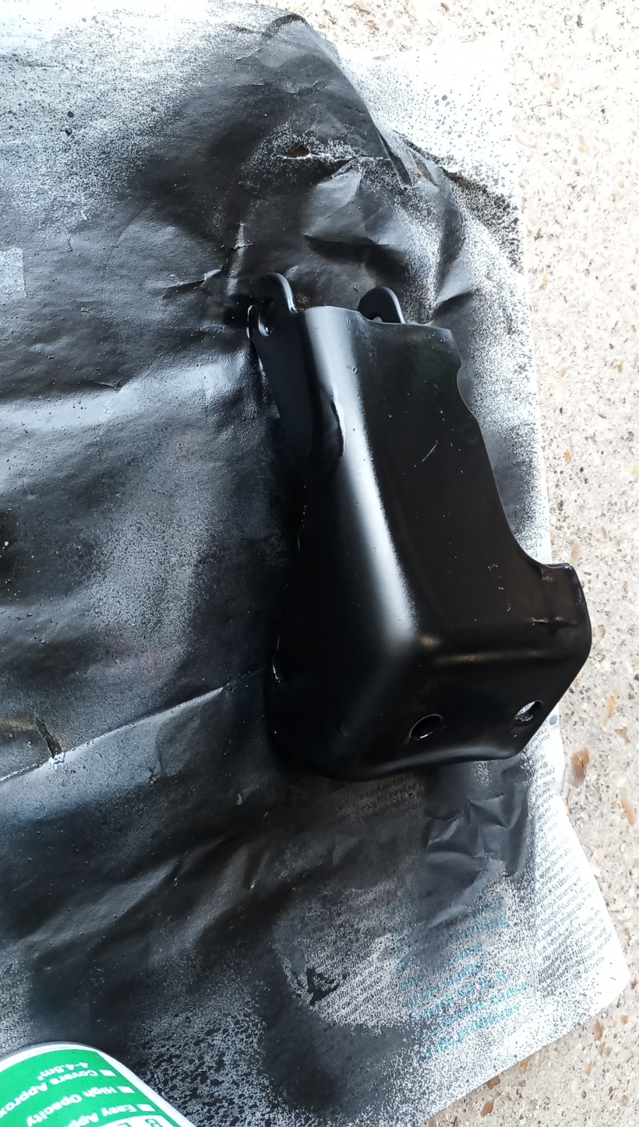

Chose a Golf mk1 lower mount, because a Polo mount is attached from above, while this means I can support from below with an M10 locking nut and a sloped support piece.
Needed a bit of chopping to fit.IMG_20220807_120726_8.thumb.jpg.3eb3e9ffb51bd6775151361008181cb6.jpgIMG_20220807_120740_5.thumb.jpg.5b22482bf682ec71da12e04977c92953.jpgIMG_20220807_151742_0.thumb.jpg.5a7dcc1370a8eb0f63af8d9a367a1457.jpgIMG_20220807_154332_5.thumb.jpg.9d191975a782759c25f630bff8a513ce.jpg

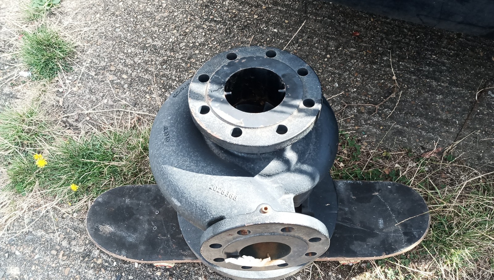

Got a farm water pump. It ran off an 18.5kW/25hp electric motor at 2900rpm.
Just the small matters of the water flanges, mounting it for the plumbing and a shaft to pulley drive conversion with a tensioning mechanism. One drive shaft option is V belt driving centrifugal clutch on a 1" keyway shaft with a bearing.
