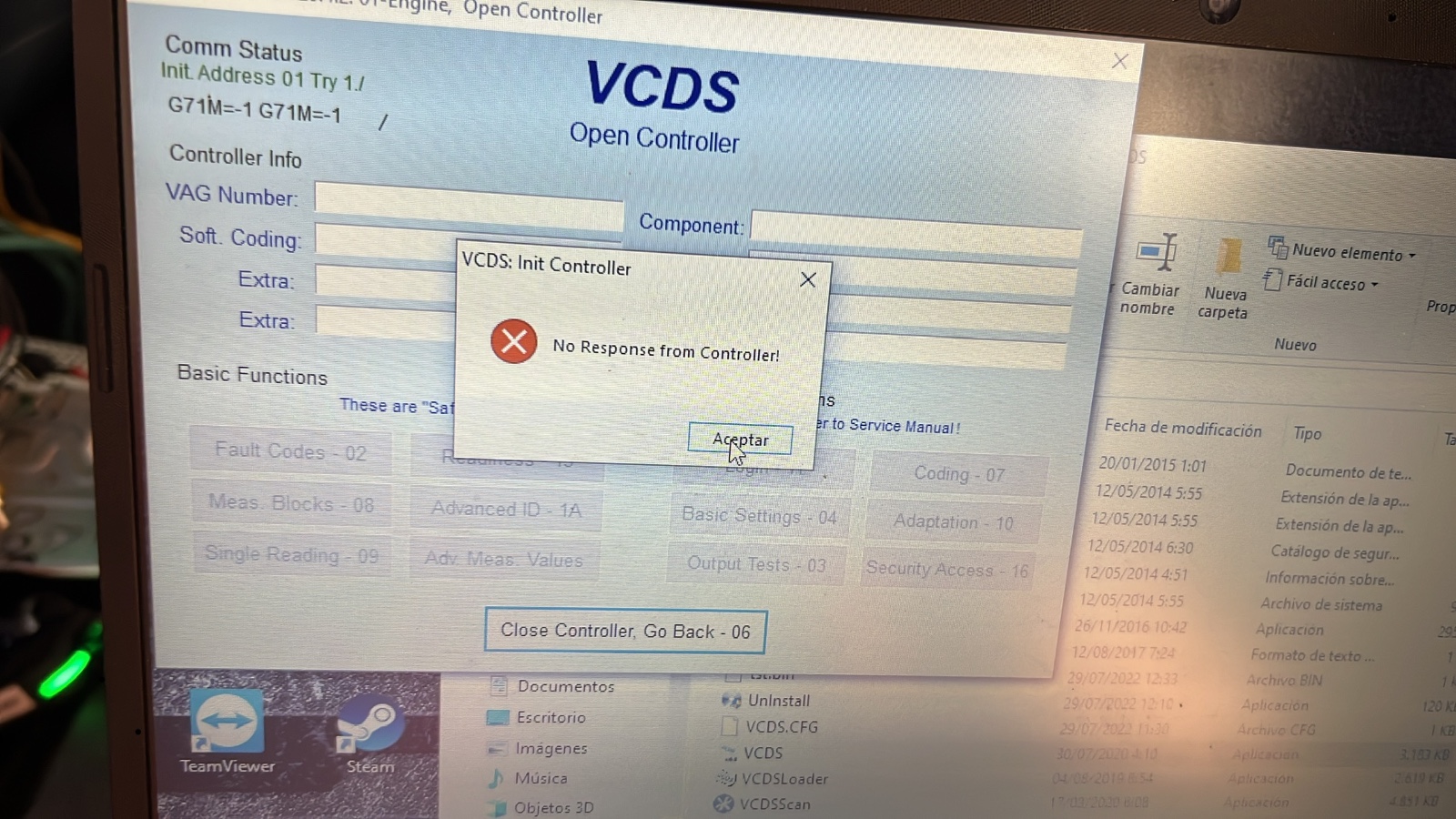

well, for a few days it has been impossible for me to connect to the car via obd, with cables that used to work.  i have tried with a kkl cable with versions 311 and 409, i have tried a clone of a hex-v2 that works perfectly on my passat b7.
and the only thing I get is that when entering any module the automatic headlight levelers start to work but I always get the same error, in any module “Not response from controler”
every time I scan modules such as the airbag or abs or engine, the lights flash on the panel but nothing else happens.
I have tried almost everything I saw on the internet and in no case did it work for me, I have read almost all the posts I see with similar problems and I can't find anything...

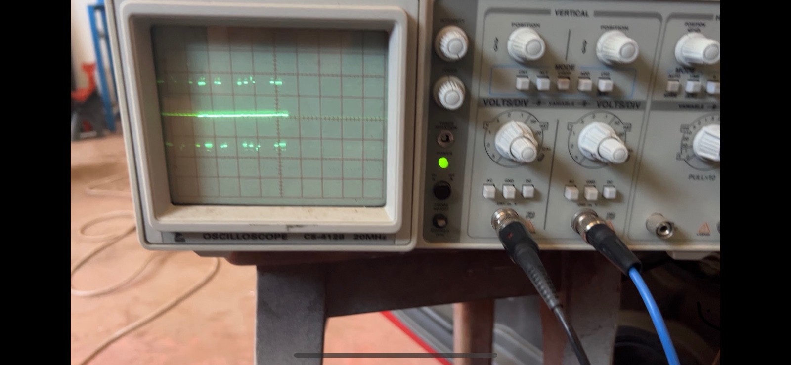

- I have verified with an oscilloscope that between pins 19 and 20 there are positive and negative voltage signals when making contact, but I do not understand this much nor do I know how to use an oscilloscope
