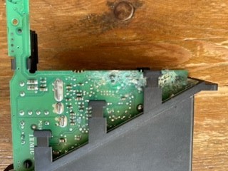

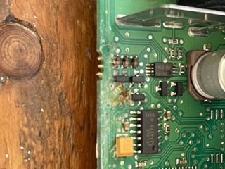

This came up in another thread, and the poster agreed to let me put the photos up on his behalf.
It's not directly related to the 9N3 window motor thread - those have different part numbers beginning 6Y, and different connector and wiring arrangements; so I thought it better to start a new one on his behalf.
The pics:
pic1.jpg.521bd067724df8d56ff334f497397438.jpgPic2.jpg.b24a88063853a2fc221a749e9f4edb48.jpgPic3.jpg.4a28f4d2659bb95290dce4075ab31ad8.jpgPic4.jpg.36ea7e283c56ecb30e1e0e024f9f437c.jpg
I don't think it's worth trying to resurrect this module, spares should be readily available.
Although the plastic circuit board housing has a seal around its perimeter, the loom connectors don't have any waterproofing measures as far as I remember, so any wetness coming down the wires may well end up inside the housing, I think.
The only thing I would suggest is worth particular attention, is trying to clean any corrosion off the loom connector inserts that correspond to and mate with the 'greened' pins in the first picture.
