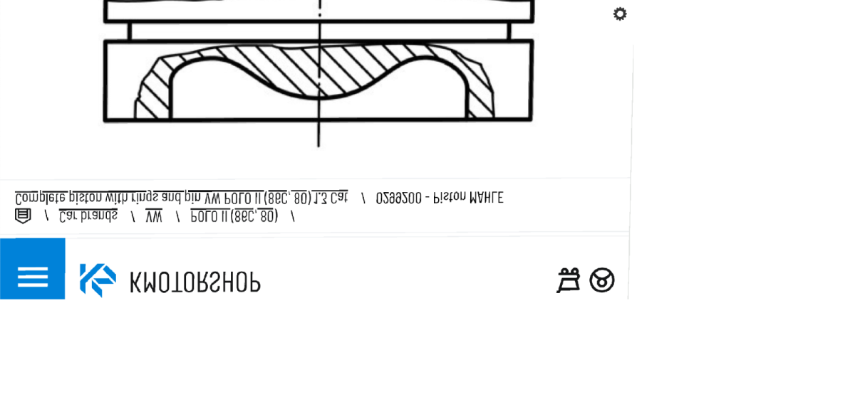

  • Spacer and gaskets of 4.15mm would be a cylinder of 18.33cm3 +21.9cm3 in the bowl gives 40.23cm3.   318/40.23 = 7.9: static CR   Plug that into Wallace calculator and you are at 12
