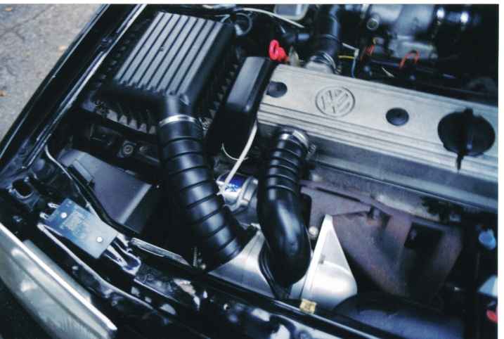

Recently i've noticed that my car wasor seemed to be pulling badly.The boost
pressure was dropping and since it's been 3 years since i have had my charger
serviced....i was fearing the worst.So i came home from work yesterday and
checked for a boost leak before i hauled the charger out and found a tiny pin hole
in the pipe at the back of my boost gauge.So i cut the pipe,re-joined it and fitted
a brand new air filter :shock: what a difference it's made.
Took the car out for a run through to Edinburgh and back this morning and WOW,the
car is boosting higher than i can remember and seems to be idling a lot better too.
