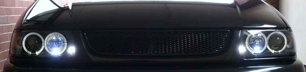

i agree with Tej as i also have had HIDs for 2 years behind some FK 2 PIECE (original) Black Angeleyes and they have worked fine. I have LEDs surrounding the projector housing and they have lasted 2years too.,.. as you may know LEDs dont like HEAT as they start to fail and flicker... so far (touch wood) mine are fine.. the BALLASTS get hot true, but the bulbs wont get as hot... get yourself a good quality kit... i paid £160 for mine... but u should pay for quality as the ballasts transofrm UP to 20,000 VOLTS... UNDER YOUR CAR BONNET... would you want rain water to seep thru the cheap connectors and mate with 20,000 V?
HIDs are the way forward though...
