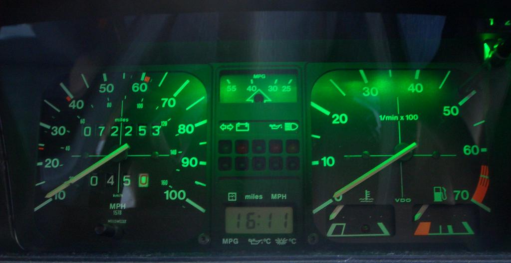

On my mk2 I did the same thing as I did on the mk3, only this time I used green LEDs instead of blue. (seemed to make more sense to keep it green on this car)
Not got round to sorting the LCD display. Will do with the rocco clocks though.
Much brighter at night than standard (this pic was taken during the day)
