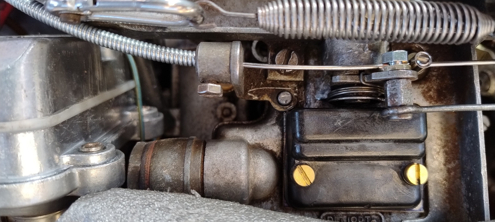

new choke cable fitted. It has a solid core so no strands to fray. I did have to drill the bolt wider to 2mm hole. -

yeah, the only way to do that is spin a nut all the way on to the bolt, file a flat in one side of the bolt, drill it with a pillar drill and spin the nut off, hoping it does enough to the thread that you can run a die back the other way. Or buy the right bolt 😁 Also, vegetable oil sounds a bit posh, it's been on 50% used engine oil all last week. -

And the choke cable... turns out the bolt and 2 odd sized washers I've used for years is wrong. (one can usually start from cold with accelerator pedal pumps between cranking tries... but that takes several to many attempts, not good idea with drained battery and price of petrol. Hm, I suppose I could spray EasyStart down the 4 joined vacuum ports straight into the inlet runners.) There should be a hole across the bolt that you put the choke cable through. Then you tighten down into a threaded hex piece clamping it all securely, no tendency to pull tangentially and loosen. Don't think I can accurately drill across an M4 bolt by hand. So, Dellorto part 7062 on the way from Eurocarb. -
