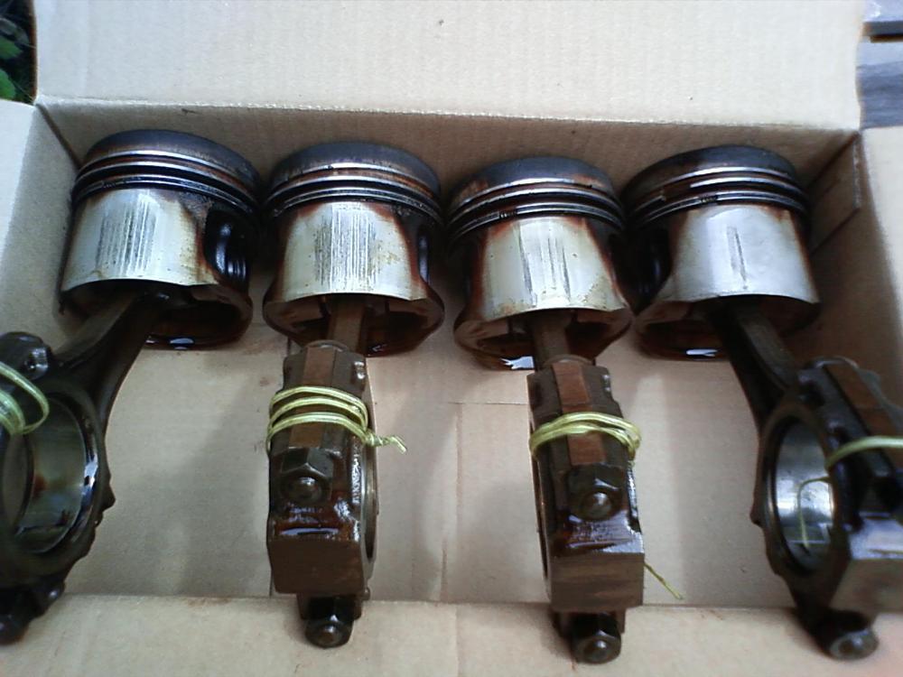

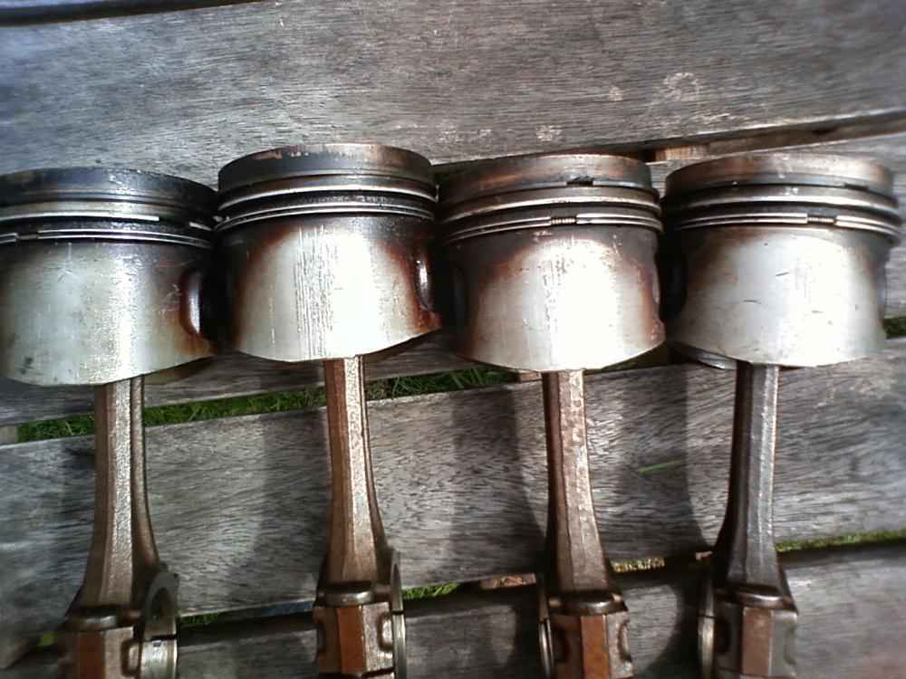

GK pistons, piston number is loops of green cable tie.
Here's pics of the dark side of the pistons, light side have no scratches.
Number #3 is worst.
post-3301-0-19677000-1438432651_thumb.jp
And here's the used "G40" pistons that I think are HK so you can see the wear. The order is a guess
post-3301-0-80245300-1438432673_thumb.jp

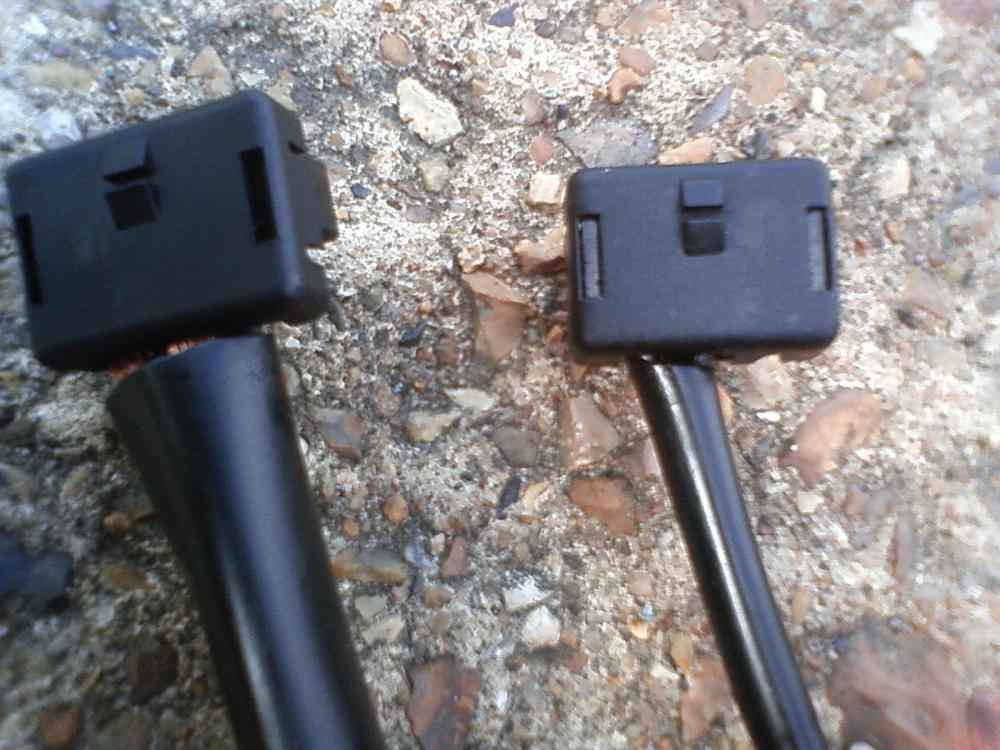

This is the old versus new plug.
post-3301-0-08694300-1439046361_thumb.jp

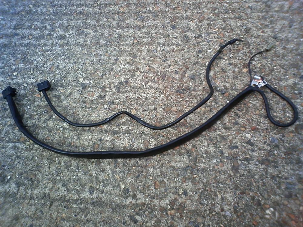

This is the two cables to compare.
post-3301-0-65056600-1439046374_thumb.jp
