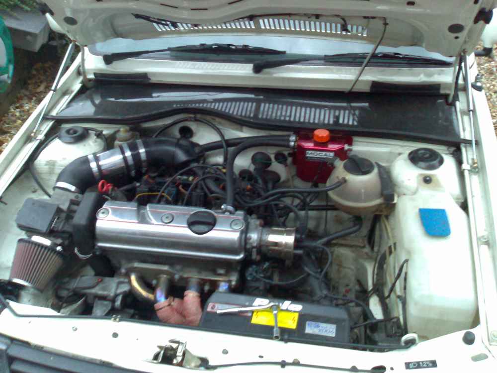

Crankcase breather in, then vent to air via a mini-filter (for your health and for the MOT)
It fills up depending on the air temperature and other stuff - short journeys in winter will fill it up quicker than in summer, as it catches the expulsed condensation in the engine.

so would it not be better to have it near the grill so its colder and condenses more?
I have mine coming from crankcase to catch tank back to air filter housing
That way under the bonet doesnt fill with fumes and get sucked into my air vents
^^ good point :D
