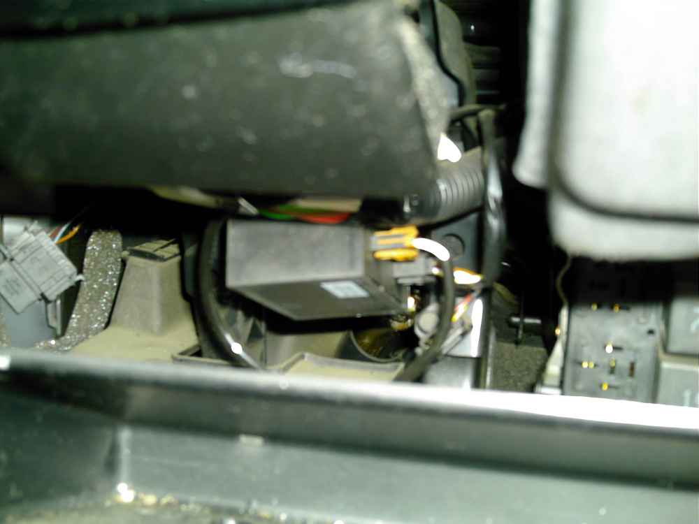

Here are some pictures of my fuse/relay box, any suggestions
p.s. apologies i was refereing to the 174 as a 147 before - must have been the snooker that was on telly the other week :D

Its not the 174 relay, 53 is I believe the fuel pump relay, VW are a bit inconsistant with allocation numbers across the range so not all cars are the same.

Boost is it definately the 53 relay i want? Cus the shop wont let me return any electrical item if it has been used.
Sorry mate I didnt look at you pictures properly last night.
What you need to do is undo the two torx screws at either end of the fuse board. You can the pull the fuse board out of the way. Behind this you will find the main relay locations. I think the fuel pump relay is the second from the left but not 100% so what you need to do is pull the relay out if its the fuel pump relay the car will cut out. None of the other relays will cause the car to stop. I think the relay may possibly have a white cap on it 167?
Hope you understand what I mean, if I was there could do the above in about 5 mins I find it hard to put into words what you need to do so. sorry if it a little unclear

Thanks boost, found the 167, behind the fuses. bought a new one & replaced but i get the feeling its not resolved the starting issue as its still struggling a little bit on startup, although i haven't tried it from a cold start yet which will be the main test, but i aint too confident.
