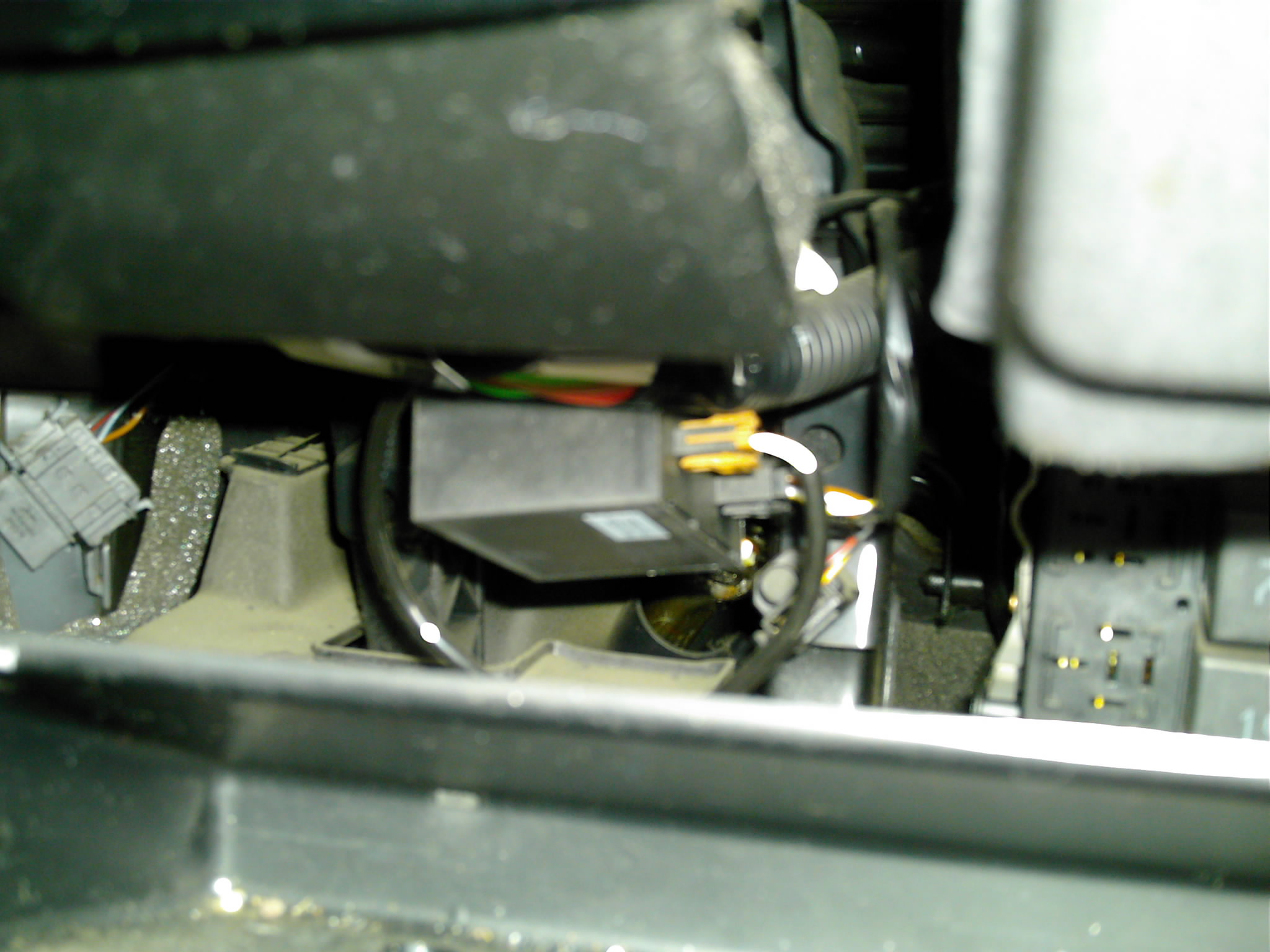

I have a 1996 polo 1.4 which sometimes used to start-up then die after a second or so. After many hours of investigation it turned out to be the immobiliser that was causing the problem.
There is a chip inside the key which when the engine fires sends a signal to the 'chip reader' which is a small black box in the fuse section directly under the steering colum. The connectors to this box become oxidated after time and need cleaned/replaced. If the chip reader cannot send a signal to the engine management system the engine will shut down. Once I cleaned these connections (by taking the connecting leads off/on several times) the problem stopped.
It sounds like you may have several problems but this may fix one of them.

Hi GaryBuz, i tried looking for this black box, but could not find it. Where exactly is it please?
I've attempted to upload a photo here so hope it works, what i'm refering too is the black box in the middle of the picture, think there are 2 wires going into it, can't remember which one to clean so try cleaning both by taking on/off or use a small screwdriver.
Garybuz, thanks for taking the picture, really appreciate it. But i still cant see it in my polo! :?
Is it fixed in that position?
