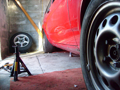

Before:
After:
If you've got any questions feel free to ask and I'll do my best to answer them. If you do it, would be good if you take step by step pictures. Its something I never did so I only really have the before and after pics. Would be good to show some step by step stuff.
