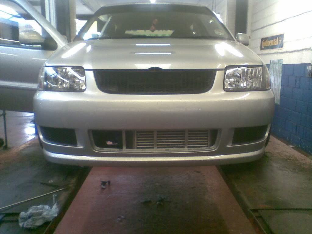

yea just up the a329m from bracknell for me. bodyshop just called and my bumper's done!
looks like i'll be fitting that up later! :-D :-D
you all done now are you??? looked kinda cool with out the bumper tho 8-)

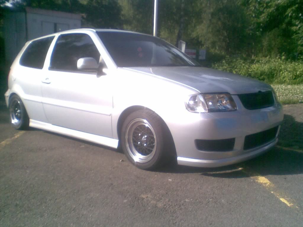

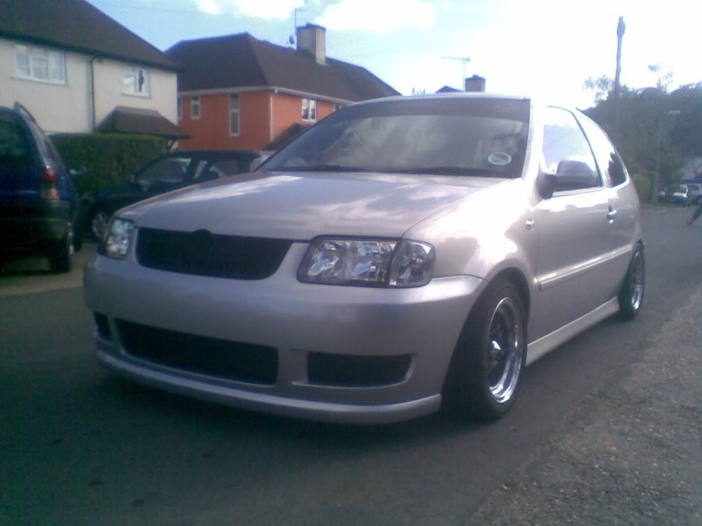

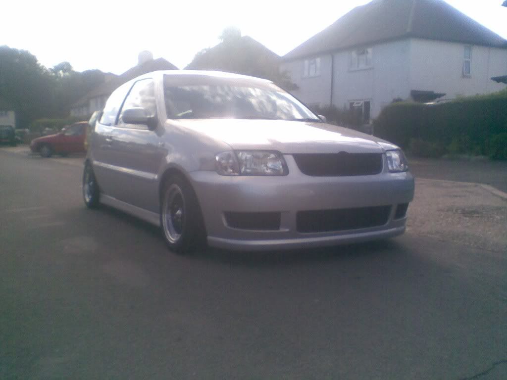

few more pic's now with front bumper.
http://s276.photobucket.com/albums/kk32/ollethalb/
:lol:8-)
haha! bring on the momo team 280!!!
that is damn cool!
that is damn cool!
cheers fella, still work in progress. gotta get the bonnet sorted and a few bits and bobs but i'm happy so far. :-D :-D
Wheels are too small imho. Always wanted to G40 my old 6n2, good work on that!
