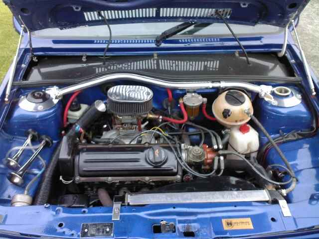

Engine - Fully rebuilt 1272 2g block with 11:1 ratio gk pistons. Ported, polished and flowed gk head, reprofiled gk camshaft, modified and smoothed inlet manifold with weber twin choke carb, red top facet fuel pump, modified electronic ignition, 4 branch manifold and full ashley sports exhaust, wolfsburg edition scuttle plaque, carbon fibre scuttle cover, polished (but now going rusty) bonnet lifters, chrome radiator cover, new style header tank and smaller mk1 golf washer bottle. 4 speed gearbox about to be replaced with gt unit. Booked in to the rolling road to be set up, hoping for around 80 bhp even though it feels alot more on the road, god bless power to weight!!

i love whats inside the engine but the outside just isnt to my taste. my 1272 with a weber made 67brake so this should fly past 80.
That's a fair comment mate, a couple of people have said the same and that's what it's all about. It will be interesting to see what it makes on the rollers and i've just finished a manifold for r6 carbs, so hopefully i can get them back in time. :thumbsup:

Chuffin crackin m8 what air filter is that?
Thankyou mate. It's a k&n off an old cvh lump i think. Took a bit of modifying but it's ok. Now have manifolds for 40's and r6 carbs so won't be on long :-D
