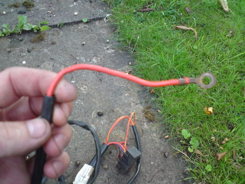

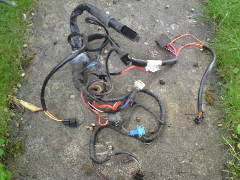

Just got all the info today on how to sort the wiring (cheers steve) and its a piece of cake to do (just a couple of wires to splice and extend for fuel pumps :)
You only need the small engine loom to get it up and running and there are 7 wires to connect.
These take the form of two 3 pin plugs and one ring terminal.
Connect the lone ring terminal with red wire direct to the battery positive terminal.

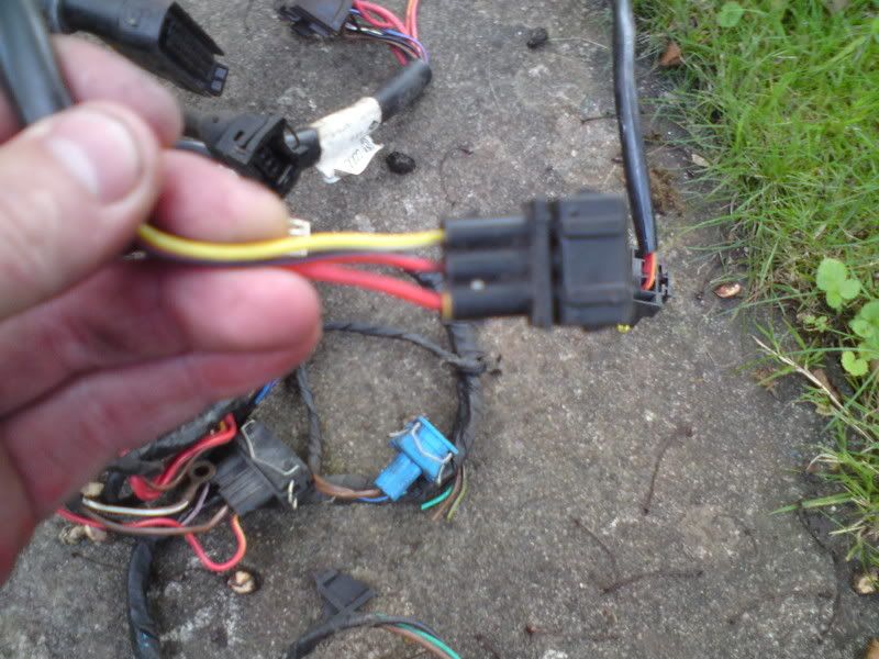

The 3 pin plug that has a red/yellow, red/black and yellow/white wire that was near the ECU on the Mk.3)
Red/yellow wire goes to the fuel pumps in the rear of the car.
Red/black wire goes to the starter motor solenoid spade terminal.
Yellow/white wire is for the diagnostic connection inside the car.

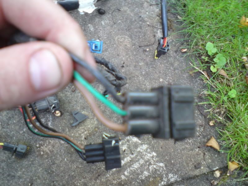

The 3 pin plug with the brown, green and black wires(was near the coil on the Mk.3)
Black wire connects to the black wire that used to connect to the + terminal of the coil on the Mk.1
The green wire connects to the red/black wire that used to connect to the - terminal of the Mk.1 coil
The brown wire connects directly to the battery earth terminal and must not be earthed through the bodywork
