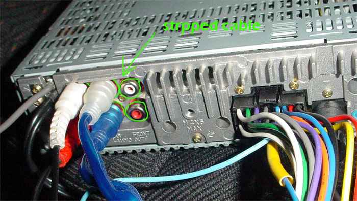

hi mate had this problem in my 106 i tried everything new wires, amp,and speakers and found the problem remained.
which led me to believe it was my hu. a whining whistle noise occurs when the earth tracks for tor the rca outputs on your hu blow.
you could either send it away to be fixed
i found wrapping little hoops or bare speaker cable, round the output rca's making sure they was also in contact with the metal case of the hu.
doing this stopped the whining.
heres a quick pic to help understand
i just cut a few short lengths of of speaker cable
stripped them back
made them into small coils by wrapping them round a pencil
then pushed them over the rca out puts
hope this helps
