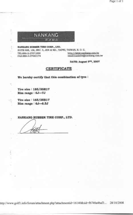

The car dont get used in the winter and is on stands having new powerflex bushes and a new coat as i type! And my drivin style is slow n show! It must of been them 195/40-17 tyres being to tall of a radius. Back to them 185.35.17 tyres were can i get em from? And how stretched are they on that 7" rim?
Nankang has them ;) You can see the stretch here;
This is on 7" wide rim. 7" is the widest rim the tyre is legal on. And I have NO SCRUBBING AT ALL! ;) Not even with 4 in the car!

The only thing that is important with this tyres are that you have to lower Alot! I have about 100mm drop, but I think anything less then 80mm drop will make this look wierd, couse of the very low tyre profile!
