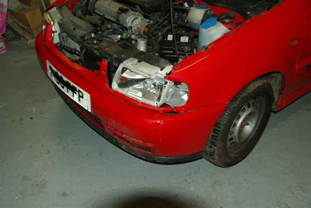

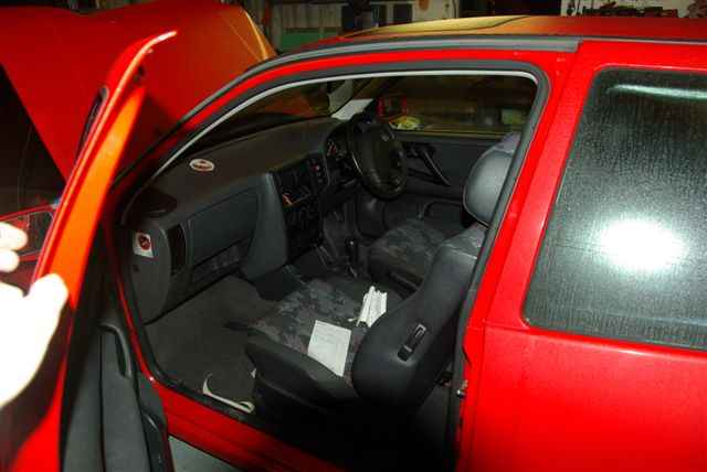

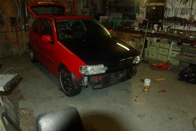

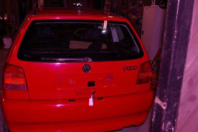

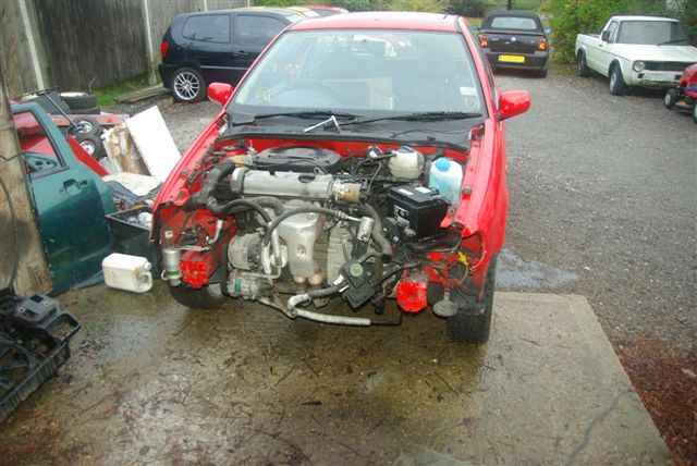

Heres some pics of the car when i got it home:

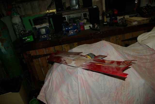

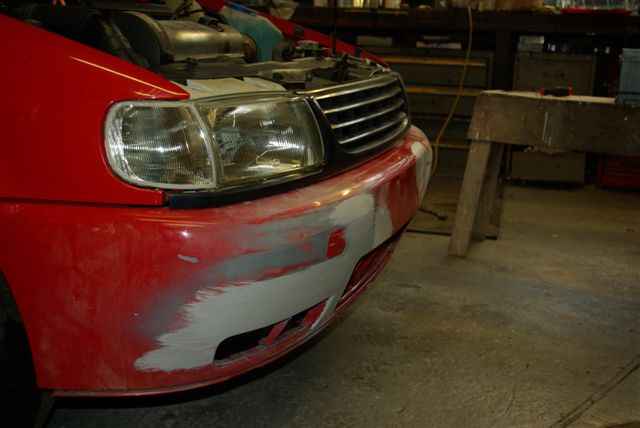

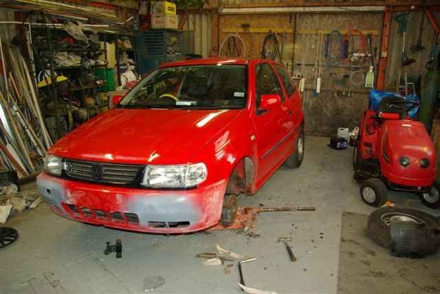

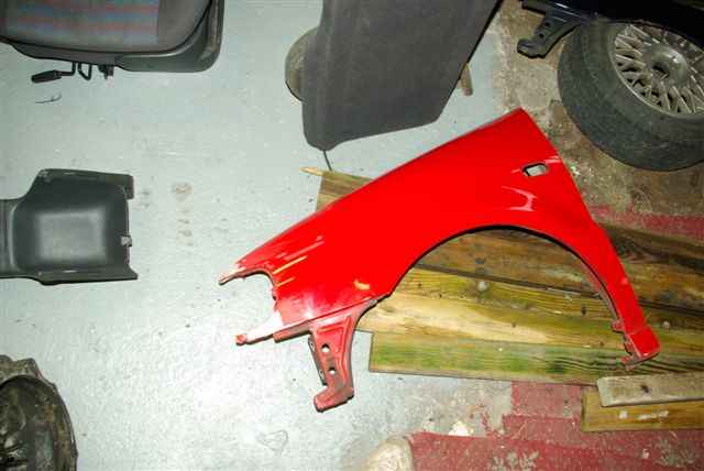

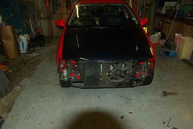

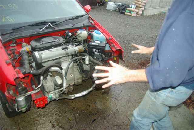

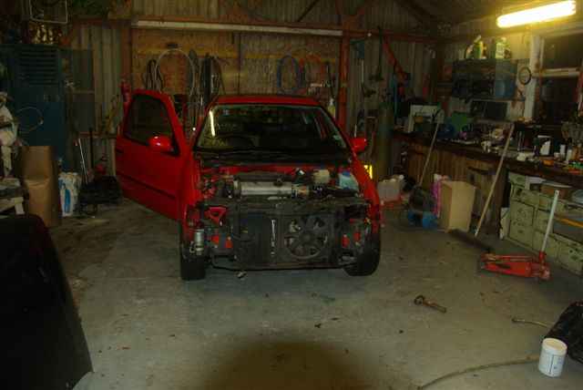

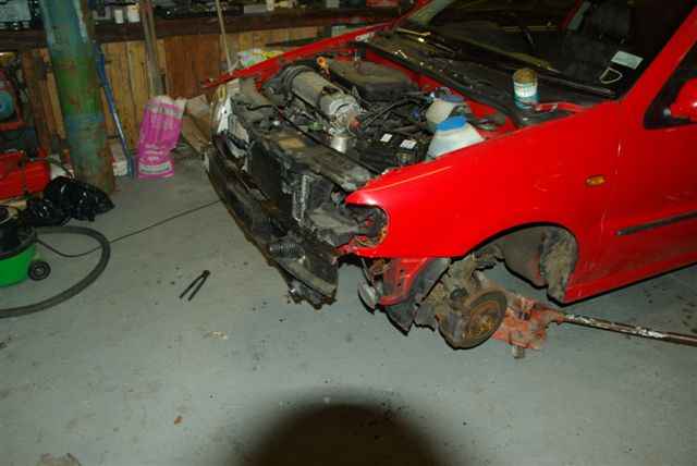

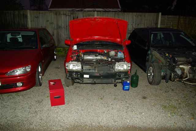

Was chuffed with my new base and started to crack on as i didn't have any plans Friday night, Started to strip the damaged parts off to see what was left:
The damage wasn't as bad as i thought, the bumper was repairable, drivers side headlight and indicator were fine, just needed to replace the bonnet, grill, passengers side headlight and the bulk head, air-con rad and the radiator were still ok.

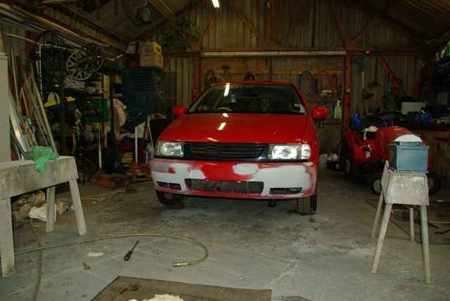

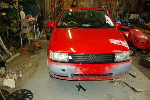

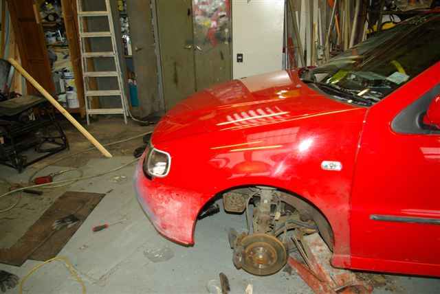

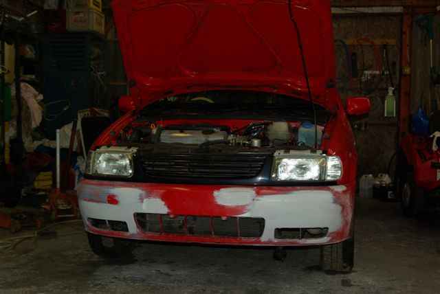

So i took the front panel out and inspected the damage, then set about taking my other polo apart for spares, after no time at all i had the front panel test fitted and the bonnet, grill and headlights lining up nicely:

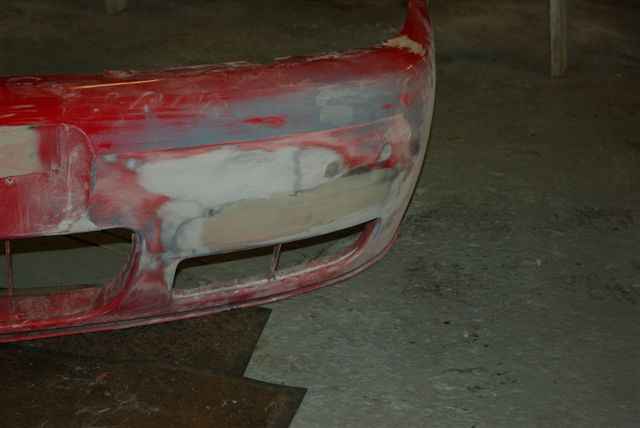

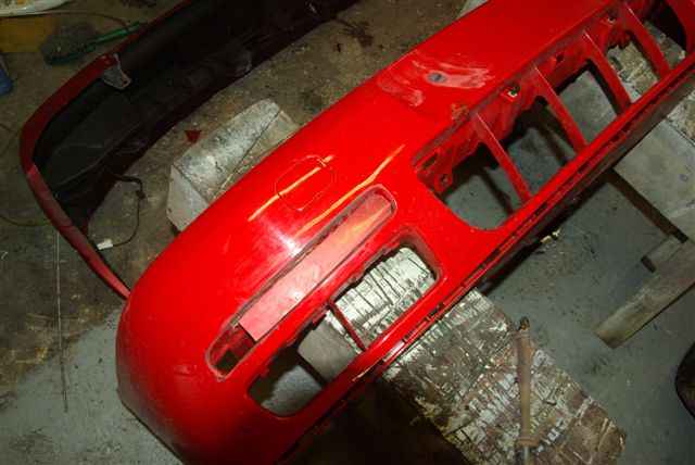

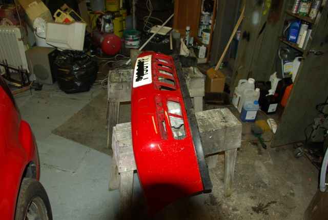

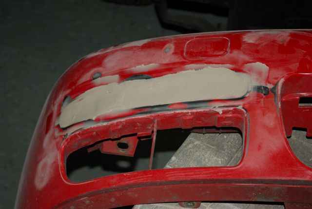

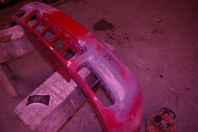

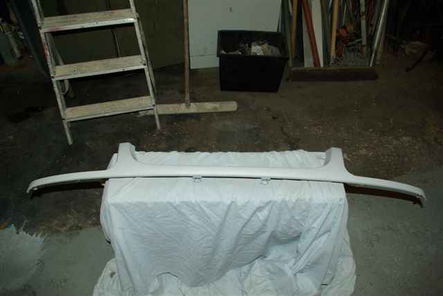

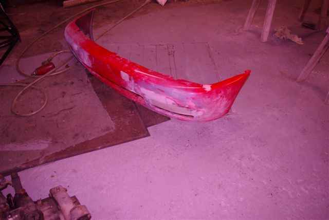

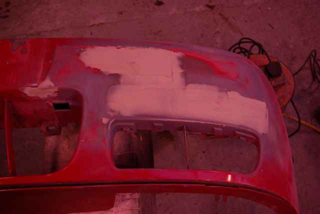

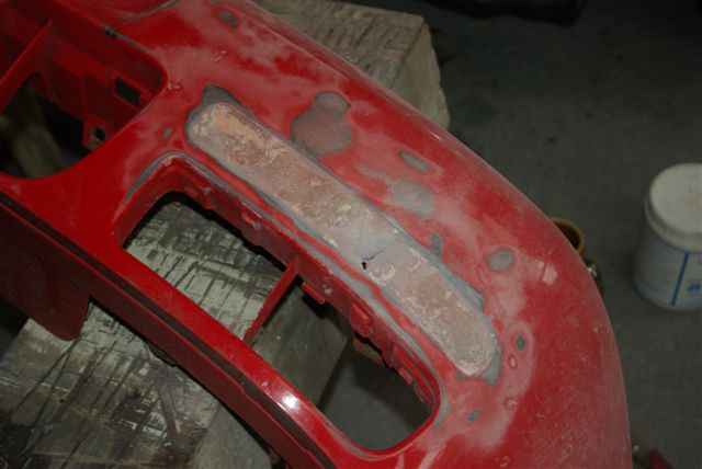

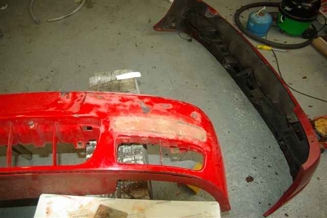

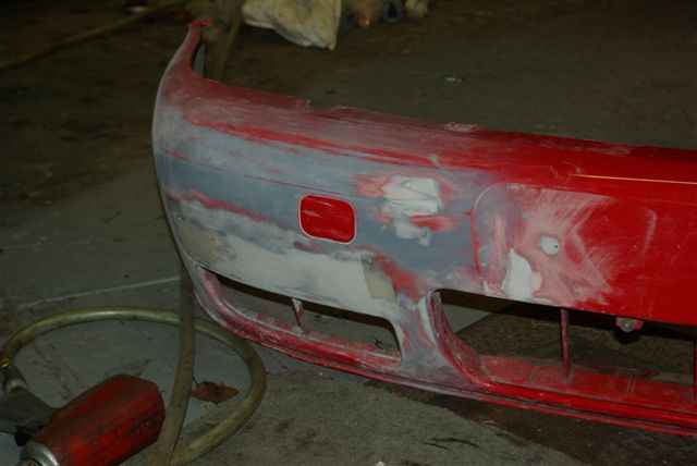

While all this was going on I was also prepping the front bumper and smoothing the top vents out:
I bridged the holes using pieces of plastic from an old bumper.
Then p40 to hold it in place...

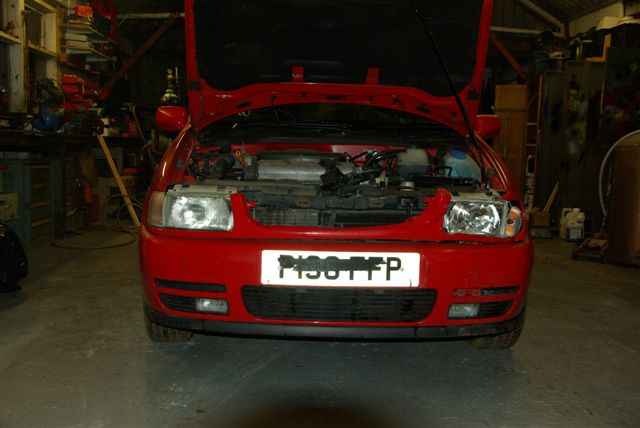

Got working again on sunday and fitted the front panel properlly, had to switch the looms cause of the fog lights.
got the radiator and aircon rad all connected up and the bonnet catch on, all I've gota do now is get the bumper ready and get the panels painted.

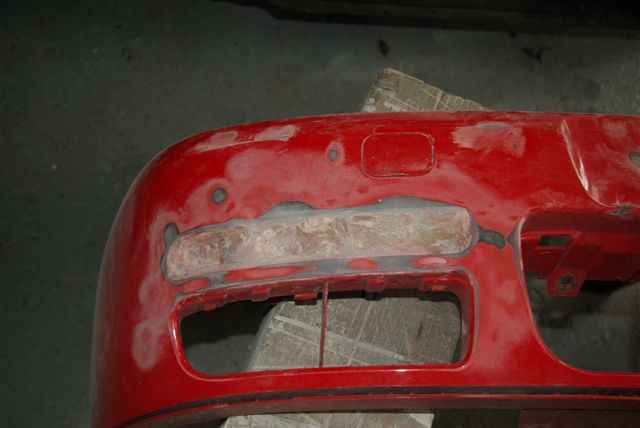

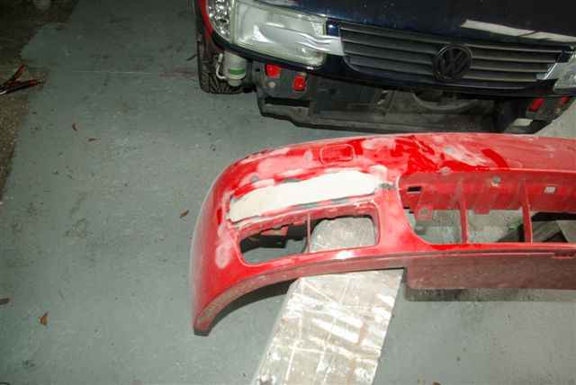

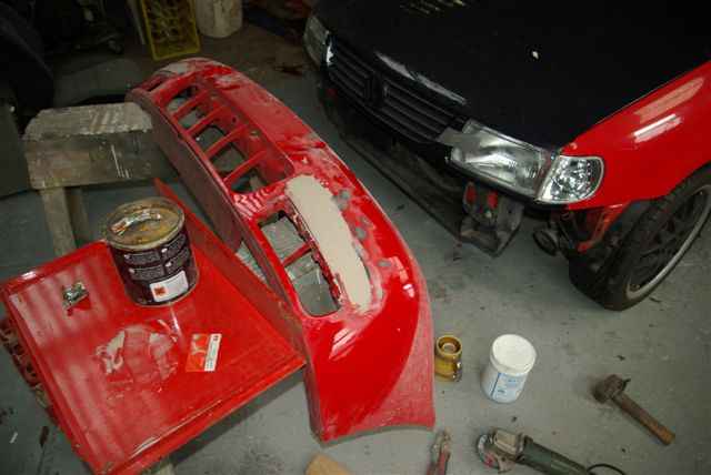

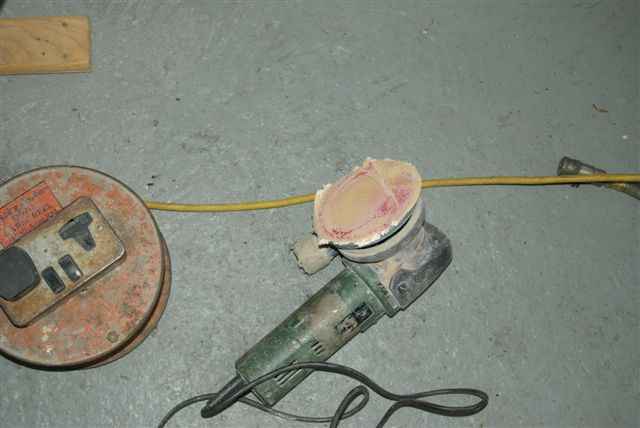

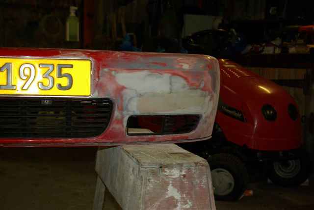

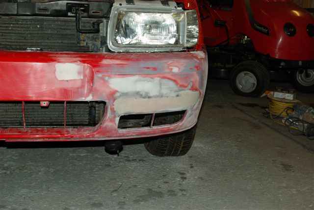

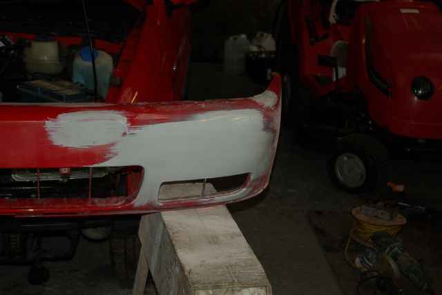

After id done that i attacked the bumper with the sander and some filler:
More to come soon......

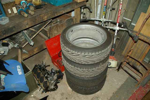

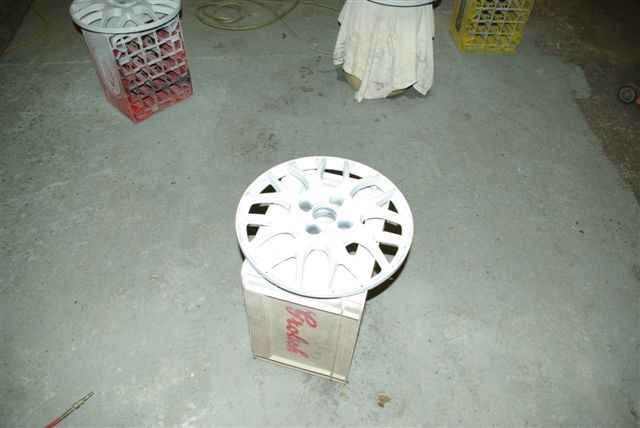

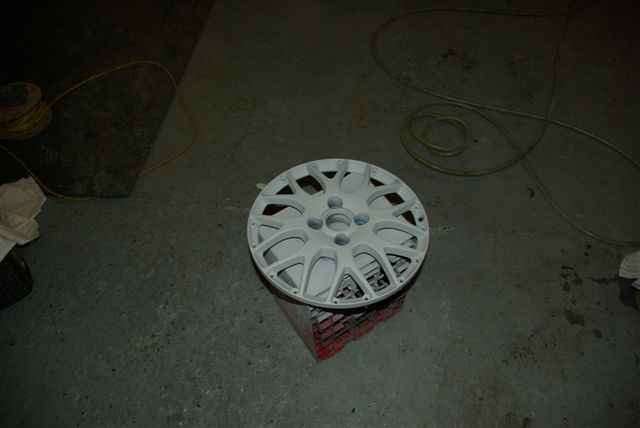

Split my wheels down ready for painting to....

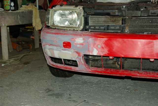

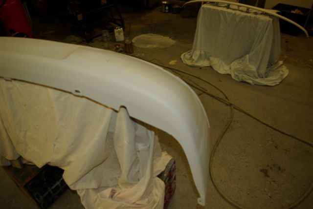

Getting the final prep done on the bumper before its primered....
Also fitted my wheel to see what it looks like, still need to wire the horn in....

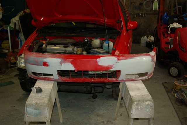

Bit more work from today.....

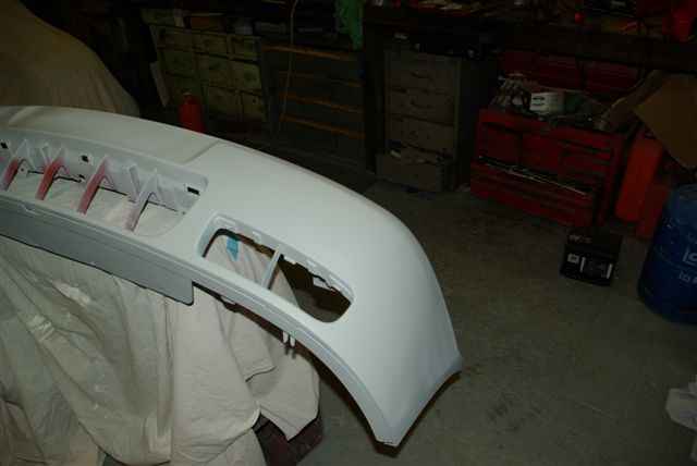

Been filling and sanding the bumper and its nearly there just want to make sure i get it right....

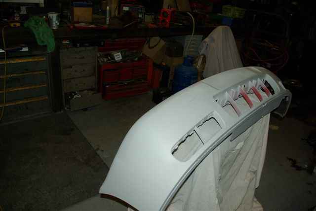

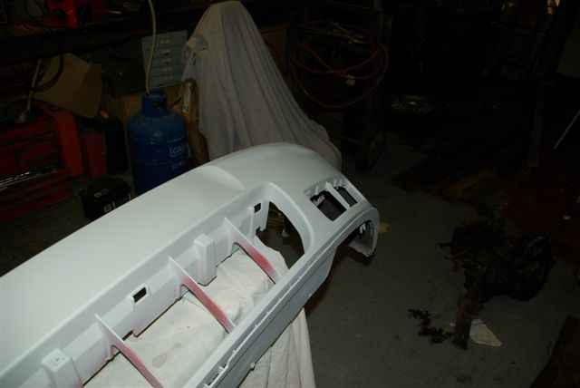

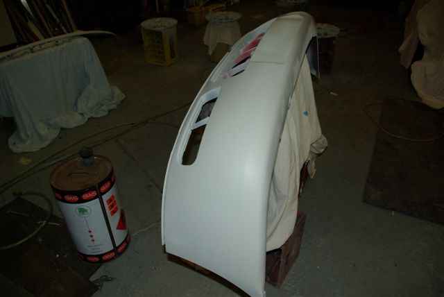

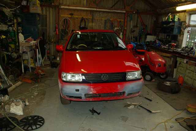

Bit more work going on today, been getting the bumper prepped still, painted some primer on to make sure I've got the shape right,

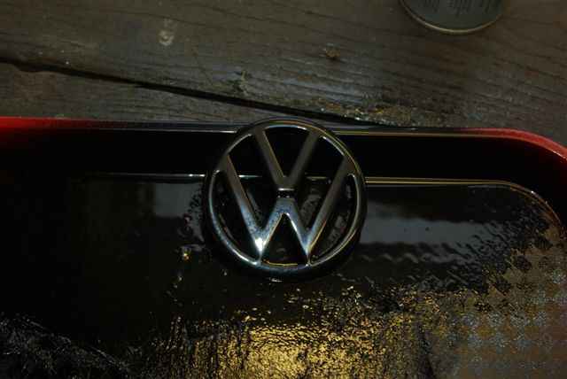

also done a few little bits hear and there, put my Sony stereo in and changed the door speakers, taken the badge of the tailgate and sprayed it black.
Hopefully I can have the bumper, grill and wheels in primer this week!
Sprayed the badge....

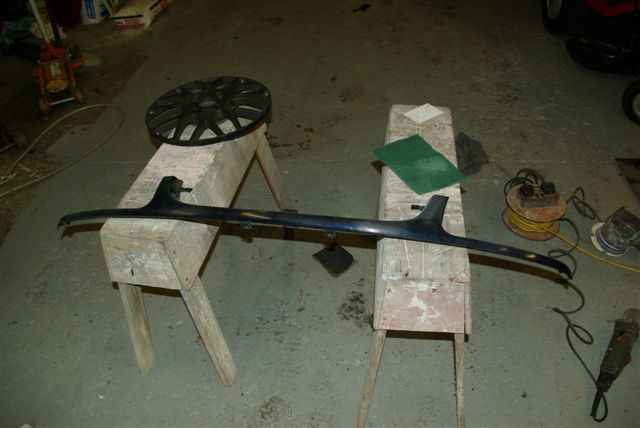

Flatted and primered my rear wiper plate...

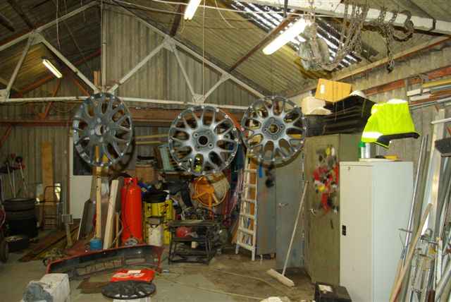

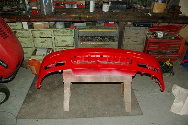

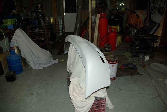

Bit more work over the last few nights......spent some time painting on primer and flatting the filler to get the best finish i can....
Then me and dad got the wheels, bumper and grill into primer on Tuesday night.
Heres some pics:

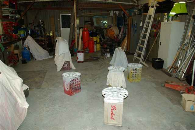

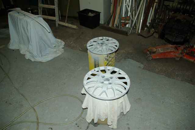

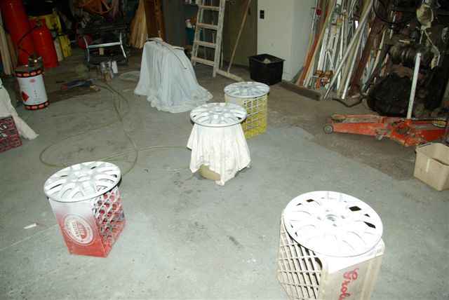

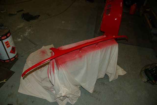

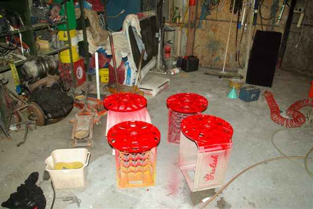

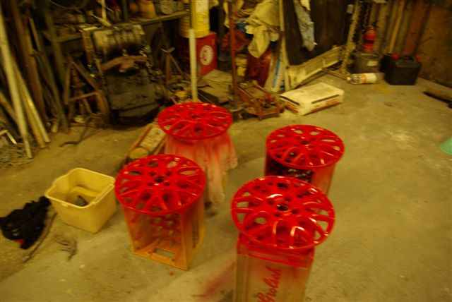

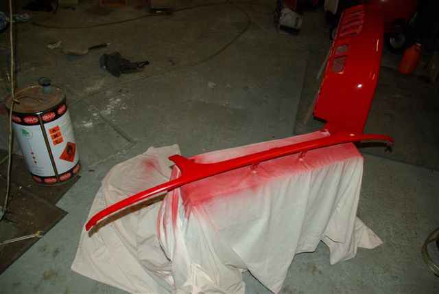

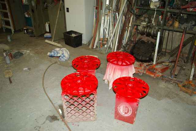

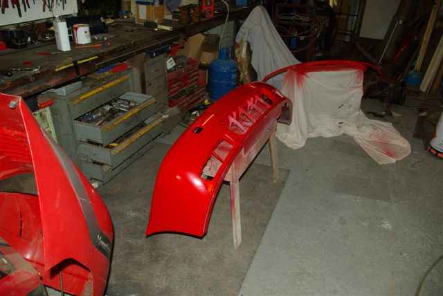

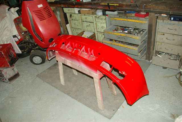

Finally got the first layer of base coat on my wheels, bumper and grill today.
Heres some pics.
Just need another layer of base on the bumper and to get the laquer on!

I'm looking foward to it to, gonna get outside and laquer them tomorrow.
Would like to polish the lip but i dont have the time at the moment,

any chance you could put captions on the pictures of the smoothing process, I'm really interested in what you've done and what you've used. cheers mate
hats off to you mate, :nod: this thread is excellent. nice to see some good DIY work :thumbsup: :thumbsup:
Yer il sort that out tomorrow if i get the time mate.

I've just finished smoothing my bumpers....just wondering what you used to spray your front bumper with? Did you use rattle cans....is the finish good?? Great build thread man....cant wait to see it all together...!
