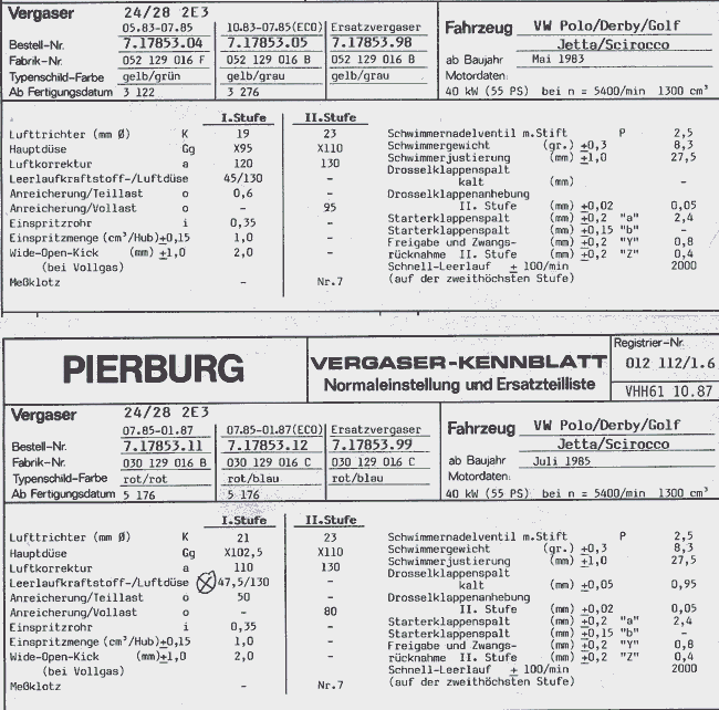

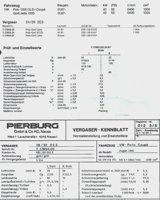

(standard pierburg is I believe 19/21)
Nearly,
The 052 129 016F or B on the 55bhp@5400rpm from May 1983 are 19/23
The 030 129 016B or C on the 55bhp@5400rpm from July 1985 are 21/23
These have 24/28mm throttle plates
The 052 129 016E on the 75bhp@5800rpm from August 1982 are 22/26
These have 28/30mm throttle plates.
Source www.ruddies-berlin.de Pierburg search the GIFs for Lufttrichter.

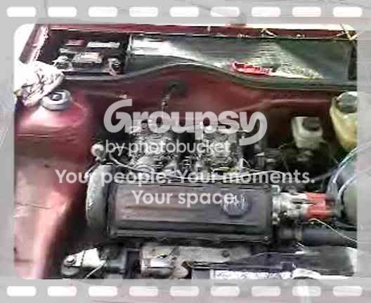

Hi, This is what i have done to my MK2 will post info if needed.th_FIRSTDRYFIT.jpgDSCF0092.jpgDSCF0098.jpgDSCF0103.jpgDSCF0105.jpgPhoto-0014.jpgThese next are after getting it from my freind who blocked the exhaust holes in the head, done with the possable return to stock..still need to change throttle as cable rubs on bonet and some times does not return to idle..POLO005.jpgsecond pic shows standard cable coming on top of carbs my idea was to use this with a rod down to linkage saving all that money for a throtle linkage.work in progres..
That looks like an awefully complex way to avoid the £60 for a side-entry throttle linkage!
Oh well!
Still, I'm jealous that your brake master cylinder is on the nearside! My brake cylinder has caused me no end of grief because of clearance.
Hi, The braket is due to manifold being cut to fit later mk2 and early mk3 cyl head. leaving me with two exhaust holes above manifold, this cut piece is used to apply cable to carb. Not having this ment cable braket but will change soon..
Twin Webers, very nice.
What about the oil breather pipe that normally goes to the air intake that'sat the corner of the left air filter.
Shouldn't that have a tiny breather filter, or go to a catch tank ?
I think K&N even sell a small adapter panel for their filters to take in such fumes.
Hi, have asked father X-mas for catch tank but gues wife might buy one sooner!!!! dont like idea of sump fumes going to only one carb with possible affects on fueling so will put tank on bulk head soon....as for now pipe exits to wheel well.not good for braking though..
does the breather put out much anyway? i decided it was a bad idea sending fumes into the aircleaner so dericted out under the car , i dont seem to get and oil /sludge out of it so no need for a tank really
HI, wrong post to ask might be re-located. Dont realy know how much mine puts out but there was a clean area in my engine bay where i just had the pipe placed in corner. With all the oil mist keeping paint nice and shiny (THIS is also a fire hassard as mist has warm contaminated air and oil vapours) Not really a nice idea to have crank case fumes just going any where so will fit catch tank soon, am concerned to about the fact the pipe should be filltered to pass the road worthyness inspection when it needs one...may not be the same in u.k. You may not notice as much the gunk comming out becouse you have it under the car? a tank collects it till you empty it.
Oil Breathers do put out a fair bit of crap over time,
I fitted my tank right at the front offside of the engine bay, in between the chassis leg and the radiator. It just fits.
Hi, thats where i hopr to place mine in cool air flow and out of sight at a quick glance of engine bay.newydd047.jpg
