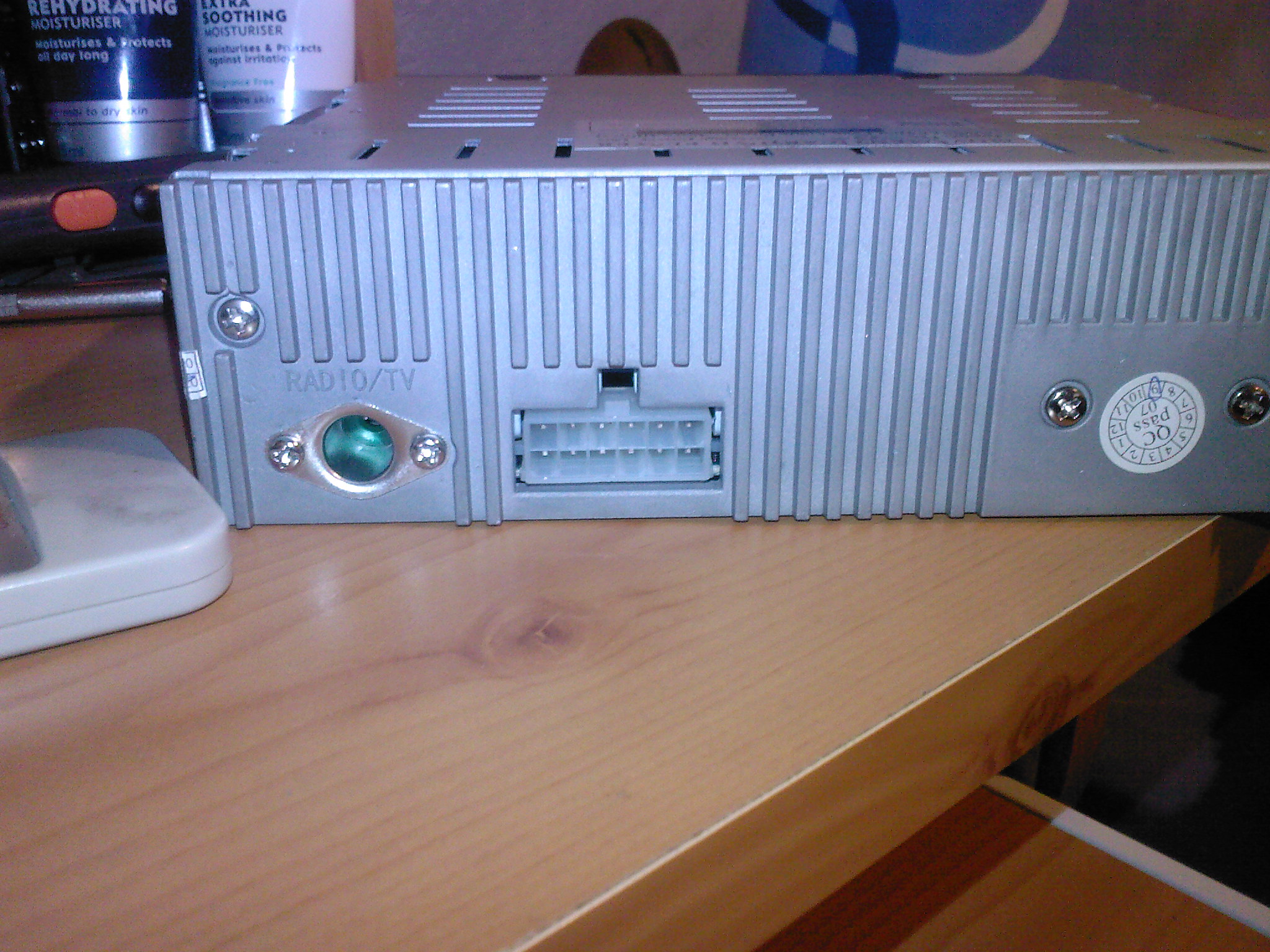

Bought it today, and i need an adapater for it to plug in, but don't know what make it is! the guy i bought it off didn't know either! theres a number on it, tryed goggle it, but nothing, just woundering if any one elese had one? long shot i know, cheers

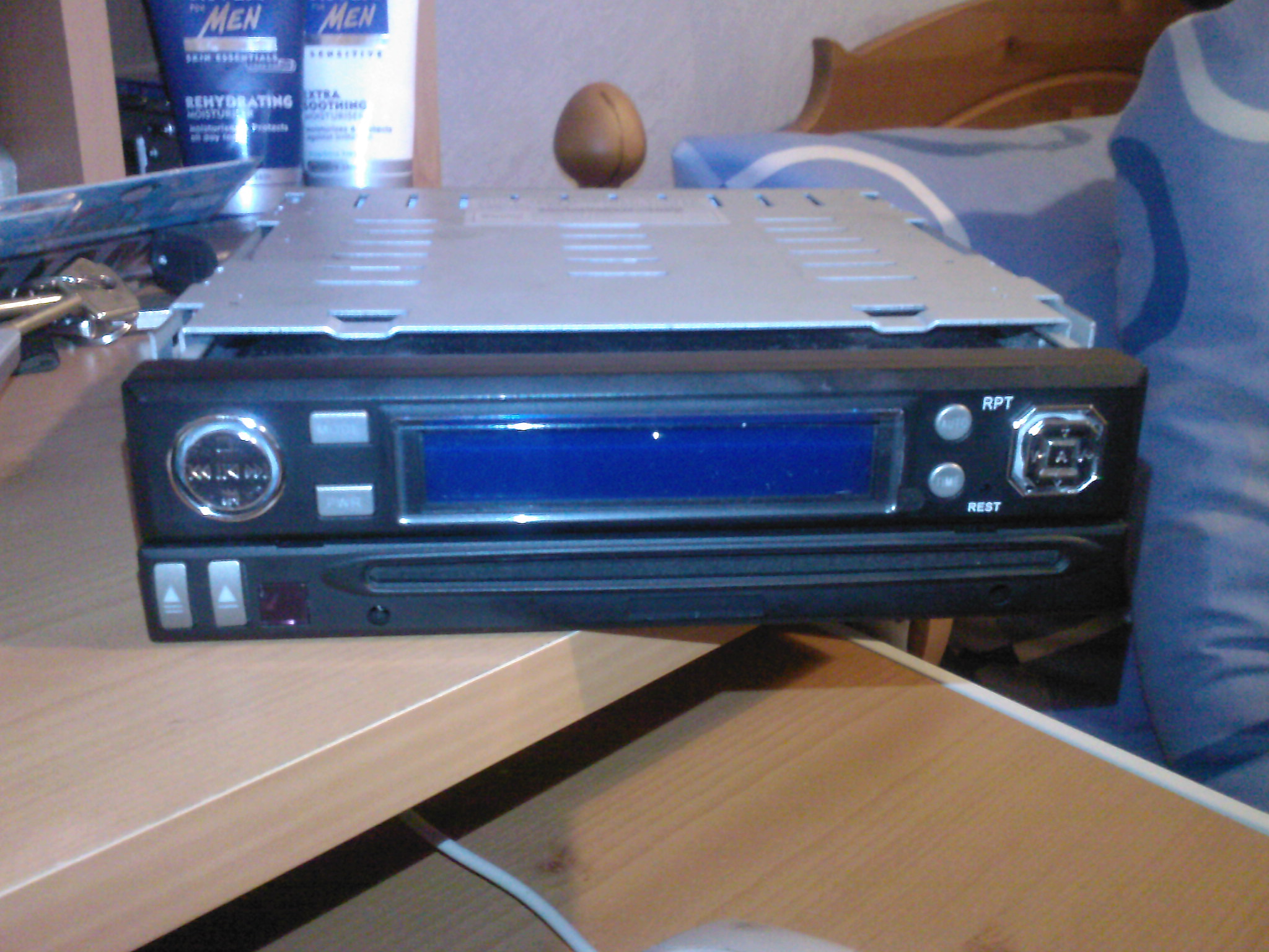

is that a CD headunit or a DVD jobbie? Cant say i've ever seen one tbh.
sorry mate, DVD, flip screen
i have a pioneer flip screen :D
Can u get the flip screen out? Might say the amke of it along the top of the screen, as in that picture above :)
if not on the screen, there should be some hint of manufacturer on the back of the unit.
or underneith it, it must have a barcode or something
na looked all over nothing
just opened it nothing on the screen

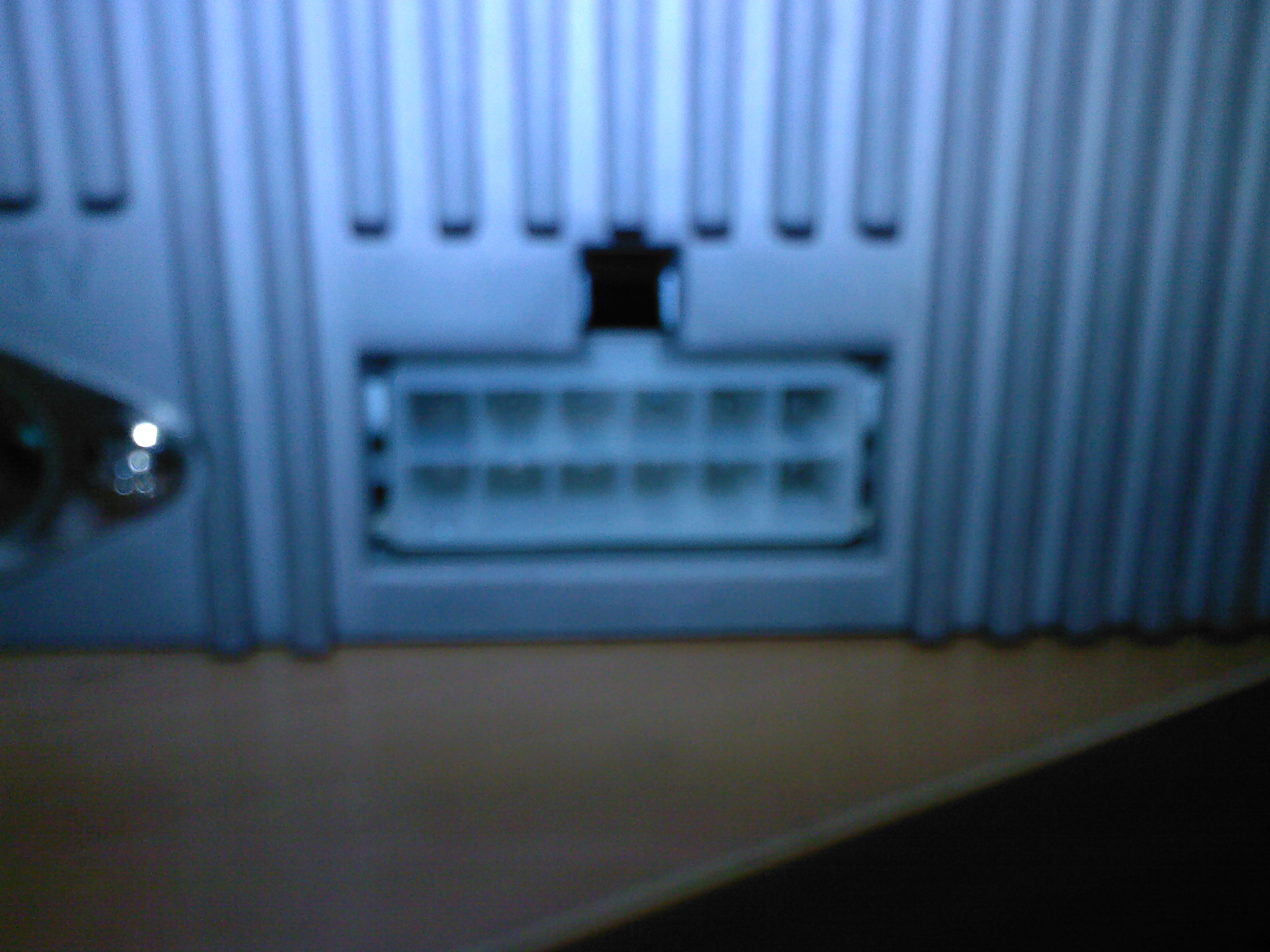

as before opened it, and nothing, their's a chip in it, and put the number in google, and it came up as one of those cheap japenese ones, can i use any adaptor, or do i need to use the right one for the model, it it has 12 pin as in the picture

one thing tho, i need a 15 pin to iso, but there hard to find, can i use a 16 pin to iso?

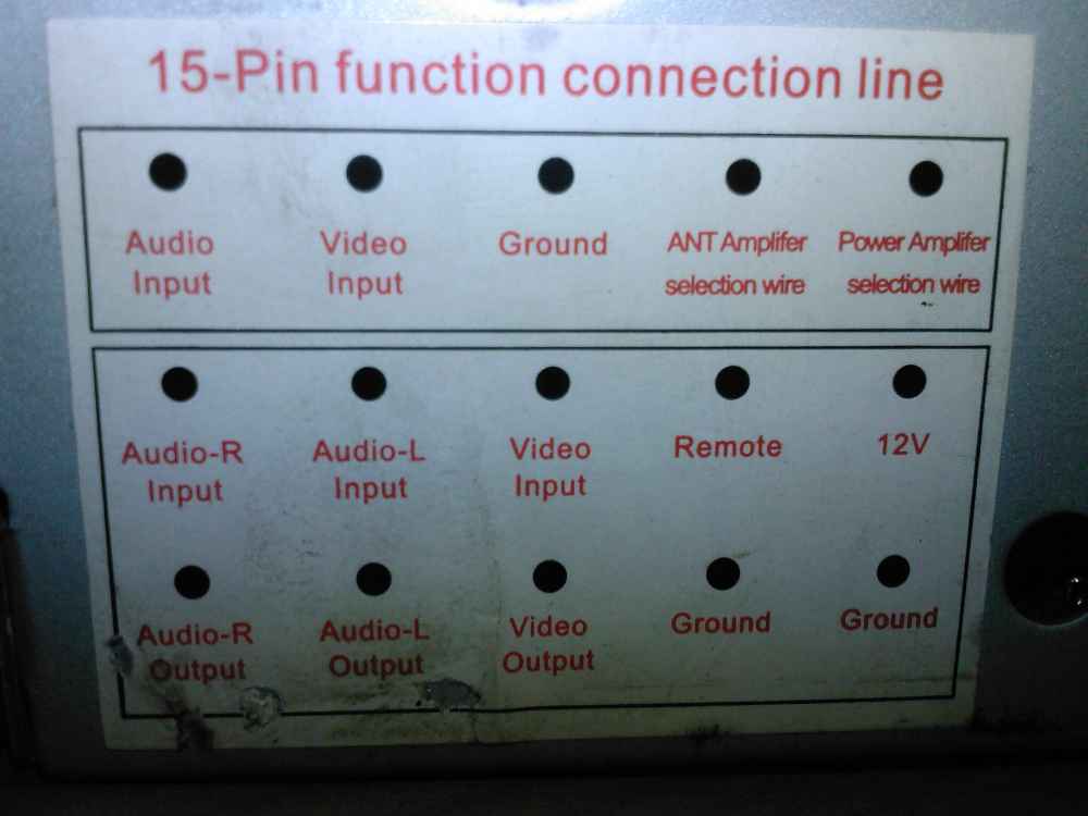

i'd say that the way the plug is wired in specific to the unit. If its not wired right, it either won't work or could short out. If you knew what each pin was, it would make life easier.
yeah it has a small sticker on the side, showing what every pin does
in that case, it should be real easy to wire up if you go by what the sticker says. Buy a plug that fits the connector and then wire accordingly.

If there's a diagram on the side showing the pin out then you should be able to make a connector for it. Go to your nearest Maplins and get a connector and some crimps to suit. Even looks like you might be able to cut a connector off an old ATX PC power supply and butcher that to make a connector. Get a mate who knows their way around a wiring diagram to do something for you. There's not going to be much to it other than permanent 12v, ignition switched 12v, earth, remote (for powering an amp) and 4 or 8 speaker wires (depending on whether it can drive a pair or two pairs of speakers).

if you post a pic of the wiring diagram you said was on it, then it should be possible. Although whether we'll be able to source a connector that fits into the head unit is a different matter, it looks like it has different shaped holes so only the exact connector will fit. Might be like a PC ATX connector (it's certainly similar) but might not be! I'm amazed there are no identifying marks on it what-so-ever though.
if any one can make an connect the photos are
