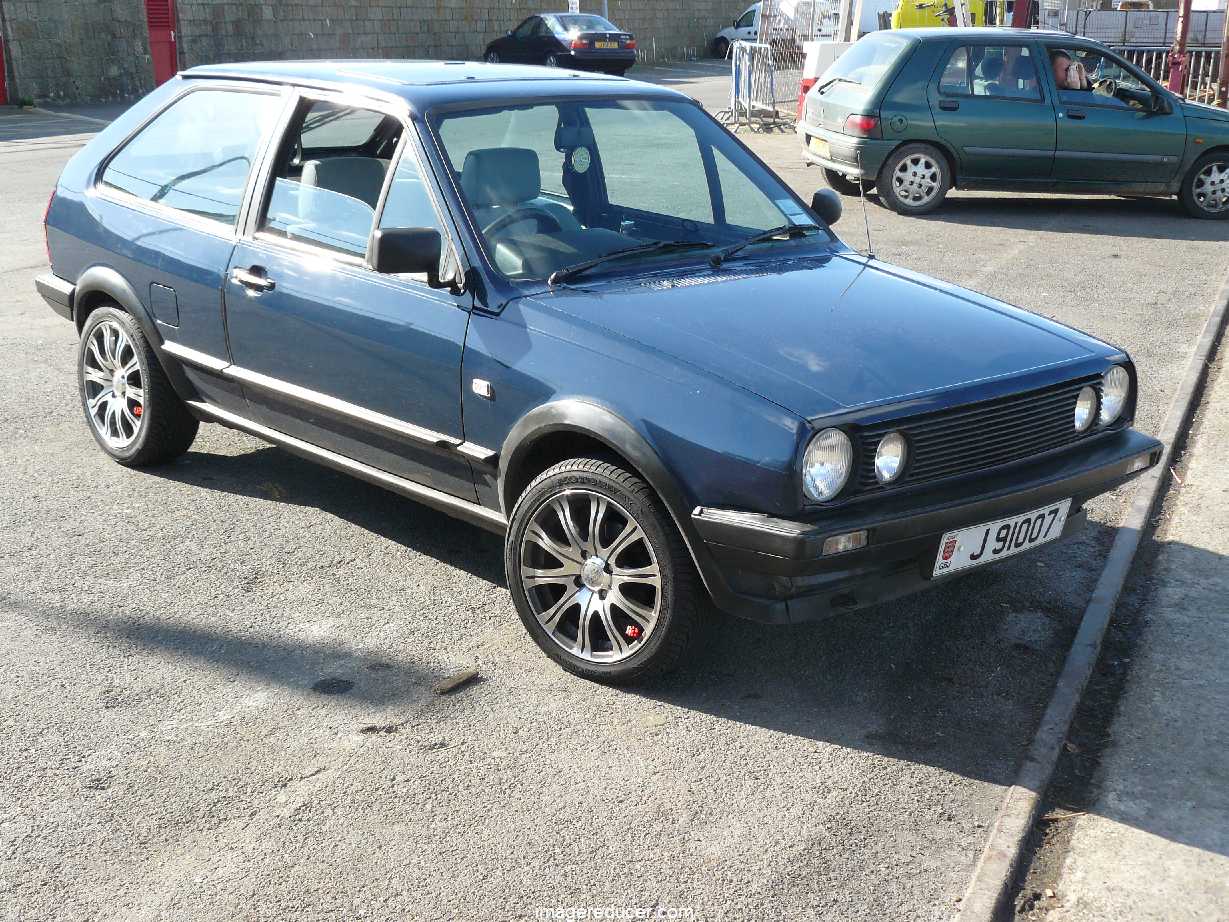

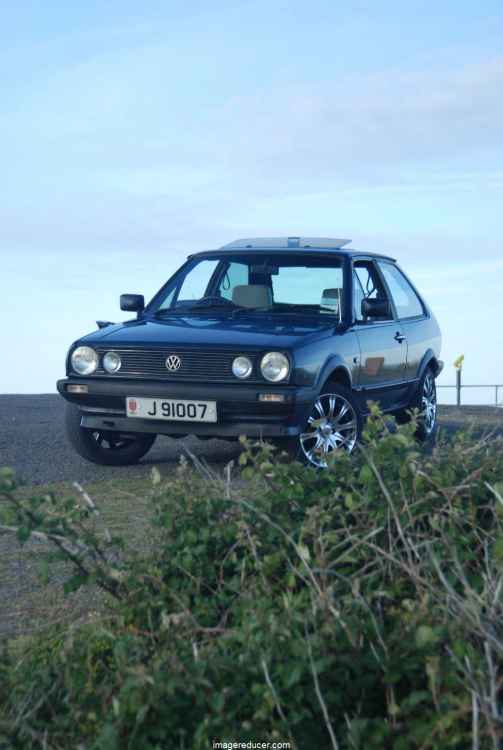

I am running 15"x6.5 and i regret it. I feel they are too big for the car.

thanks for that have you got a side view of your car ??

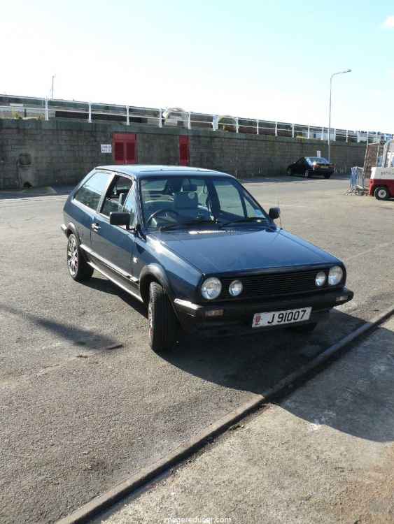

grunge is right 15s do look a bit too big. That pic has made me change my plans i wanted to slam a mk2 on 15s but i think 13-14" are plenty big enough. 13x7 ats classics would be a good and common choice.
Looks even worse here
is that with stander shocks ??
and yes 15" do look a bit big on a polo
dame i wanted some 16" but i don't know wow
yup standard shocks
its not your wheels that are too big. its your tyres
i love the way mk2 and 3s drive on 15s fitted with the right tyres
