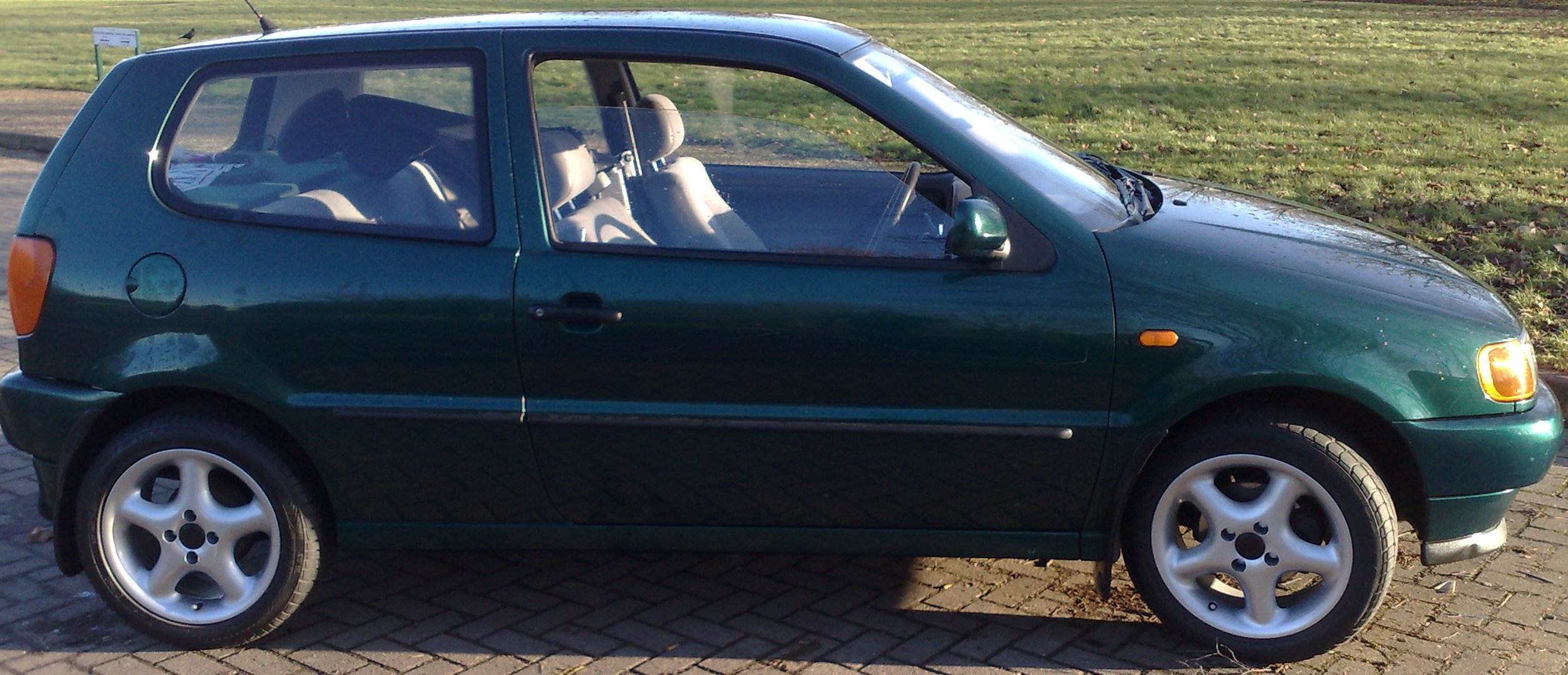

I'm looking at some wheels for my standard polo ( 97 p 1.0l).. just want some advice weather these wheels will fit nicely.. they are 15 with offset of 35. rim width is 7j?? ( this concerns me ) with a stud diameter of 100.. these are on ebay atm and need help b4 i put a bid in they did come off a golf but not sure what yr waitin for email from seller with that info

So my standard 6n which i believe has an offset of 38.. will a 35 offset fit????
Well they fit perfect just need my new springs exhaust and new engine in the summer
