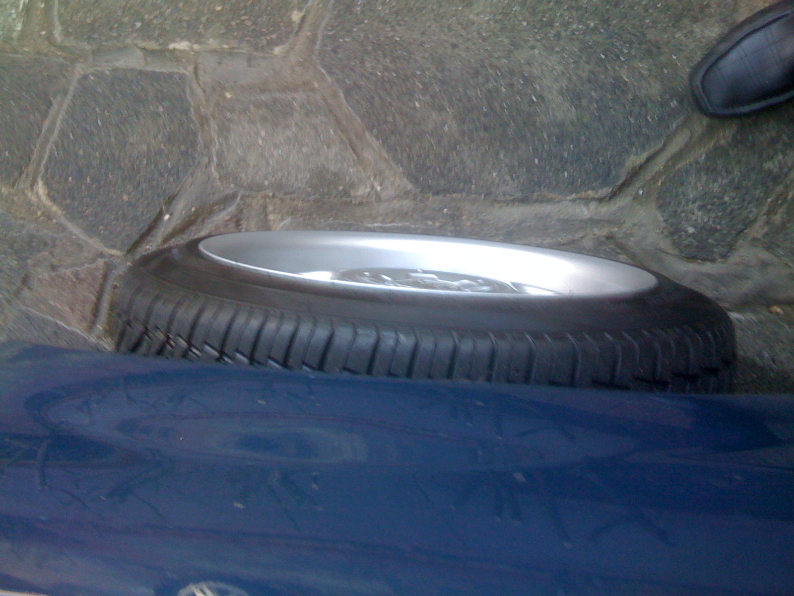

Hi guys, I'm try to convince my bro that his wheels are illegal on his mk2 loon as they stick out wayy to much, he can get 3 points and his only been driving 2 months
but he thinks there fine, what do you think?

illegal mate, 3 points plus fine per wheel if the tyre tread is out of arch, looks boarderline though from that pic

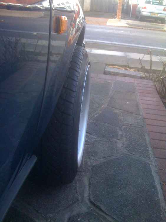

check the last pic i just uploaded, top view
Get a front-on view to be certain, but yeah looks illegal.. to be fair if you're not sure or think it's borderline, its not worth the risk..
yep illegal
ILLEGAL!!!! might get away with it, with some uber stretch on them...also i was warned by the police, its possible to receive 3 points per wheel but not sure on the truth of that

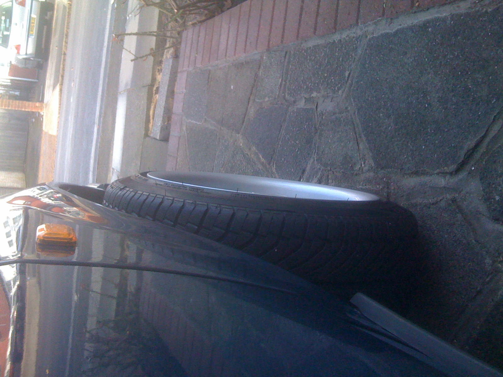

First pic looks borderline, second looks like its sticking out,, however might be the angle you took it at?

Could do with a bit more stretch or get the arches flared.

Get a flat surface and place it flush with the arch, lower it down until it touches the tyre, if its on the tread then it is illegal, on the side wall and you may just get away with it.
