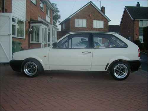

thats how it sits now, would we say that was more than 60 on the front? is possible that phil or the factory have boxed it up wrong i suppose?
looks 80-90mm
looks 80-90mm
that looks about right for 60/40 (don't forget you have balloon tyres so it'll have no arch gap like people run lower profiles have) get some pics of how the driveshaft is sat in relation to the inner arch (with the wheels on the ground).
these are mine on a 175/50/13 on a 7" rim and thats down 60mm at the front:
even if you were down 80mm (lowest philj does) then you still won't be low enough for driveshaft to inner arch contact, the relaxi taxi was on chopped springs from what I remember and that was hitting the drivesahft on the inner arch
