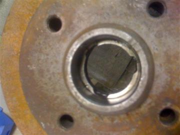

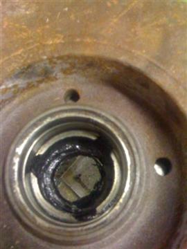

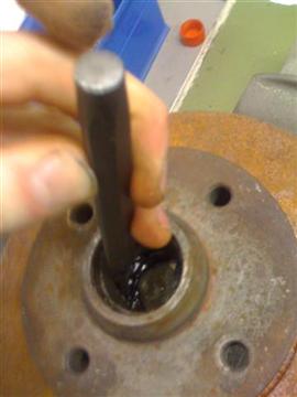

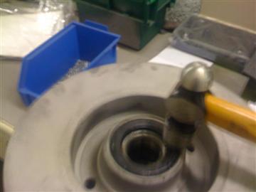

After removing the discs/drums use a punch or long and strong shaft to punch out the old races.
the discs/drums should have cut outs like so to hit the races out
Rear of drum/disc
top of drum/disc
if you hadnt already removed the bottom bearing - hitting the race out should have removed the bearing and the dirt seal.

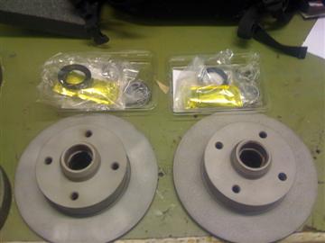

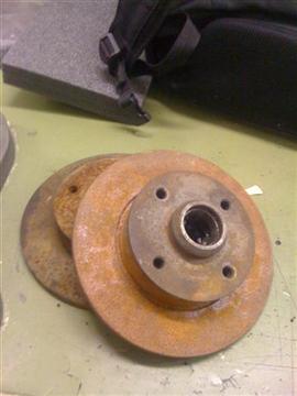

i have shot blasted my rear discs
A- because my discs were fine and just had surface rust
B- makes it easier for you to see what I'm doing in the guide

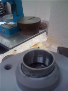

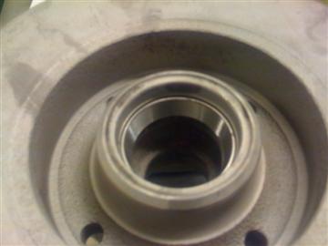

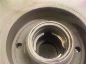

It is very important for you to clean out the bottom of the edges/faces where the new bearing will sit - any dirt will make the race not sit flush and will make the bearing wear out much quicker.
This is the rear mating face

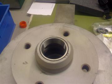

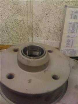

use the old race you just hammered out to push the new race in.
do do this gently tap the new race in as far as you can with a rubber mallet.
if no rubber mallet is availible - use a piece of wood to place on top of the bearing and hammer in with a normal hammer.
DO NOT DAMAGE THE BEARING RUNNING FACE!
place the old race on top of the new one and continue to push the new race in.
IMPORTANT! - when using the old race to hit the new race in- make sure they are facing the same way, this will leave a big face for which you can get the old race back out again! (SEE PHOTOS BELOW FOR REFERENCE)

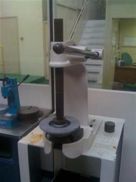

i used a press to finish this stage - but the hammer method will work and so will using a vice(if its large enough)

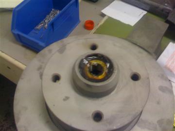

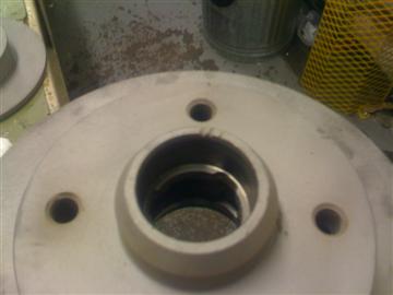

The same method is used on the top bearing
ensure the mating edges/faces are clean.
push the new race in using the same method as above.

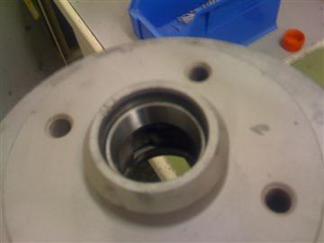

Hit the bearing race in as far as you can
The photo below shows the old bearing race ontop of the new one. as you can see it faces the SAME way so that you can tap it out again.
This is needed because the bearing race goes 1cm deep into the drum/discs making it hard to install with a hammer.
once you have hit the old race out it should look as follows

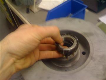

Grease up the bearings giving them a good spin as you do so that the grease gets in everywhere
Tap in the dust seal
and do the same to the other side
