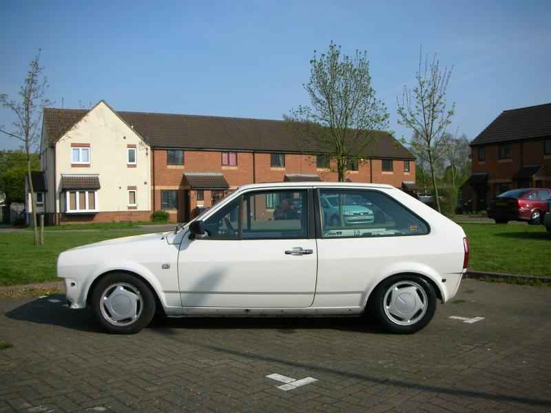

Here's mine
is this what you mean?
LINK TO REAR ARCHES
thats the ones
