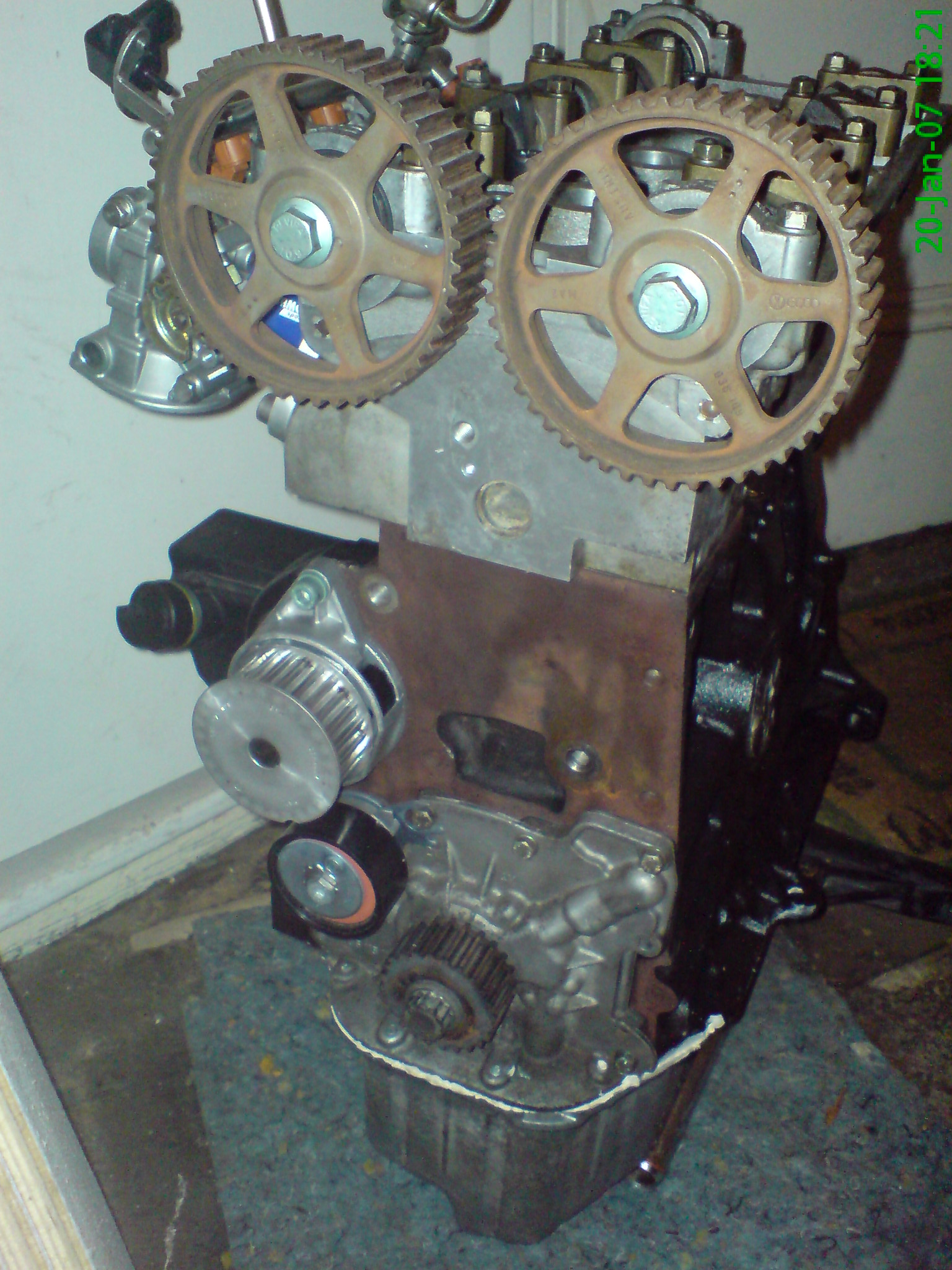

The deck heights are matched to the strokes on the one's I've got,which are 6n.
This is a '98 1.6 block with a '98 AFH head on it. The block is taller than the '98 AFH block by approx 9mm. The 16v rods and pistons sit almost flush with the deck at TDC,compression ratio about right (flush on AFH),it all fits as per GTi as far as i thought.
No surprise then,that either the belt or engine mount are going on - but not both.. :)
So if the GTi has a shorter block,it must have shorter rods as well,then. I dont see how they can be 9mm shorter without being pulled too far at BDC.
I appreciate that my replication of a GTi block may be flawed,but any differences dont make sense.
If anyone knows where I've gone wrong,such as ETKA which i dont have,or the ability to do maths which i also dont have,could they enlighten me please?

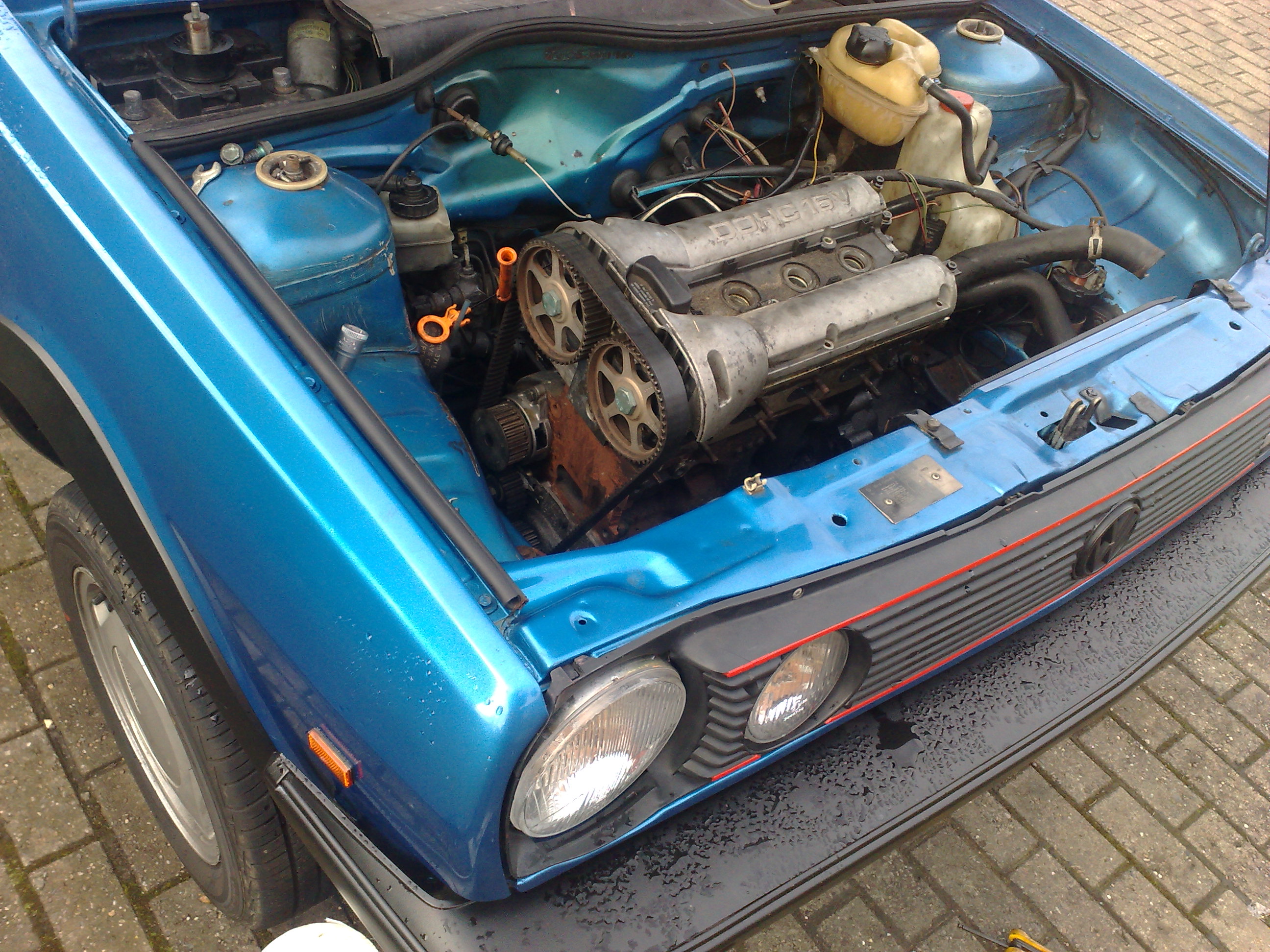

Okay,I've been tinkering with this over the last couple of weeks,and found it near impossible - though i used a BCB engine from an '03 Golf,which shares the GTi design.
I have now built a 1.6 AFH,but i had to use an AEE crankshaft to do so.
This is because the AFH cambelt is too wide for the BCB crank pulley,and the AFH crank pulley doesn't fit the BCB crank.
So if you want a 1.6 16v using the AFH head,this is what i recommend because I've done it,i know it works,and i know what parts are needed.
(Also,this engine is entirely bolt-together,using entirely OEM parts - no engineering)..
A) Full AFH engine.
B) Bare 1.6 8v AEE crankshaft (uses AFH's chain-driven oil pump and wide cambelt sprocket).
C) 1.6 16v BCB con-rods and pistons (snapped-type big ends - use new bolts as they're stretch bolts).
Its that simple. :)
Doesn't include fuel system because I've used bike carbs,so good luck with that..
