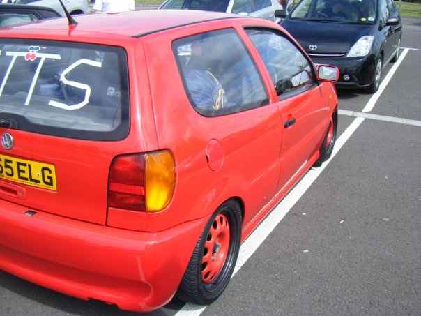

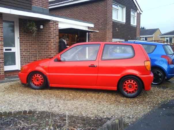

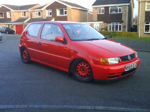

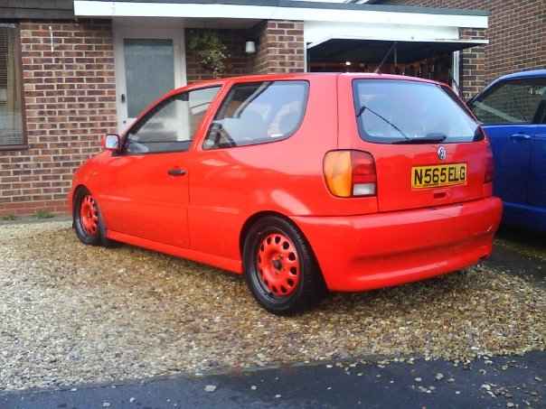

Here are a few pickys of my little girl, she is still a work in progress but with her being a budget car up to now has amounted to under £1k including the car and time as me and my partner are doing it up together so progress is slow but getting there :-) I love her anyway :-D

looks quite tidy for a budget car :thumbsup:
different too
looks really smart :thumbsup:
i like :p , did you just spray the normal alloys that come with the polo the same paint colour of the car? if so is it a big job IE: can it be done without proffesionals? mine are just abit rusty thats all maybe i shudnt be cheap and invest in some deepdish

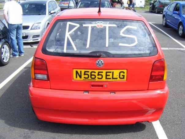

run to the sun ay? should have gone Plymouth Volksfest instead :p
car is looking nice though :) black badge on the grill i reckon.

Hi Ollie
Keep beeing cheap its the way forward lol yeah they are the standard ones just painted, I'm not sure how hard it is to do them, depends how well you can paint i suppose, my partner did them for me as my christmas present, all i know is that he did them himself, dont know how or the cost I'm afraid and he wont tell me the cost lol so can get him to pm you if you want.
Yeah thats the next thing to be done also the back one is staying on i think :? if it does it will go black same as the one in the grill.
RTTS was good as a festivall but really disappointed with the amount of V-Dubs there.
going polo show though cant wait fingers crossed Cherry will almost be complete by then, and might have a shot at the show and shine for the first time, you never know until you try haha. :-D

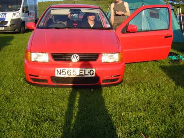

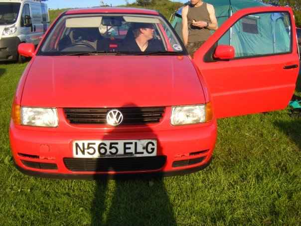

Is the guy in the second photo from the top taking a whizzle?
I was going to quote it, but you've attached the photos.
Looking good by the way, keep it simple.
:lol: he looks a bit suspicious dont he.
