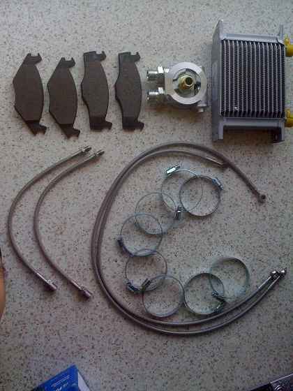

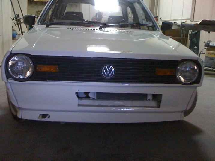

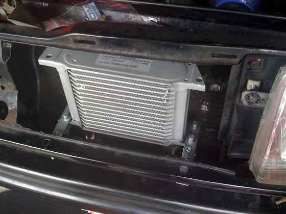

Once I got the engine in and the charger set up I have to get some silicon hosing so I went to a local place near me. Once I got the hosing I thought it might be worth getting them to make my brakes lines, charger oil feeds hoses, mocal oil cooler (was a BARGAIN!), thermostatic sandwhich plate, and braided oil cooling hoses. All the braided lines and pipes were made on the spot, I just told them what I needed. Awesome place, its called Think automotive and they are a mocal dealer. Available to buy stuff on the web too.
Ow and got some normal Brake pads from GSF ( witha CP discount ;))
The braided hoses they do come with stainless steel connections and a plastic coating over the braiding for protection. Nice looking stuff.

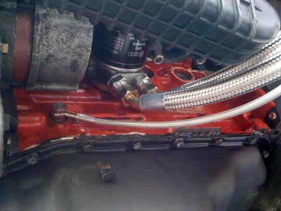

Fitted all the hoses and made a fitting behind the grill for the oil cooler.
Edited by goosyganger

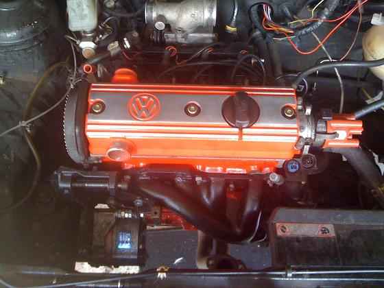

Once all was fitted this is what it looked like in the engine bay.
As you can see the loom is not connected as yet, this is the broken one, it was taken out and replaced with a much better looking loom.

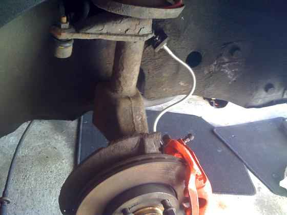

Also, a pic of the freshly painted brakes and the new brake line fitted. Looking at it now I wish I had blasted the struts with a wire brush disc on a grinder and given them a lick of paint. Maybe do that as the summer approaches.

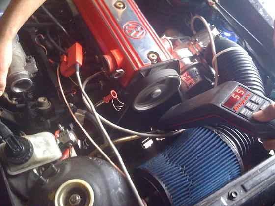

Doing the timing was a bit of a mission. Took a while and was quite stressful because the engine would cut out after a few minutes. After some searching and questions on here it turned out that I didnt connect the vacuum line to the map sensor on the ECU. For those reading this that are doing their first conversion its the little nipple on the ECU. It needs a small vacuum line going from it to the large one way valve vacuum pipe going from the inlet manifold to the Brake servo. Similarly, the fuel pressure regulator vacuum also needs to go to this large vacuum pipe. I used to have the OEM plastic ones but they have been replaced with silicon vacuum lines now. They come in different colours and look neater.
The result of the vacuum not being connected to the ECU was the engine cutting out and ALOT of black smoke from the exhaust. Also when slightly accelerating when stationary it backfired with a ball of black smoke lol. Not cool. I must say thanks to Olly (polo6n2g40) for his reply in my post when I had this problem that helped solve it. Thanks mate.
Some might slate me for it but I ended up timing the cam belt without the belt cover with the knotches. But used it as a reference. I just forgot to put it on when putting on the V-belt pulley and didnt want to spend half the day taking it back off and putting it on. Any how, initially I got it a tooth out and this resulted in the engine running like shit, and the ignition being very hard to set up. So started again and repositioned the crank. Much better! then it was a trial and error process with the help of a timing gun and the shifting the distributor (and a few friends). All in all it took a while to get it right. The idle was very high and fuel consumption was aweful to start with, not to mention the epic hunt it was doing, but as I played with it a bit and adjusted the idle screw on the throttle body it eventually became better. Now once warm it idles just below 1000RPM. (with a slight hunt, a bit anoying but I've been told several times that some G40s can be a little moddy lol).
