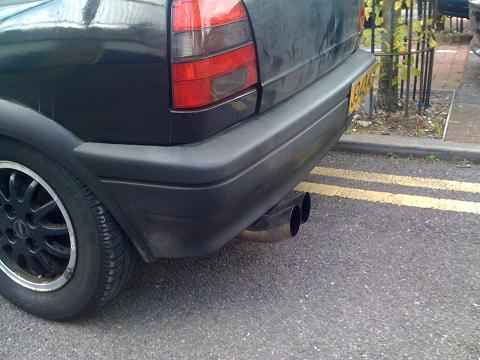

Got a full stainless steel exhaust (2.5") made by Scorpion with a custom decat downpipe for under a hundred quid. Initially wasnt too keen on the twin exit, but it sounds awesome when booting it and I think it suits the car now. So I'm happy.

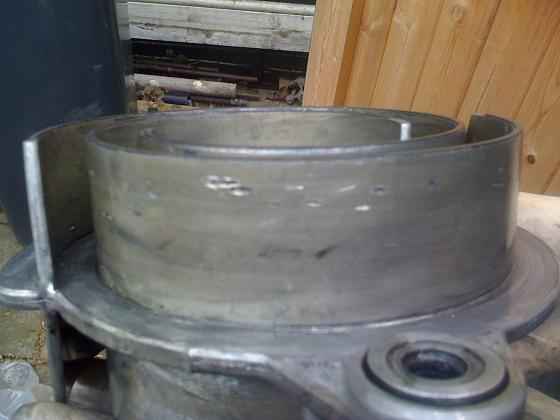

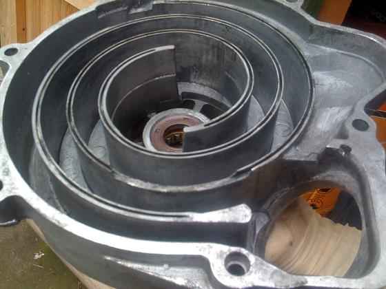

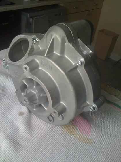

thats not good. the outlet is definately fecked. Scroll looks like its taken a bit of a battering in the process!
Your right Pete, it was well and truely fecked Ha. However, I was reassured it held boost when in the previous owners car, not sure how but hey.

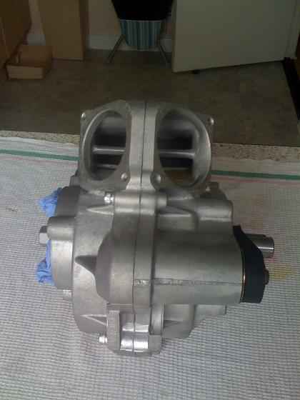

Nevertheless, it was resolved and I managed to get a set of casings for free and wanted to see whether I could get away with using the scroll even though it has got some damage on it. So, I bolted it together with the new casings and sent it off to Jabba. Decided to get an R1 service rather than getting it done later. Brian at Jabba checked it out and didnt see it causing much of a problem and carried out the service. Lots of money and two weeks later, this is how it looked...
Was cleaned up and ported out with all the servicing included. I'm a little sad, but I love it when port/polishing is done nicely and you can see the size difference between the two inlet ports. Also the porting on the outlet is pretty awesome.

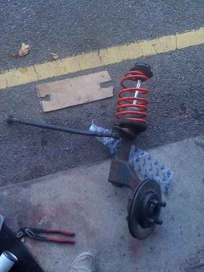

So I took his advice since there is more power going through the wheels I got onto PhilJ and purchased one of his lowering shock and spring kits. Good value.

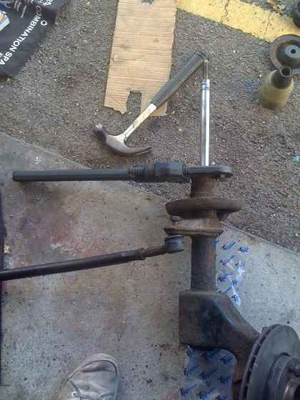

Started out fitting them thinking that the strut was too rusted to change the shock cartridge but looks were decieving. I was recommended to buy some Stillsons and it did the job to get the cap off on the strut that holds the cartridge. This is now my favourite tool lol. Here is how it was done...
Firstly, I couldnt get the ball joint off that is connected to the strut and to the traction arm. So I dismanteled it from where the steering column meets the traction arms.
The undid the top cap. This can be a little tricky and I found the hard way that its a bitch to remove the self-locking nut on the top. You need a deep set spanner (Machine mart do them) and you need something to grip the top cap. I gripped it with the stillsons. Came straight off.
Once the cap is off I concentrated on the wishbone and all that. Once the whole strut is out dismantling the rest isnt hard.
The first pic is the old shock and spring. You can see that the spring didnt even need spring clamps to get it off. Pretty low.

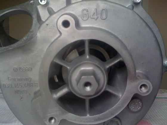

Once the shocks were done I could finally drive my new G40! I had to then get through the running in process of both the charger and the engine. I was recommended to do 1000miles on the engine to run it in. This included 100miles on crap oil to rinse the crankcase and all oil chanels of all things that collected whilst dismantled (dust, dirty, metal shavings etc). Then at the 100mile change put in more not so good oil and do 500miles. Once 600miles were completed do an oil change to good oil, I opted for Castrol 10-40. Then do another 500 miles and do the final oil change with good oil, during this process I didnt exceed 4000RPM. Then your good to go!
The charger was run in at 400miles under 4000RPM (off boost).

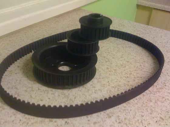

Here are some pics of what is required for the pulley conversion...
1. Toothed pulleys and belt - 230Euros

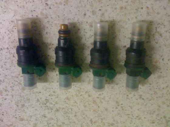

2. 250cc G60 injectors to compensate the extra fuel required. I've been told its not necessary but good to do. Having them cleaned before fitting. - Injectors about £40, Cleaning - £35 from PPP or £55 by injectorcleaning.co.uk.

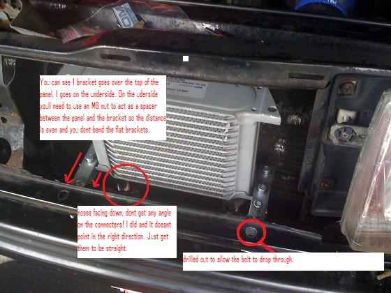

Here are the prices for the oil cooler bits and bobs. Also Ill include the reference number for Think Automotive Ltd where I got the bits from, www.thinkauto.com.
Mocal Oil Cooler 16Row, 124mm high, 115mm Width - £35 (was 50% discount because it was a damaged one. Very small stone chip and half a bracket was cut then returned for refund. They do a range of damaged ones going cheap :)) - OC1163-8
The Male to Male Steel threaded adapters for the Sandwhich plate M18x1.5 - £2.07each X2 - MMS5-8-85
Stainless steel braided hose 1/2" - £11.07 Excluding VAT at 17.5%) per metre - I used 1.210metre - £11.39 (15% VAT) - I asked them to make one of the hoses a few inches longer because it needs to reacher slightly further - S100R6-8
Female threaded adapters to go on the hoses 1/2" - £3.29each X4 - HEFSW43-8
Sandwich plate (take-off plate) - I don't seem to have the price on any of the invoices which is strange, maybe they chucked it in with the stuff I bought, have no idea. But I think he said the one I got was around £30-£35, this is a thermostatic one. Only opens the cooler when oil needs to be cooled so doesnt overload your pump. Here is the ref numbers though and perhaps you can enquire - Sp1 - TOP1/TOPO1 type A. I'm pretty sure its that.
Mounting for oil cooler
As far as the mounting goes, pop to your local B&Q and buy a pack of these flat brackets (product no 328500001). They come in like a pack of 10 but you only need to use 4. About £2.
Get some 5mm allen key bolts and nuts to suit X 8. They are easier to work with in tight areas. I work at a bike shop so we have loads of little allen key bolts and nyloc nuts which I would recommend. s=So might be worth popping down to your local bike shop theyll no doubt have them and give them to you for free.
Locate where you want it to sit. Obviously you want it just inside so that the grill fits back on ok.
When fitting the brackets obviously use the lower mounting brackets on the cooler BUT remember the cooler is going to be sitting with the hose connections facing the ground (upside down). You can see from the picture how it sits. The bracket on the oil cooler has 2 holes, the flat brackets you got from B&Q should have its holes the same distance apart so you can secure these flat brackets to the oil coller with your allen key bolts. One goes on the top and one on the bottom as you can see in the pic. Do this for both sides. Youll need to tighten the brackets onto the cooler first as you cant really get in later.
You can see which panel on the car that I have used to secure this fittings. As you can see I had to drill a hole through the top bit and straight through directly under it so that I could drop the bolt through the top bit to the hole just under it. Make th top hole slightly bigger then 5mm though so you can get it out easily later.
Then find where you need to drill a hole on the panel to be able to secure the hole further in on the flat bracket.
Tighten everything up and your good to go.
Something to look out for is either getting shortish bolts or cutting them down a bit otherwise you will have to cut a little groove into your bumper to let the bumper sit nicely. I'm sure youll figure that bit out though.
Like I said, nothing rocket science. Might not look the best but its behind your grill so noone sees. Also it cost me about £3 to make it fit onto the car! Happy days!
Hope this helps - here are some pics to assist.
