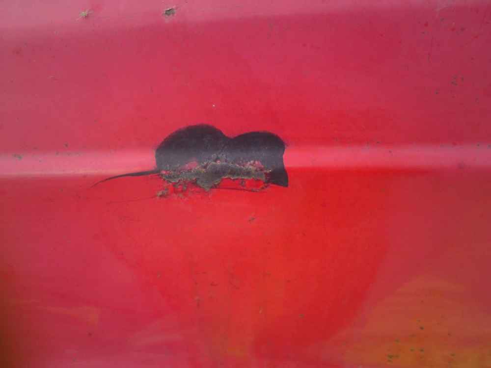

now this is the biggy, the hole!!!
not as bad as i though...wont be too easy to fix, but got 2 solutions, cut the small hole out into a square, weld the square back up, or go scrappy, cut new panel and weld tht in, eitherway i need to learn to weld! lol
