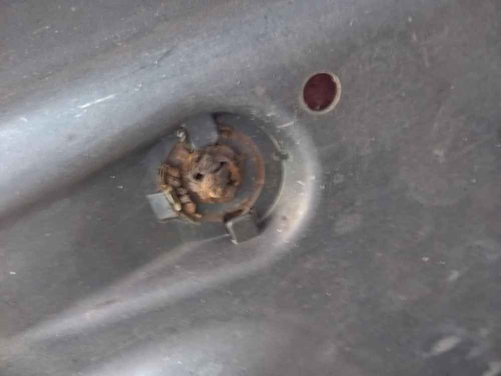

Subframes
Nuts are made of cheese...you heard correct! The thread will go very easily, I've had to replace both Wishbone arms and take the subframe off, remove a nut and weld a new nut in to hold my gearbox mount. Expensive work...
Moral of the story, if you are going to replace your wishbone bushes...do it right the first time round and get some hardened ones in there!!!

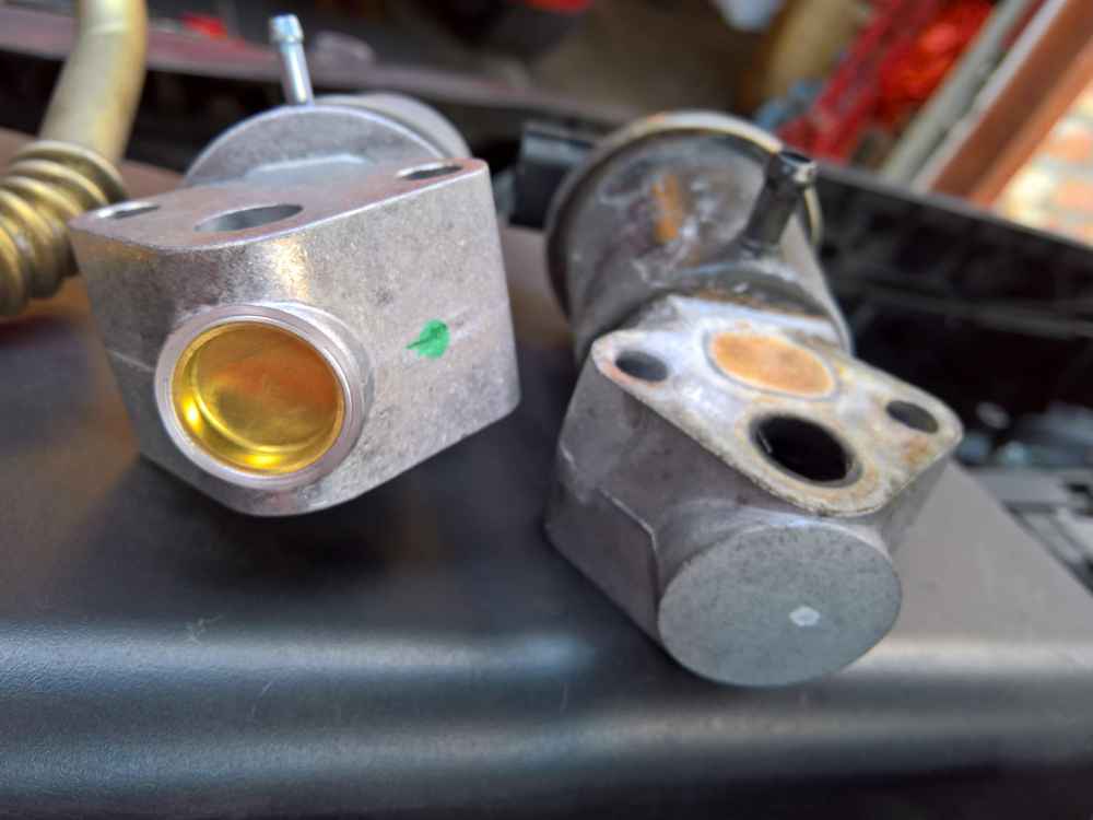

EGR valve (idle is more steady after changing this and the design is completely different! Picture attached)
