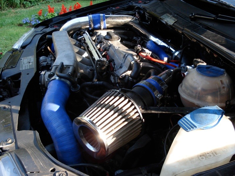

Babz - I know what you mean but it could be worse! Could be a Scooby vent!!! I don't know whether it's 100% nessercary, I might try a std bonnet and see if it gets too hot... it stays bang on 90 degs at the moment.
my temp is allways at 90... but it scares the shit of me how hot the rocket inlet and boost pipes get... there are red hot! I'm looking at bonnet vent i think

See that's the thing... my engine water temp is bang on... but it's soooo tight in there the other parts could get very hot without the vent... then again the TT and my Ibiza got very hot under there! Hence the warning stickers on the charge pipe!!!

nice motor, like the plans you have, bonnet is marmite mod i've run a raised bonnet on a couple of my high powered smaller cars and does suck out some unwanted heat in the bay.
