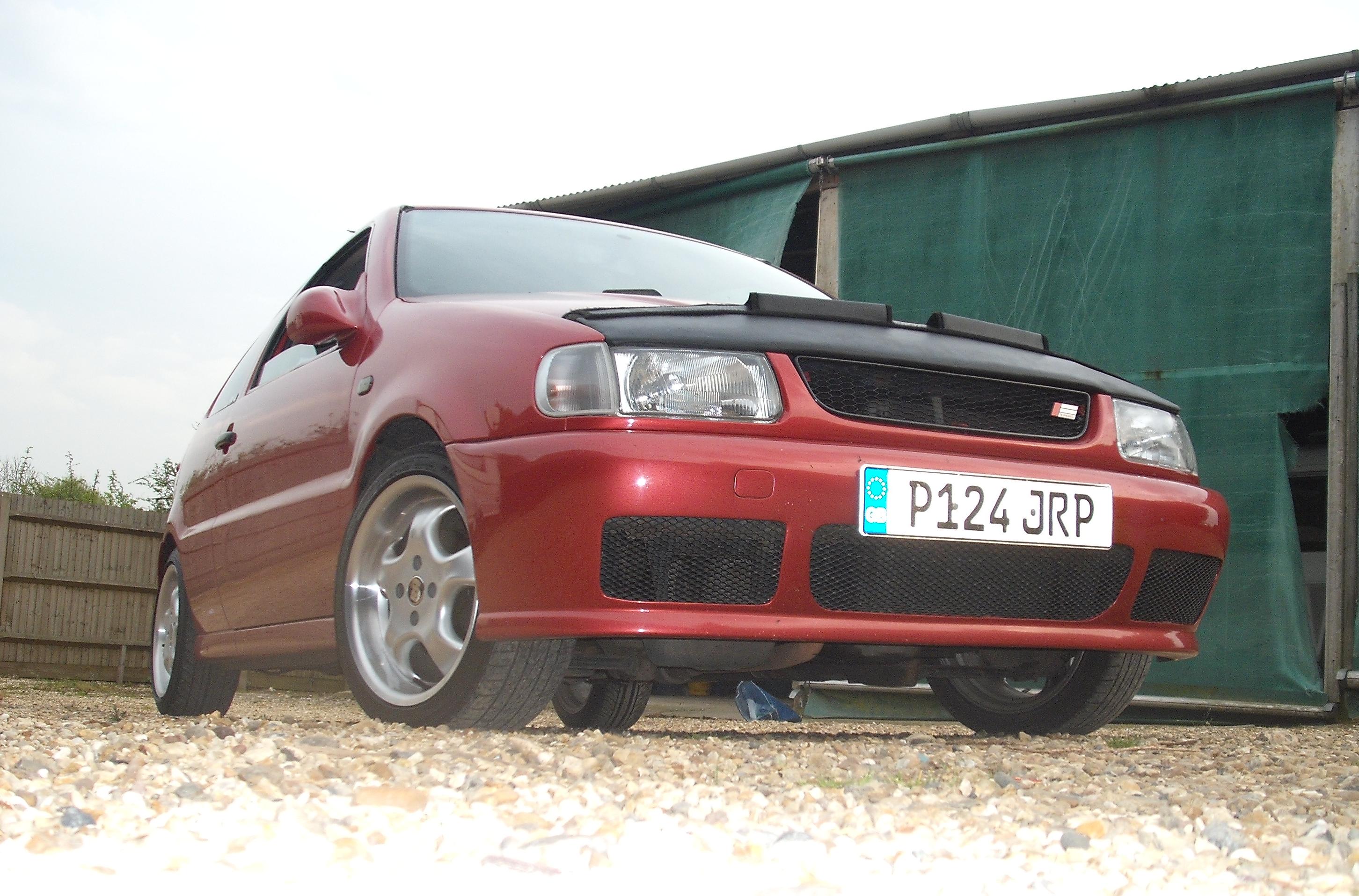

If I might be so bold, but I always wanted to see how a bumper with the plastic between the fog light and that bit on top removed would look like. This plastic:
i just got a polo for my first car, and it has the bit of plastic removed and i dont think it looks that bad lol :-D
thats a really tidy polo, which headlights are they?
