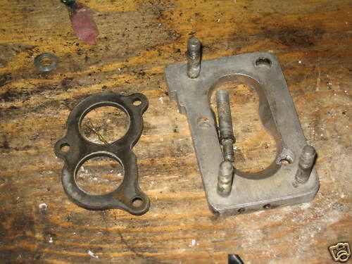

Having installed the Weber carb and fixed one air leak at the base, the engine with the choke in and cold starts up, goes to 1,200 for a second, then drops to 800, then dies. With the choke out (choke flap set to close off the barrel), it starts, goes to 800, then dies.
I have tried putting a silicon based spray lubricant around the bottom of the carb, around the rubber mount and the gasket from the outside as it sits on the engine. I know the pump is working because I have seen it pump fuel into a bottle when the fuel line to the carb was disconnected and the engine was turning on the starter motor.

Today I checked for a vacuum leak at the base of the carb by spraying Easy Start at the rubber block. The engine revs increased slightly when I did this. So I removed the carb from the rubber block, cleaned off the surfaces and to make sure I put a bit of silicon gasket sealer on parts of the rubber block where it was looking a little tired. I put everything on nice and tight again and fired it up.
It is better than it was with the flat spot but it's still doing it. There is now a high pitched whistling noise coming from the base of the carb (I assume).
I tried spraying Easy Start around the base again, it didn't do anything this time. Spraying it down the carb venturi makes the revs drop.

There is definitely no leak at the base of the carb now, found out that the rubber mounting block had a small leak where it met the intake. That's fixed. No difference and no whistling.
