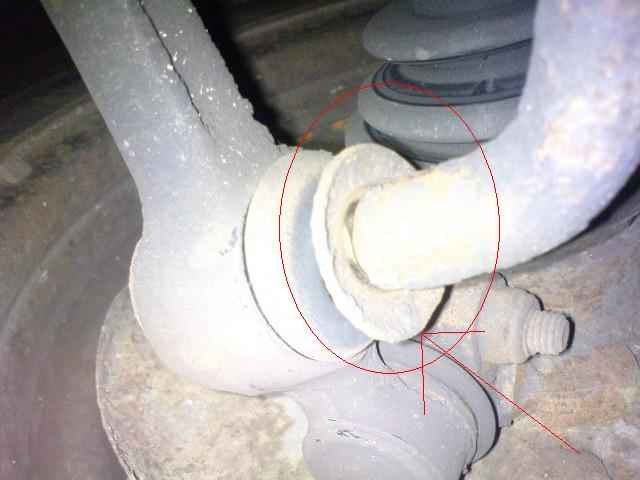

Mk3 Violently pulling to the right
There's no nut there, it seems to be fixed in place but is loose enough to rotate. Will get onto some new TCA's and polybushes...
theres you problem, there needs to be a 19mm nut on the other side, fixing the ARB "up tight" against the TCA. put a nut on, do it up, and should be all goooooood.
