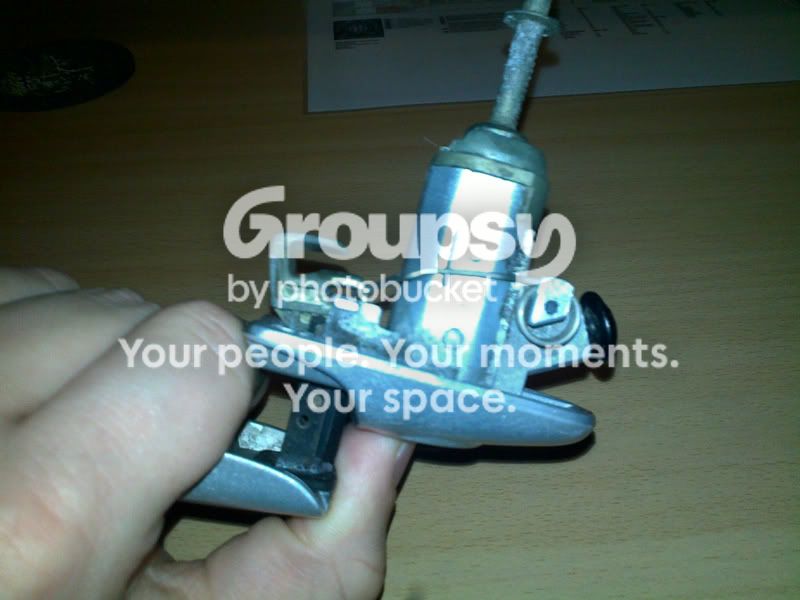

No no no, you take the handle off. There's a torx screw on the inner side holding it on. Unscrew that, push to the front a bit and then pull it out. The following pictures are with a 6n2 handle that I have lying around :p.
so you have your handle out, you are faced with this:
So first thing's first, lets unhook the two parts:
Pull down:
and out:
Why do we need to do that? Because otherwise you can't get to this bit:
and the other bit on the top side. you can't get the paint all the way around.
Next, mask up the following bits, don't forget to take the rubber gasket/contact plates, you don't want to paint those, also, use masking tape to secure the hook into that position, otherwise the top end will slide back.:
you can do the sanding down and wiping off before or after the masking, as you wish. I suggest that you somehow suspend the handle in the air. I used some stiff, thick gardening wire we had lying around and had it hanging from some wood planks that were on top of our shed. After that, just paint as said before(do not flatten the paint, as you will just need to put on a new coat. don't worry if it's a bit matt, the clearcoat will give it the deep shine, JUST DON'T TOUCH IT WITH SANDPAPER) and clearcoat it. Do at least five coats of clearcoat. Don't rush it, don't put it on too thick or you'll have to wait a day and then sand it down and start again. Five coats is due to the relative ammount of battering this part will recieve, it's better to have one more than one too little.
And before you put the spring back where it needs to be, mask this bit up, or put something soft there, otherwise you WILL chip the paint and you will want to shoot yourself.:
that's about it.
