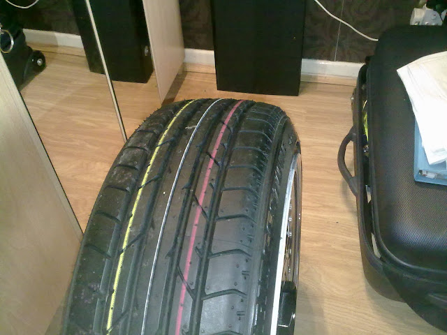

was just thinking about the wheels i want to put on my polo next and i have a set of 15x7 e30 OZs that are running 165/50/15s so got a nice bit of dstretch :-)
My problem is, i like driving fast and hard, particularly on bends, and was debating wether or not stretched was a safe option? :?
so could anyone just kinda explain exactly how safe stretcg is, like, at speed and hard cornering etc etc
