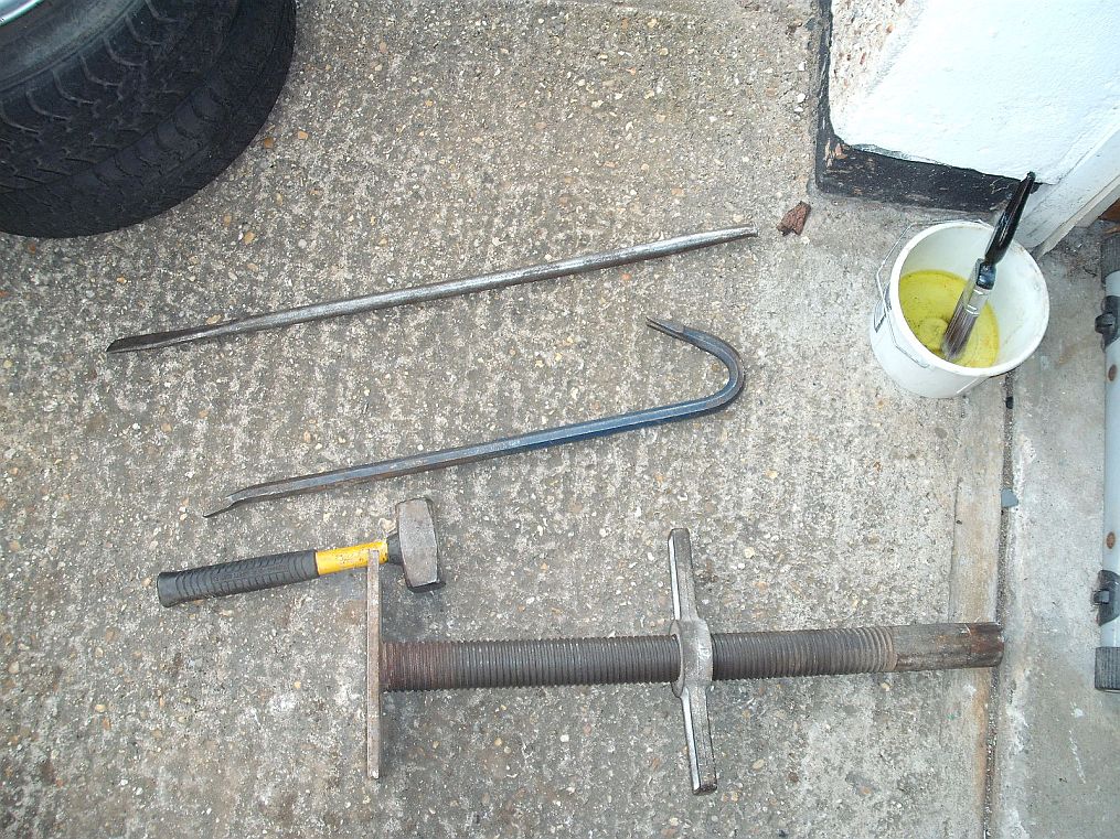

i made my own tyre bead breaker from a acrow prop and a cut down tyre lever . works a treat :-)
heres my tyre changine set
it just so happens that me, being a bit of a gypo has an almost identical acrow pop sat on ones yard doing note. and big bars and hammers...well nuff said! :lol: please can you give me a bit of a how to do it on your kit point me in right direction!

i wasnt quite sure how the prop came into it but makes sense now. you obviously know what your doing so it makes it look pretty easy but i reckon i can manage that easy enough! out of interest though have you done it on alloys, wondering if they could get damaged if your not careful?

yes i have done alloys put a carpet tile down first,so you dont damage the face just go steady,
look where you put the tyre lever in the last stage so you dont do any damage :-D
