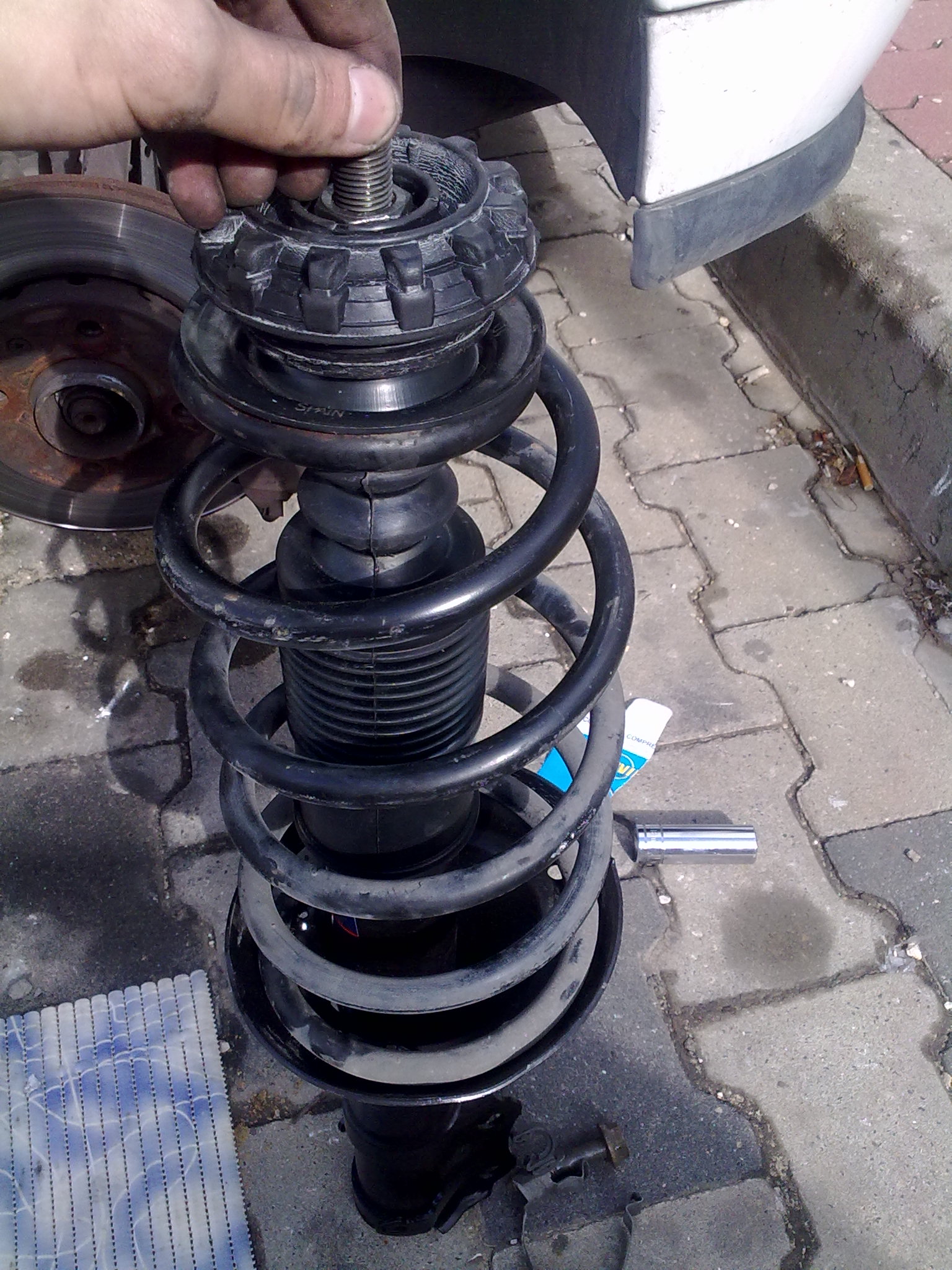

What are the springs like? top mounts?
Coilovers would make it much worse surely?
Yes the strut mounts are on top of the strut:

Whats the general condidtion of the springs?
Changing the seats will make fuck all difference.
How can I know there condition? they look ok :?
when I drive I feel like the suspension does not do it's job well, it does work but looks like it does not contract enough.
well if they look ok there fine, before i put uprated springs and shocks on my mk3..the rear springs were in two bits!
No wonder it was a shocking ride :lol:
thats all am getting at. If there broken or damaged.
