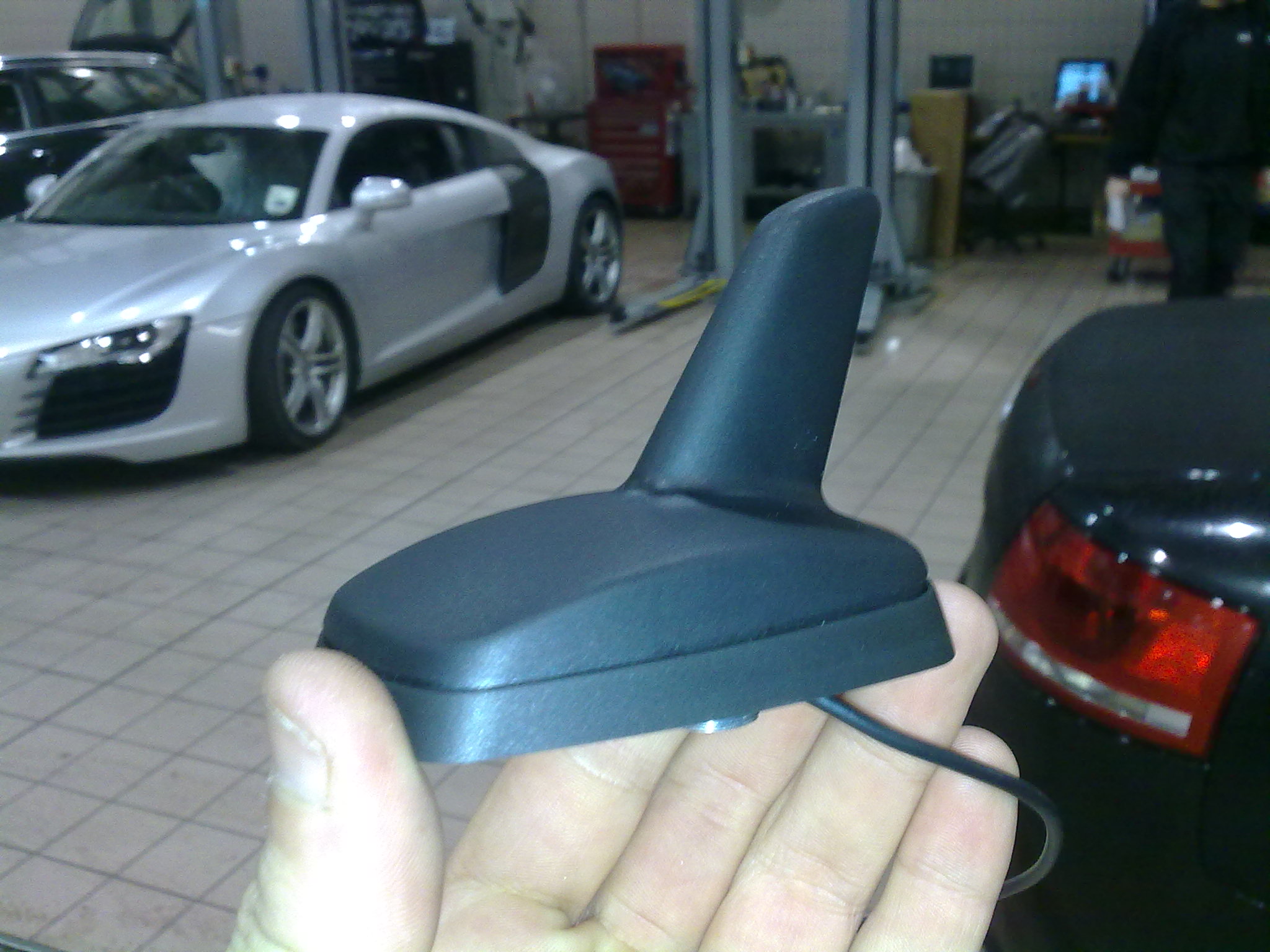

I've heard quite alot about doing this conversion to get rid of that nasty looking, really stupidly long aerial, and seen as i work for a VAG group, i went ahead and ordered a Shark Fin aerial from a MK5 Golf to fit on ma 6N2 Polo.
The fitment is perfect, sits flush and everything, but the cable connectors are different. The golf is of the new type aerial leads and the polo is of the old type, does anyone know of any after market adaptors to help me out, because ETKA can list any adaptors at all.

Here is the actual aerial

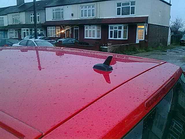

Here is a pic of it fitted, so much smaller, wondering if i should paint it! Yes or No? bare in mind, red car, black VW badges, soon to be black rims and GTI grills.
(not the best picture)

I'd colour code it, keep that lil black rim. Alternatively you could leave it black and do your wing mirrors in gloss black to help the colour scheme
The black bit at the bottom has to be kept black, its a rubber seal to stop water coming into your car. And if you wanted to do wing mirrors, best to do matt black as the aerial comes in a plastic matt black finish as standard!

I'd get it colour coded for sure just remove the black rubber grommet then re fit it after it's been sprayed.Looks better as if you don't get a perfect colour match the two colours are broken up.
