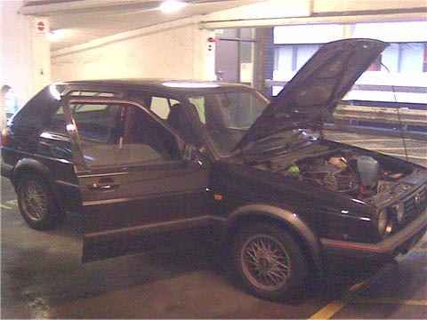

I got it with a few problems but nothing that could not be fixed
1. Electrics Clocks did not work brake lights had blown:
2. Broken earth strap from bonnet to car:
2. Running problem link to electrically problem:
Replaced earth strap and check fuses all the fuses where wrong. Especially the fuel was a 20 amp not 30 so the fuel pump was not working right this why the guy had the idle turned all the way up now running sweet.

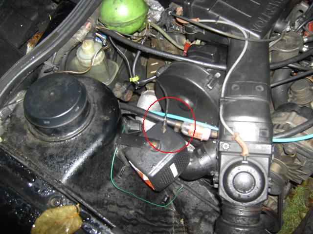

Tonight hopefully sort the idle problem it was turned up to the max with the fuel problem.
only thing now these a black wire not connect to anything near the bulk head single black can reach the carb but doesn't seem to attach to anything
however when place on the manifold the fan start it very strange
Can you get a picture up of where this black wire is? There should be an earth wire going to the block on the gearbox side, look for a crimp under a rocker cover nut that is missing a wire.

This is the Wire in question it does not go that far and even when the ignition is off the fan come on if, the wire touches the manifold.
