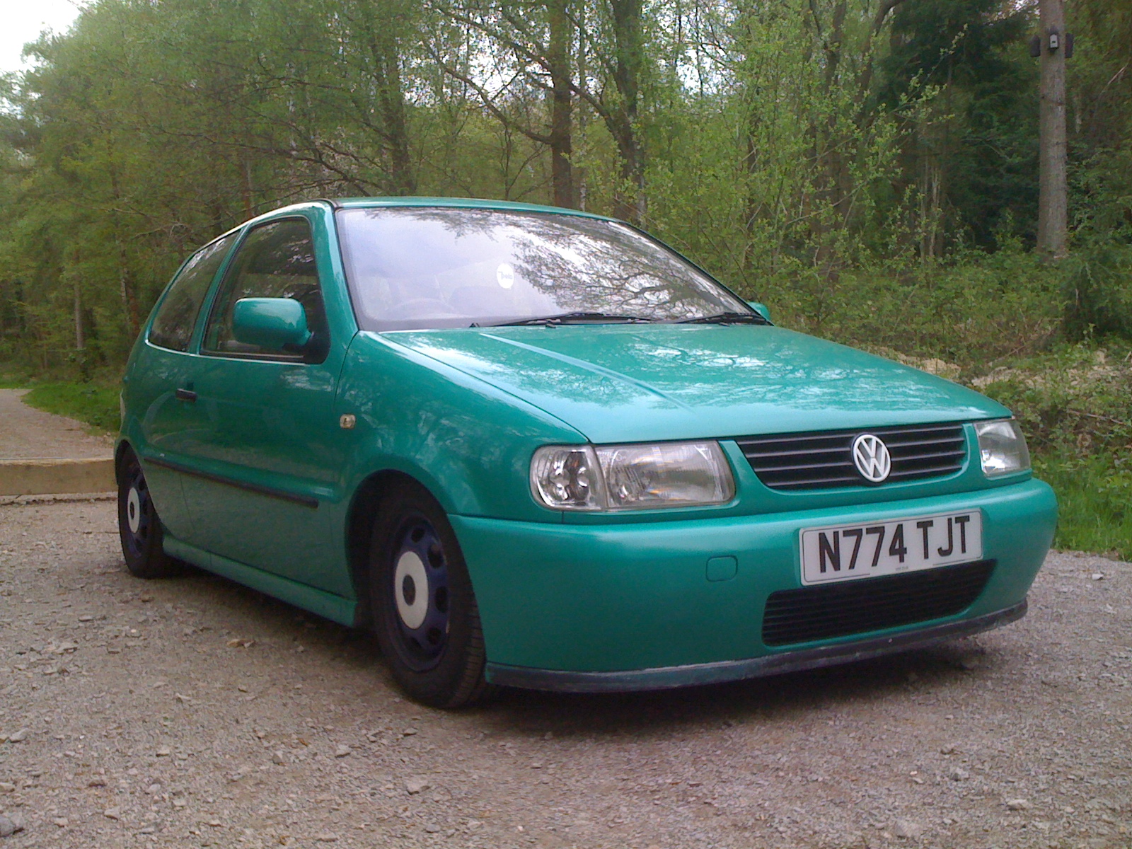

Pistachio 6n transforming into white 6n gti
Model: 6n
Engine: 1043cc
Suspension: TA coilies
Brakes: Standard
Wheels and Tyres: Lenso bsx 15x7 wrapped in sportcat 195/45
Exterior Styling: smooth 16v front bumper, de bump stripped, heko wind deflectors, crystal indies, valver rear lights rear bumper awaiting paint. :)
Interior Styling: Purple Fluffy Roof Lining, Stubby gear stick with momo shifter, White center console, valver interior :)
ICE and Security: JVC Headunit, Alpine E type door speakers and rear speakers, JBL 1000 watt sub

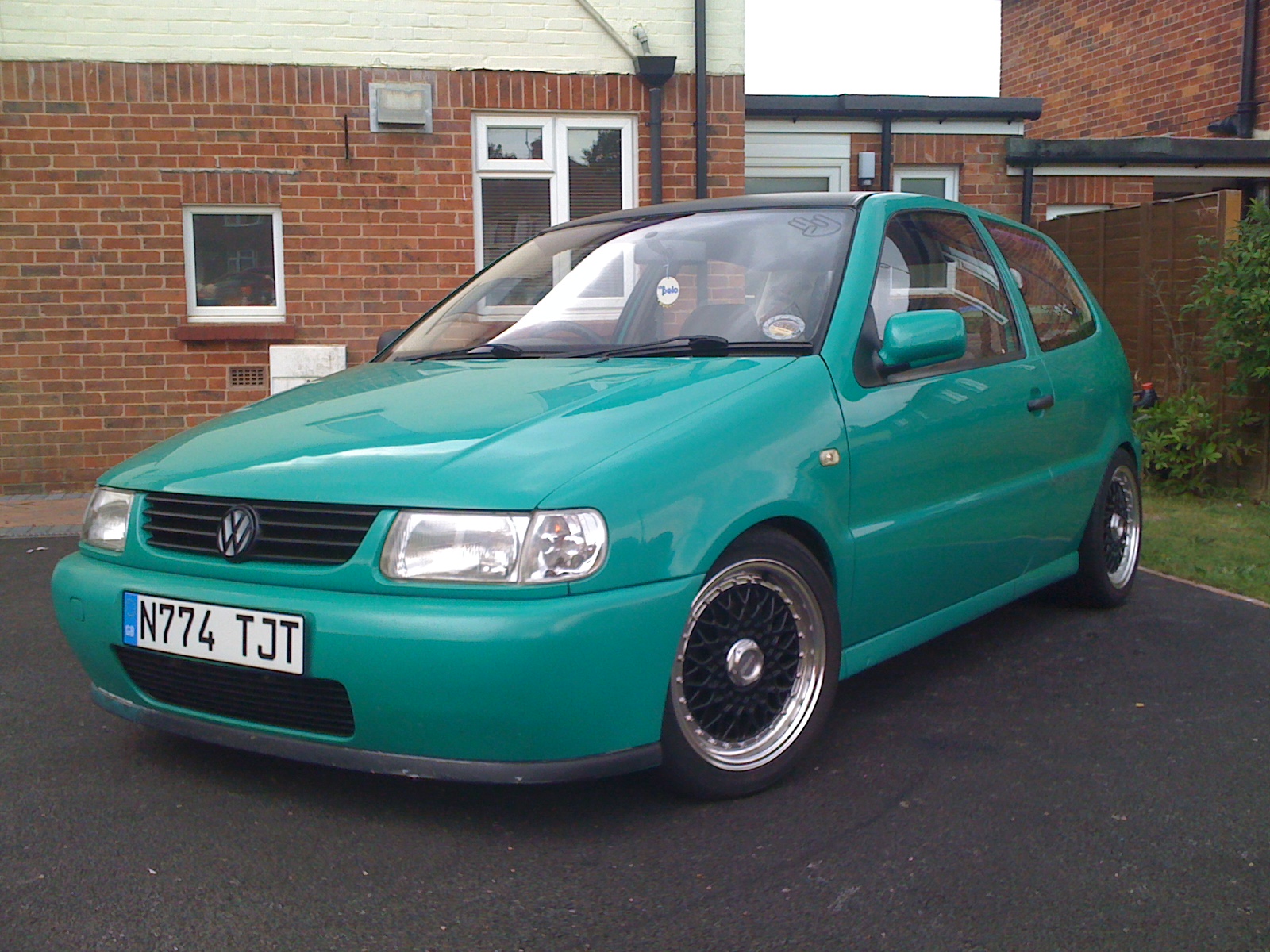

new wheels :)
bump strips coming off soon, matt black roof and carbon fuel cap and mirrors done tomorrow aswell :)

i think they are bbs :thumbsup:
i think they lenso bsx am i right ??
Not got the VR6 engine in yet then? :lol:
Lenso bsx 15 x 7.5

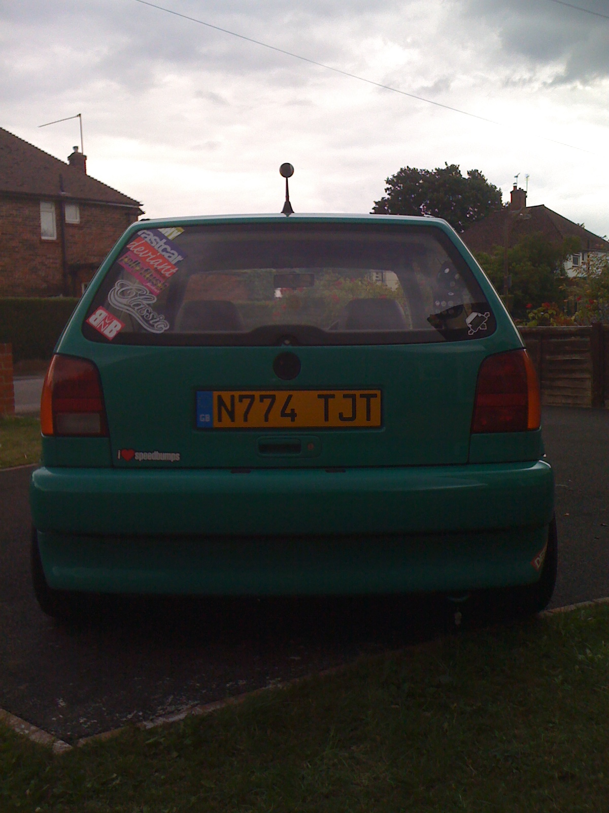

Right quick update for today;
wrapped my roof in matt black (myself)
started doing the mirrors in carbon fibre
fuel cap is done in carbon but forgot to take a picture
new number plates
two tone front badge
bump strips have gone
oh and there are quite a few stickers been put on and some little pikey stole my rear badge!

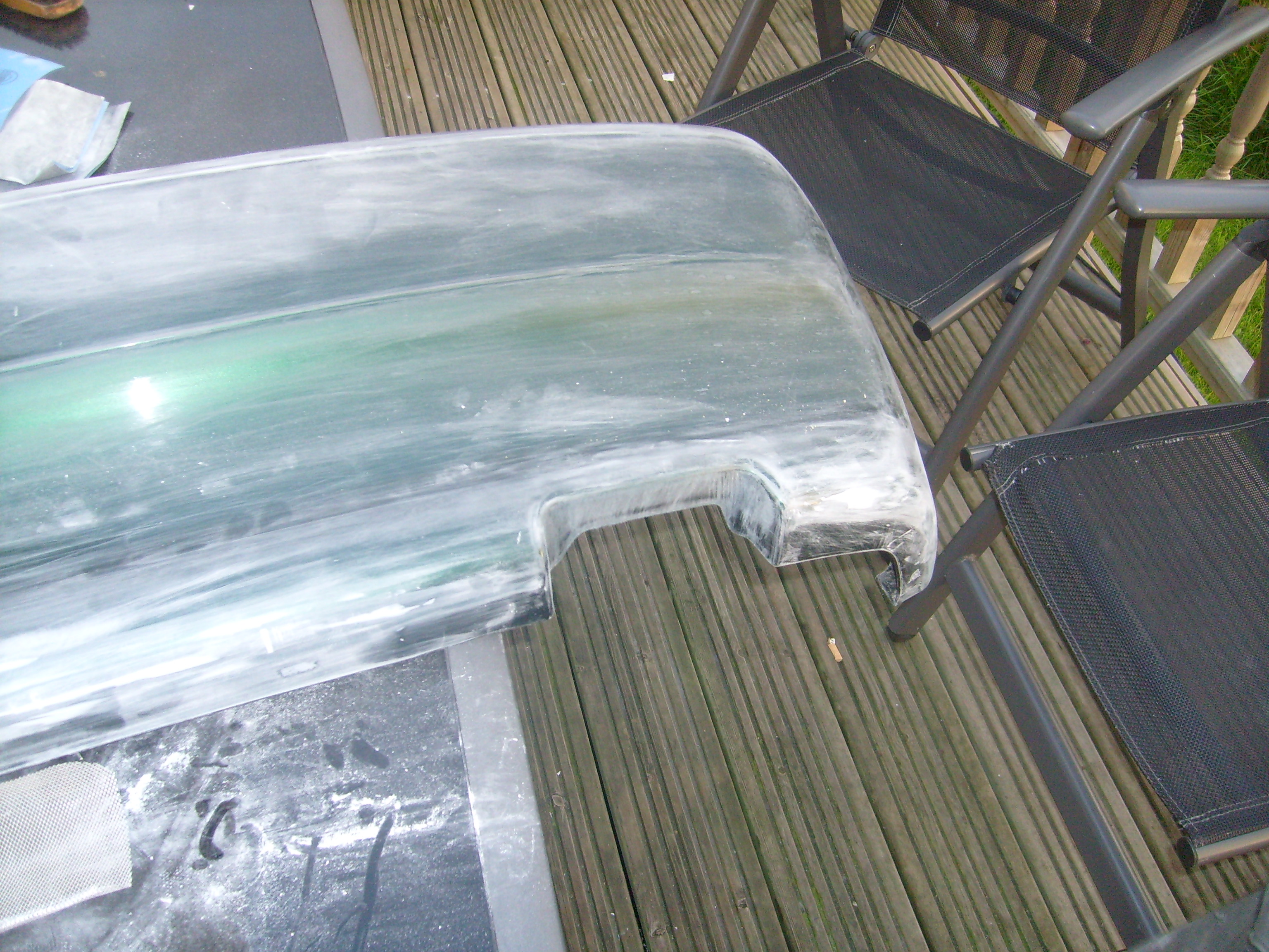

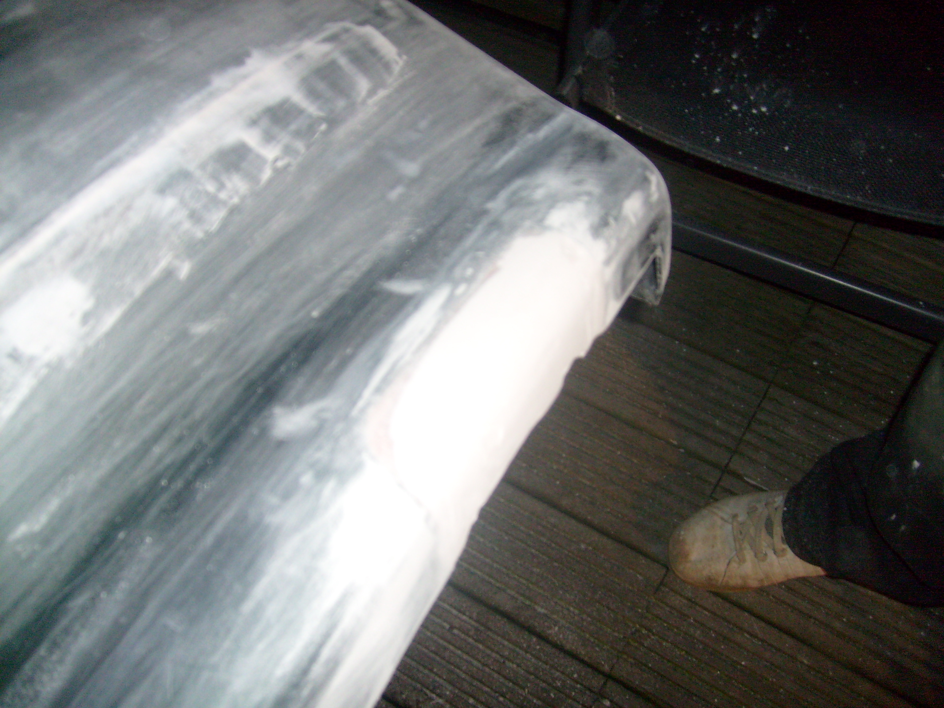

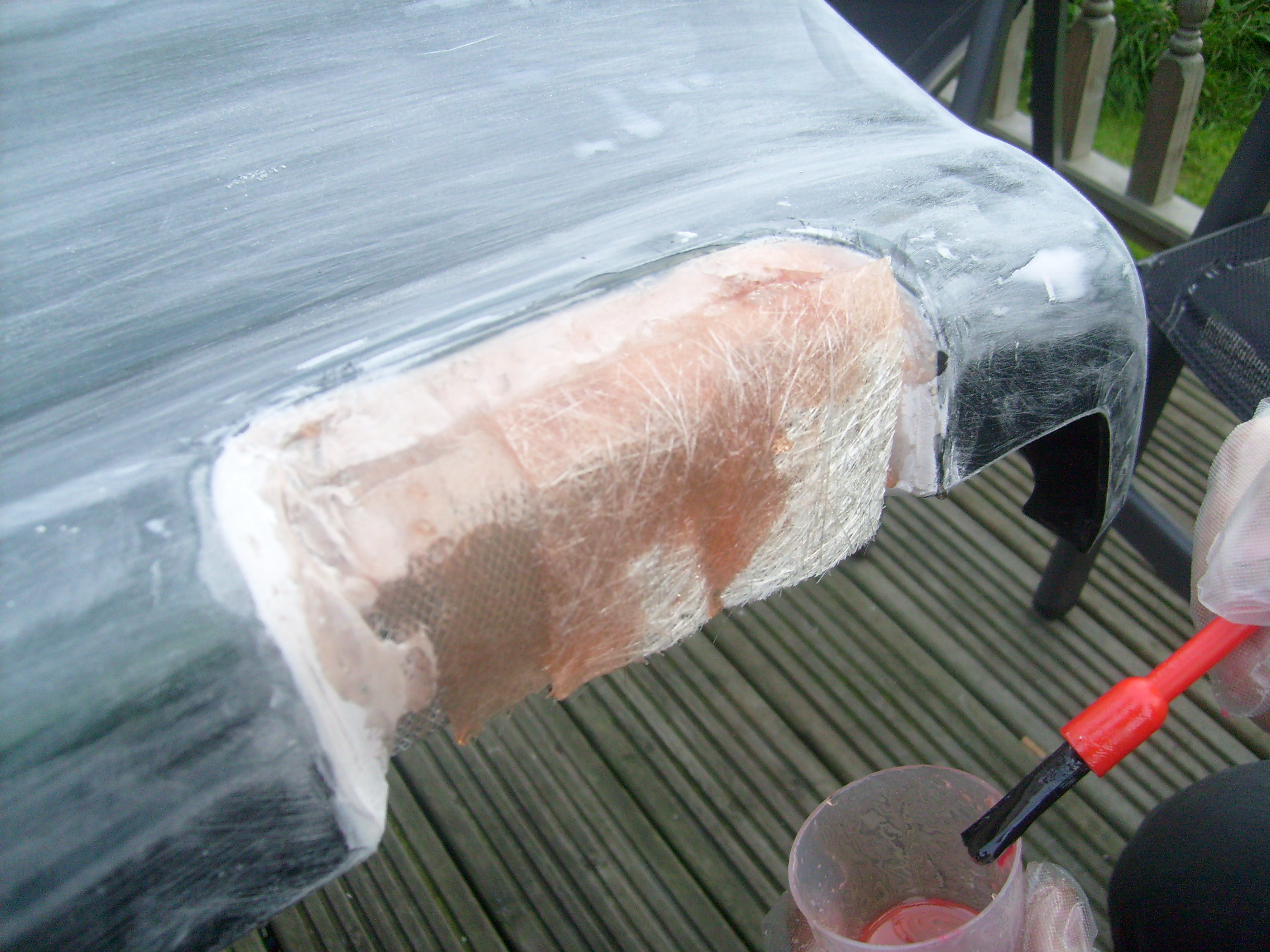

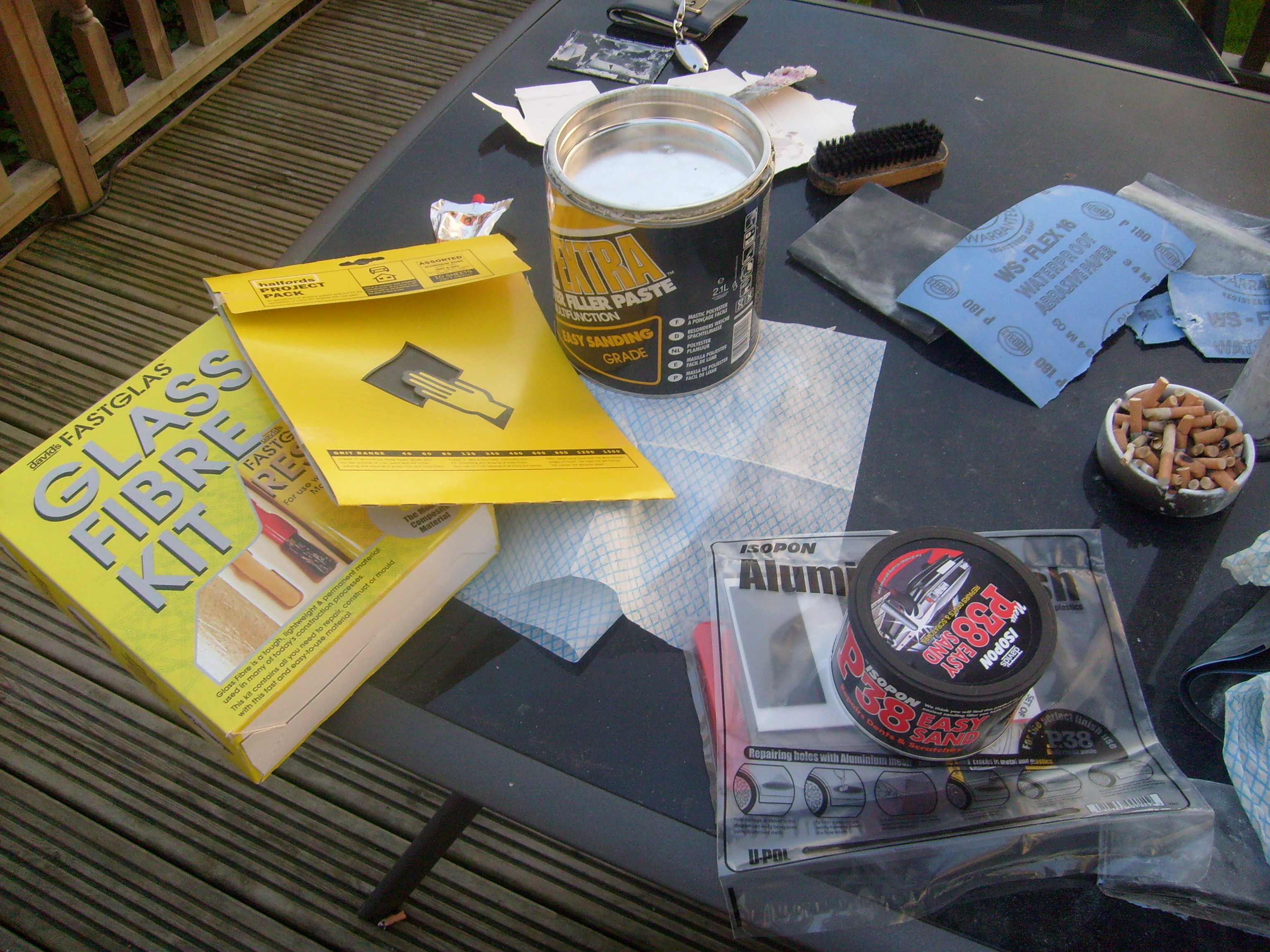

Okay little bit of progress... new 16v rear smoothing in process. pictures to follow
Get cheap valver bumper
buy crap from halfrauds
put mesh body filler and fibreglass on
sand flush
Paint when i get more funds :)
Also... adjust rake...
oh and ask lovely people that can use photoshop to make my car look like a dream...

how did you do the roof? looks the nuts. what did you use? You say wrapped it so its cloth or something?
vinyl wrap buddy, its matt black vinyl
alright ben,
did u do the roof yourself? I heard its a right bastard to get right! Looks spot on.
Car looks good, could do with 5 mm more down at the front though :D
You used p38 on your bumper? A word of warning p38 doesnt flex and with the bumper being plastic it can crack after its painted i learnt the hard way when i smoothed my front bumper with fibreglass and p38. I now used 3m plastic finishing putty.
thats a good point ^^
