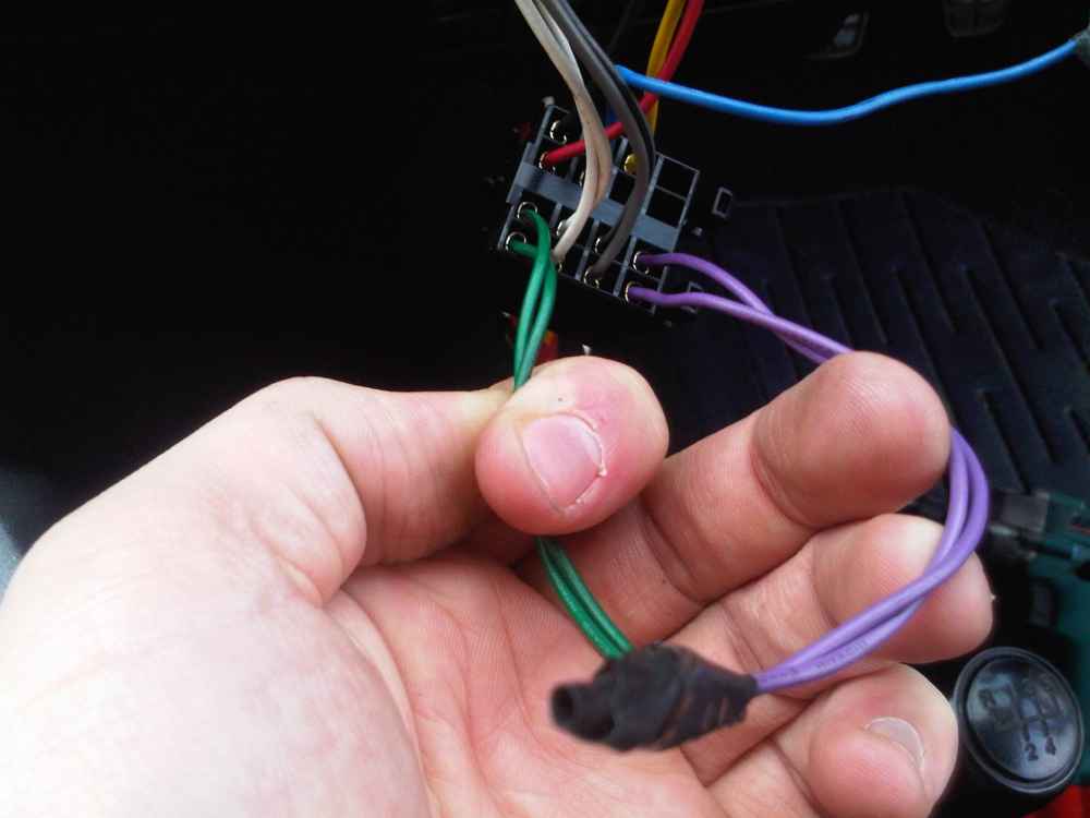

I know that the two middle sets of wires on the pic below are the front speakers. I'm guessing the outer ones that are unattached are the rear speakers?
I'm due to fit some this week and need to know so i wire off the correct bits. :)

there the ones mate :thumbsup:
Awesome! Thanks very much buddy!
yeah it should say it on the wire
Edited by flownerdia
green=rear left speaker +
green/black =rear left speaker -
purple = rear right speaker +
purple/black = rear right speaker -
