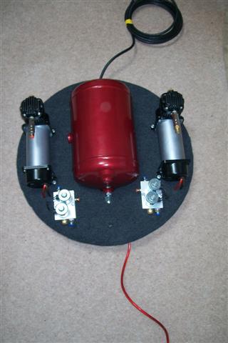

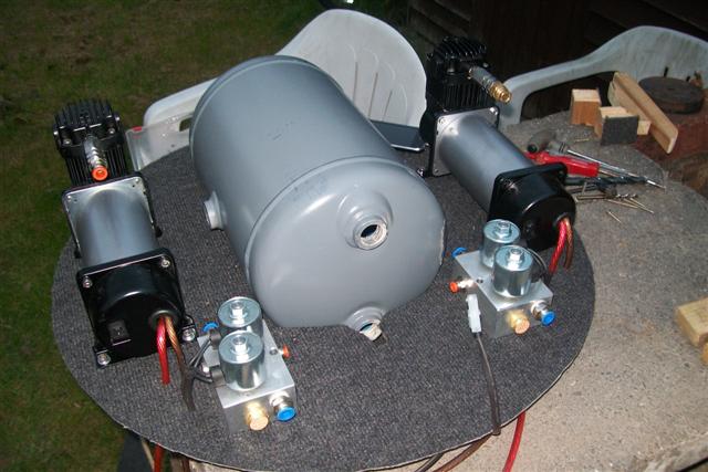

i started off with a tank, 2compressors, 2 mnaifold valves and pipes and a water trap.
all of this is not easy to get in a boot neatly so heres my attempt!

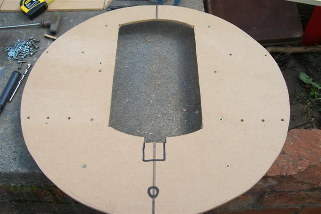

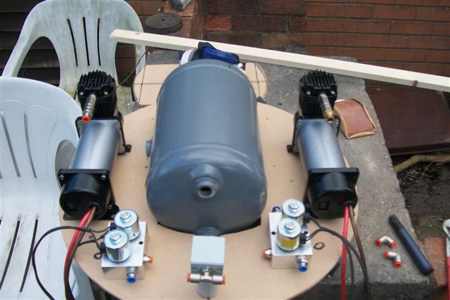

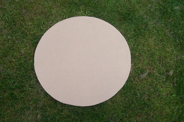

started off cutting out a circle from 6mm thick mdf

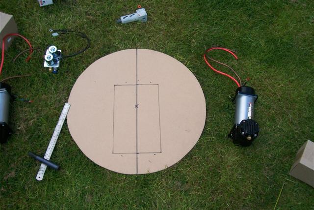

marked out where bits are going to live (how messy is that photo lol)

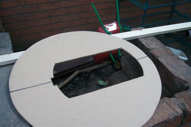

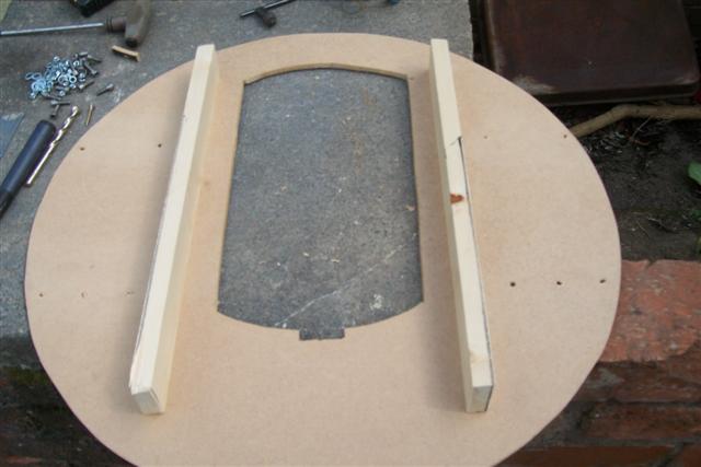

cut a hole out of the centre for the tank to sit in.
marked out more holes and put a couple of mounting blocks underneath

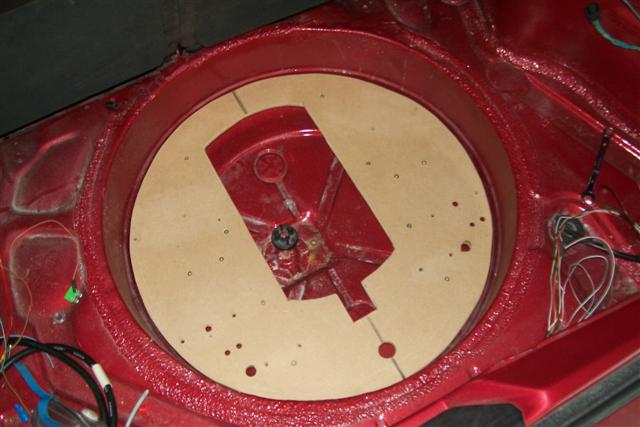

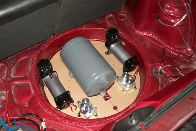

So here is the first mock up

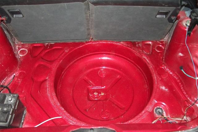

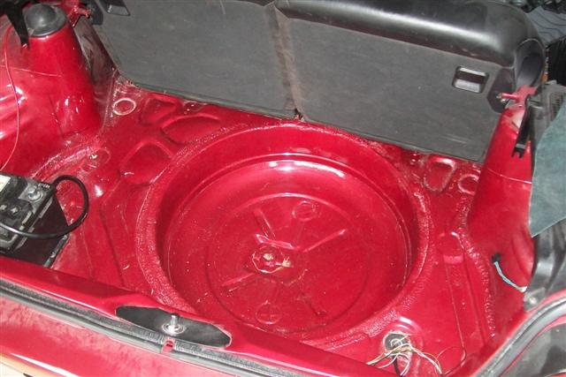

and the boot space i have decided it will live in

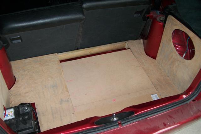

so a quick fit reveals it will sit like this

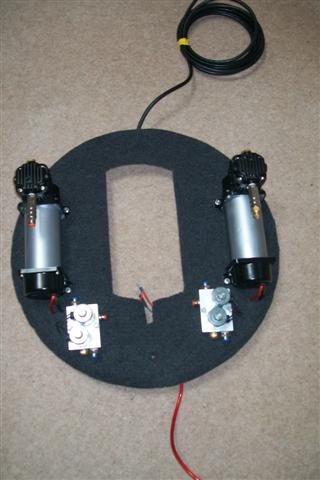

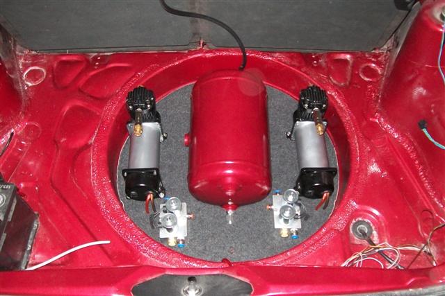

a bit of carpet and some wire tidying ended up like this

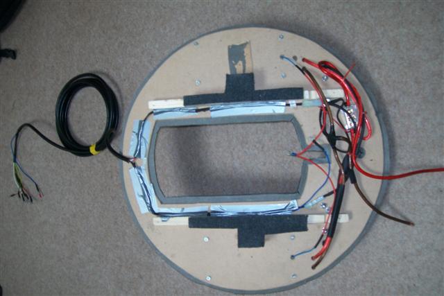

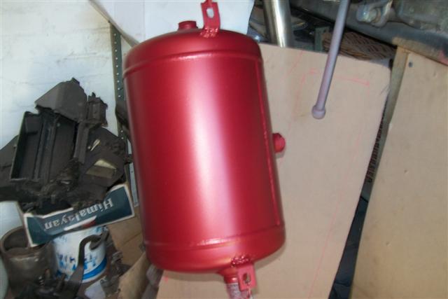

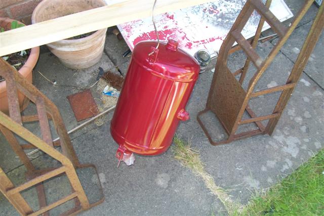

i colour coded the tank

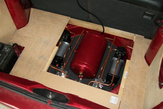

a then fitted all the wires and the parts were taped up

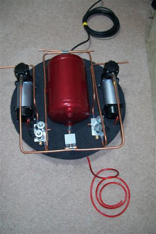

the pipes above will be bent to the finished shape after the floor goes in.
and the finished product

tank was 50, the compressors were about the same mate and the valves were 85each.
yer the porkers are 15x7 and 15x8

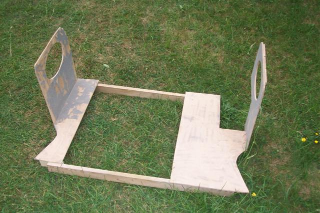

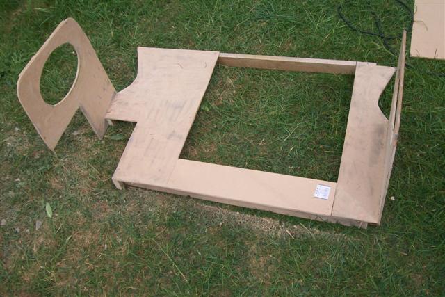

heres what I've been up to anyway - made a frame to raise the boot up to clear the compressors.
also want to hide a few things so i am making a box around where the battery lives aswell.
i had already started on a similar idea before the airride so some of my wood is recycled - so dont bitch about the wood lol

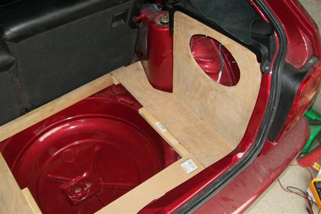

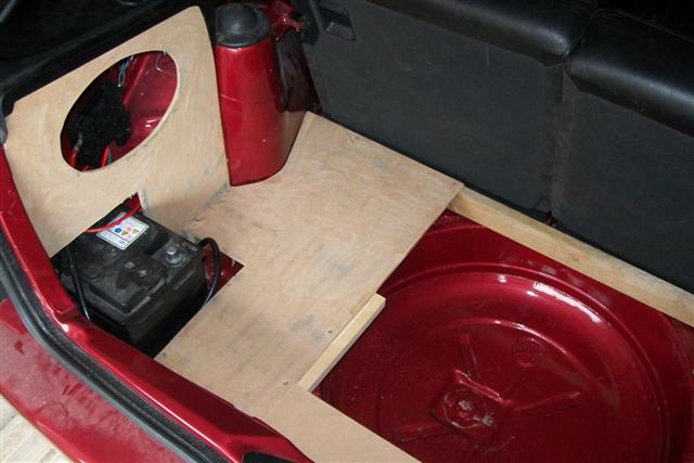

heres the boot
trial fits
and with some of the parts in the wheel well. (not connected up yet)
