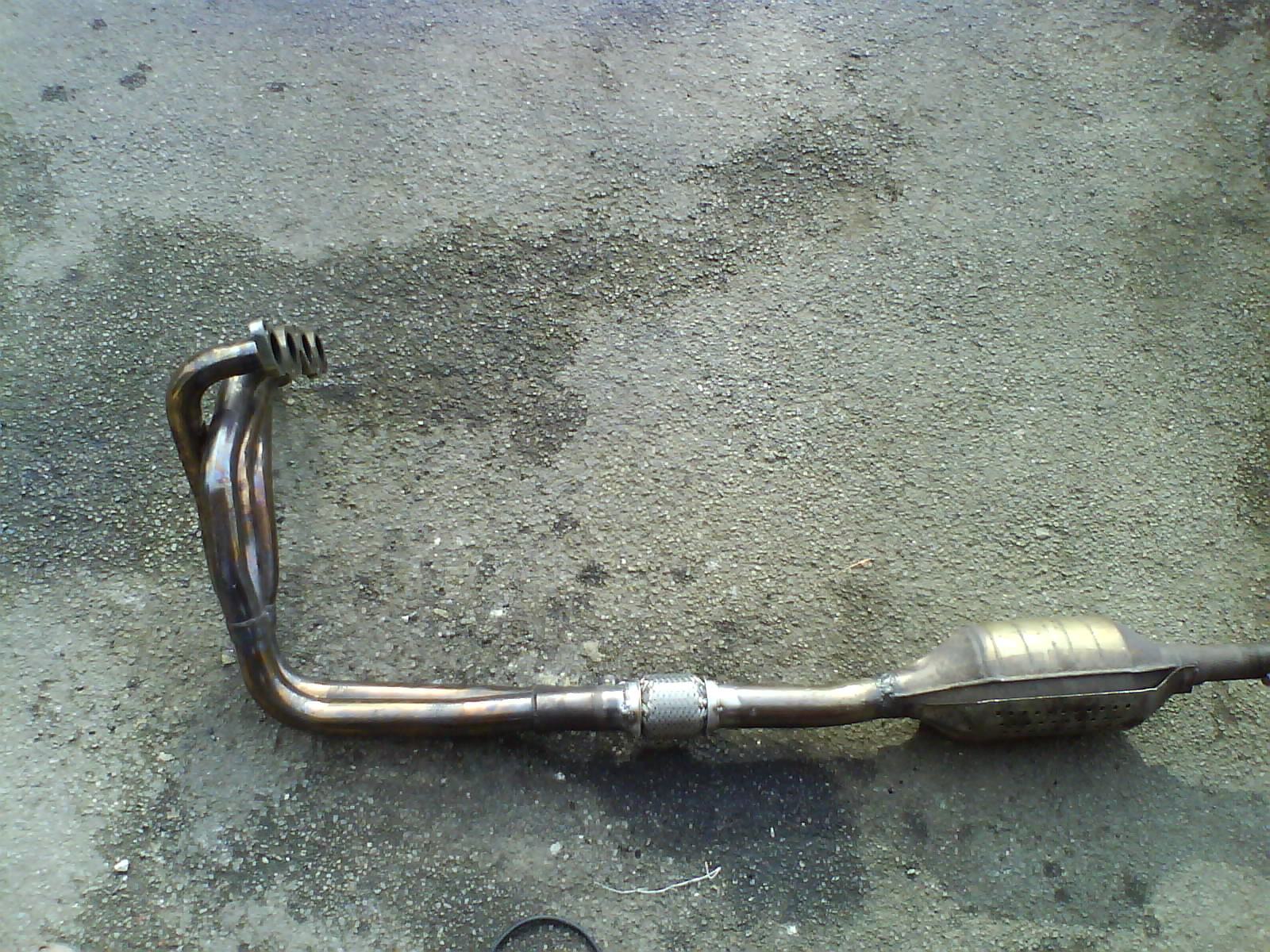

ok so heres my concoktion!
just needs welding up then fitting!!

finished!
just need to get a clamp then its ready for fitting tomorrow evening touch wood!

Ok well I have "fitted" the 4 branch! I nackered the lambda! (wouldn't even comeout with heat so I man handled the idiot and stripped the threads of inside!) so I had to get one and I could only get one from a 1.3 aer (mines an aex how much difference will it make??? Will be rectified shortly!
Also for peoples future refference downpipe diameter before and after the cat is 45mm not 43 this caused some problems with my design (the reducers smallest size was 45mm which I thought would have been just enough to fit over the oe pipe work! But it was the same! but wasn't hard to sort
it's rattling on the heat shields like mad stood still because the mani/ cat joint needs shortening, I will recify that aswell if I'm honnest it was a bit of a ball ache
With regards to wiring the lambda it took 3x the oe lenght! I ran this round the back of the engine (right hand side where plug is located and used the loom trunking to house it! Then it drops straight down onto to mani and screws in
