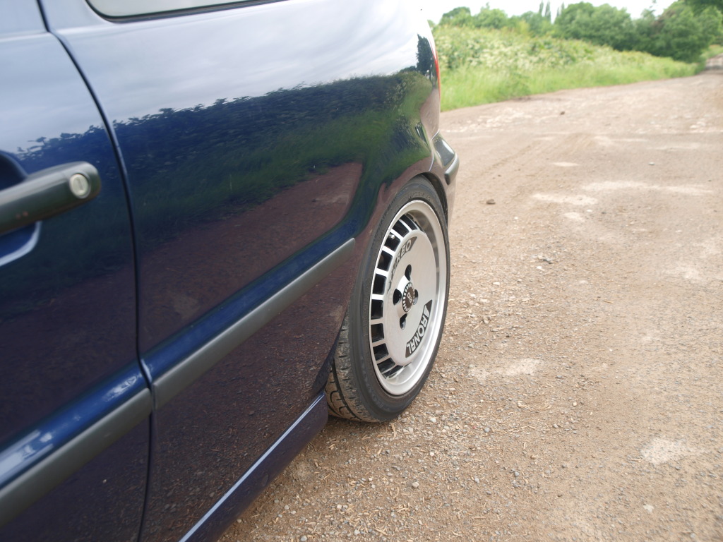

i got my polo 6n2 on 15" Ronal R10 Turbos (realise this is too big-will get to that). It's also on coilovers wound all down 120mm @ the front and around 115mm at the back.
I have already ruined a set of tyres from scrubbing on the arches.
Basically the gap in the arch is minimal but the height still isn't as low as i want it.
every time i ask people about it i just get "get smaller wheels", not sure if I'm right about this but if you get smaller wheels and smaller tyres or stretch tyres you're making the overall wheel size smaller and i thought that wasn't any good for your gearing etc.
PLEASE HELP.
have also attached 2 pics of how low it is on the arch @tm so that you can see what I'm talking about but put it this way i can JUST squeze my car car between the arch and the tyre. :L

for starters you are no where near -120mm mate. I take it you haven't removed the helper springs?
You would probably get away with rolling them and triming the plastic lip back, but if the plastic was rubbing on your tire it would ware down long before it could do any damage to the tire. So unless there are chunks missing from the plastic i wouldn't worry about that unless you wanted to tidy it up so it matched the rolled lip.

are all your arch's standard? No rolled lips or owt?

Well if it was catching on the back half of the arch or even the inside of the metal part ie the plastic mud guard then this would also cause the plasic to wear down quicker than the tyre wall. You can still roll 6n2 arches dude, take it to a decent body shop and they shouldnt have any problems with it.
One option you do have is running a little negative camber on the rear using camber shims. Saving that just smaller profile tyres, what tyres you go on there at the moment?

right, next- what the side-wall is scraping on- because its a wide wheel, and the tyre goes under the arch where the tyre gets wider the side-wall scraps on the metal part of the arch i.e. the lip on the body panel, it only really scraps the plastic mud guards when it bounces.

by saying it's only scraping the plastic mud guard, by this do you mean the plastic cover inside the arch? If so you can remove that altogether mate.
I've never seen a 6n2 arch in any detail but i can't see it being much different to a 6n as its just a facelift version of the same car? and i've seen loads of them with rolled arches. You only need to roll flat the little metal lip that the plastic guard sits on

Right, more photos to help solve the situation.. afraid i havnt got a side on on- sorry it's too dark now and i cant be asked to put my ronals back on just for a photo.
Here's another photo that may help. You can see a few things from the photo. It's the passenger side rear wheel looking forward towards the front. From the pic you should be able to see- The bit of the arch that scrapes the side-wall, the strain being put on the side-wall of the tyre, where the arch panels are split (closer panel is the rear bumper) and lastly how small that gap is between the tyre and the arch. :lol:
