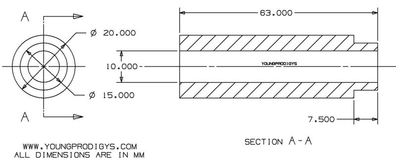

KiZ
do you want the dimensions? so you can make them yourself?
Share this post
Link to post
Share on other sites
Cymro
Youngprodigy: is that the dimensions for the sleeves or cables?
Share this post
Link to post
KiZ
the sleeves so you can use your old cables
just mocked this up on the cad
Edited by youngprodigys
Share this post
Link to post
vdub_pete
Bloddy hell mate thats fricken ideal cheers dude i can take this down the machine shop and get them 2 make it up woop! woop! rear disc convertion here i come :lol:
